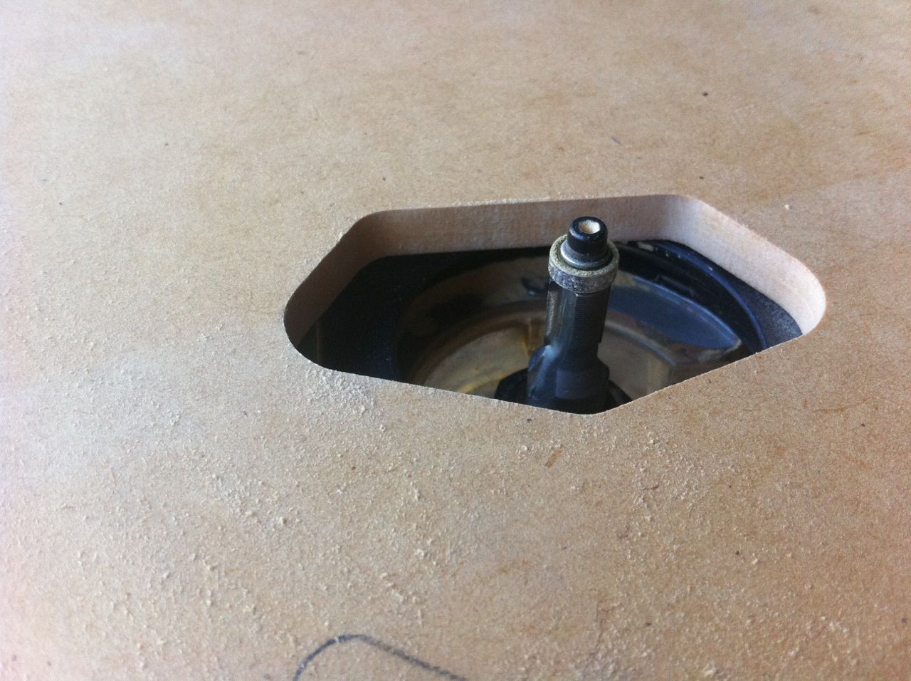

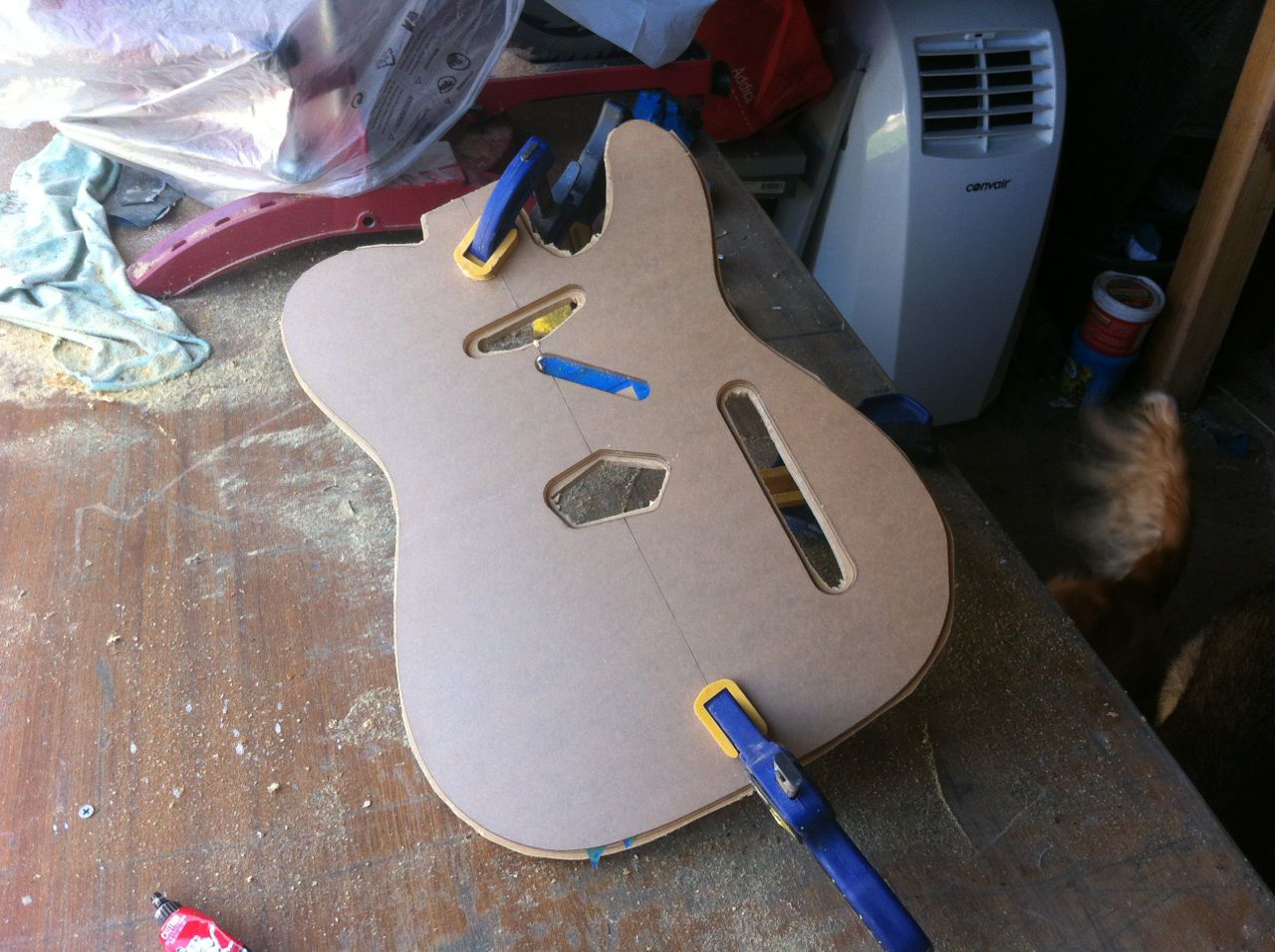

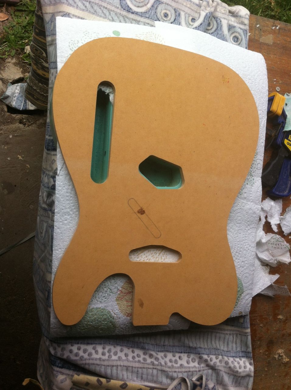

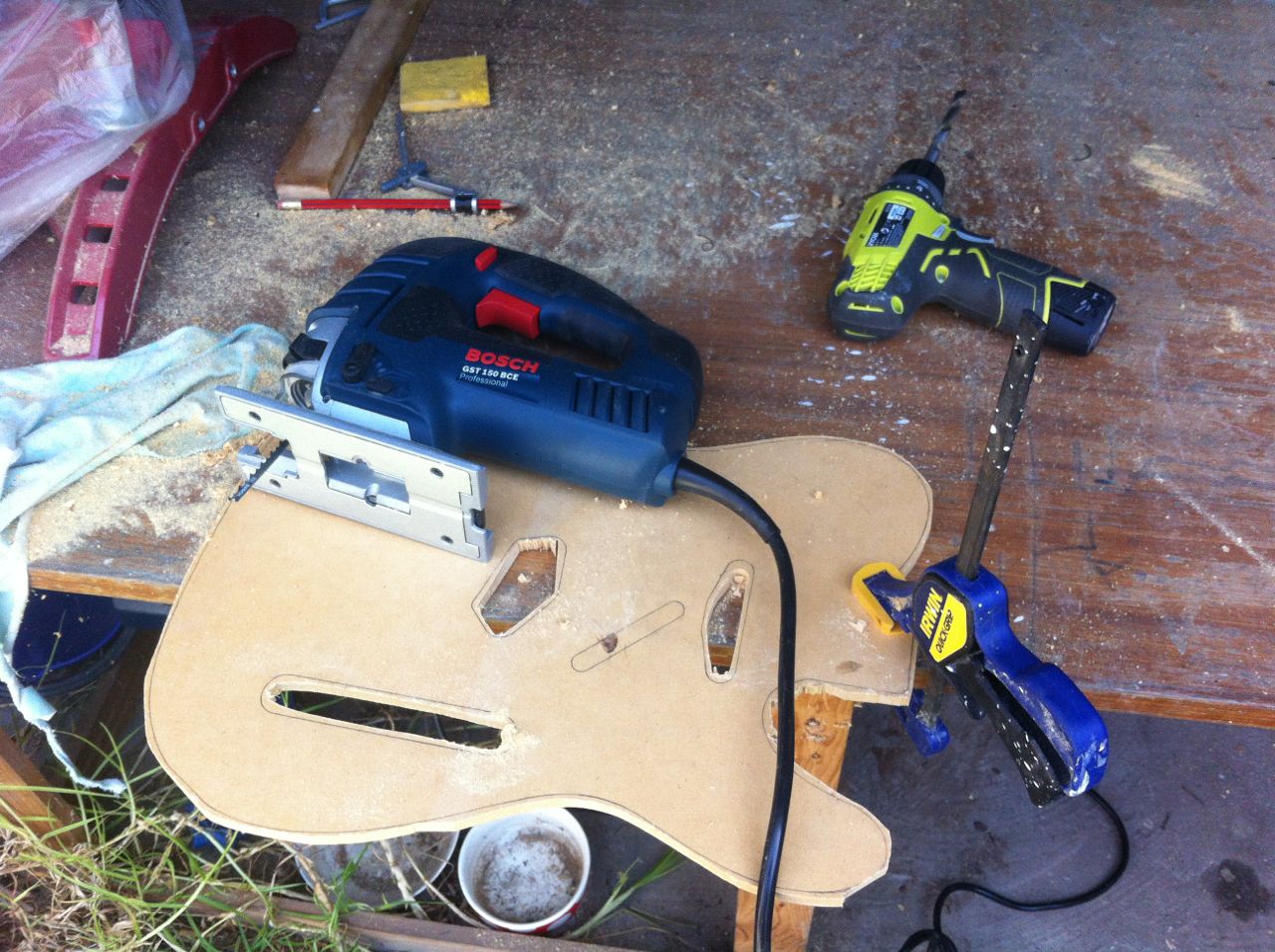

    Bit of an update. Have made a wooden copy of the plastic template pablo sent me recently. I didn't have any double sided tape so i used a trick I saw on Crimson guitars where Ben puts masking tape down then uses super glue to smear on the two opposing pieces. This worked really well and I was able to easily remove the templates from each other without any glue getting on them.
ID:	6007   Click image for larger version.
ID:	6009   Click image for larger version.
ID:	6008   Click image for larger version.
    A few more.
ID:	6011   Click image for larger version.

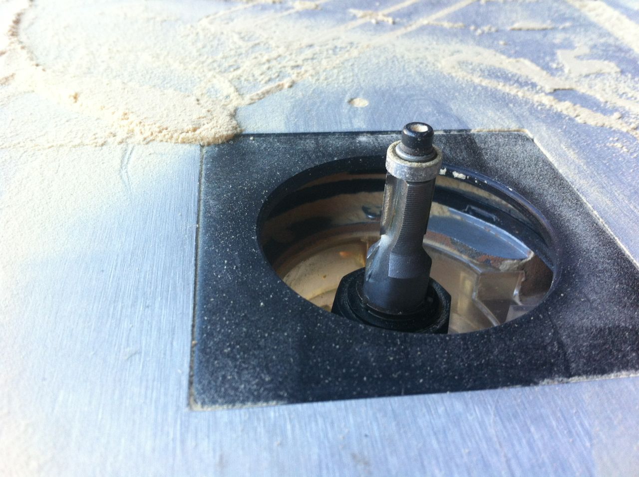

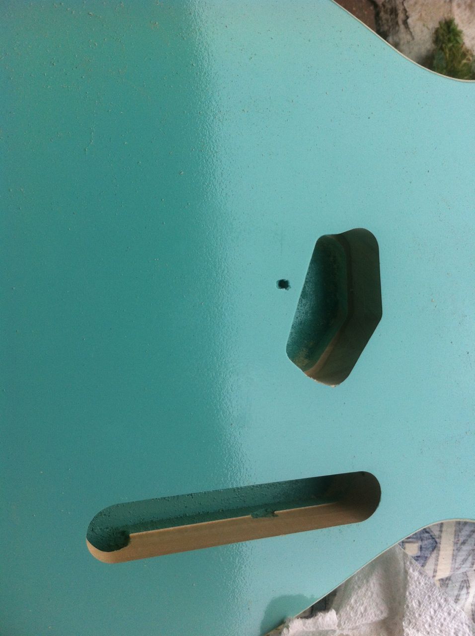

    I then set about routing the bridge pickup and control panel slightly larger to fit the cts pots and tonerider pups I plan to use.
ID:	6014   Click image for larger version.

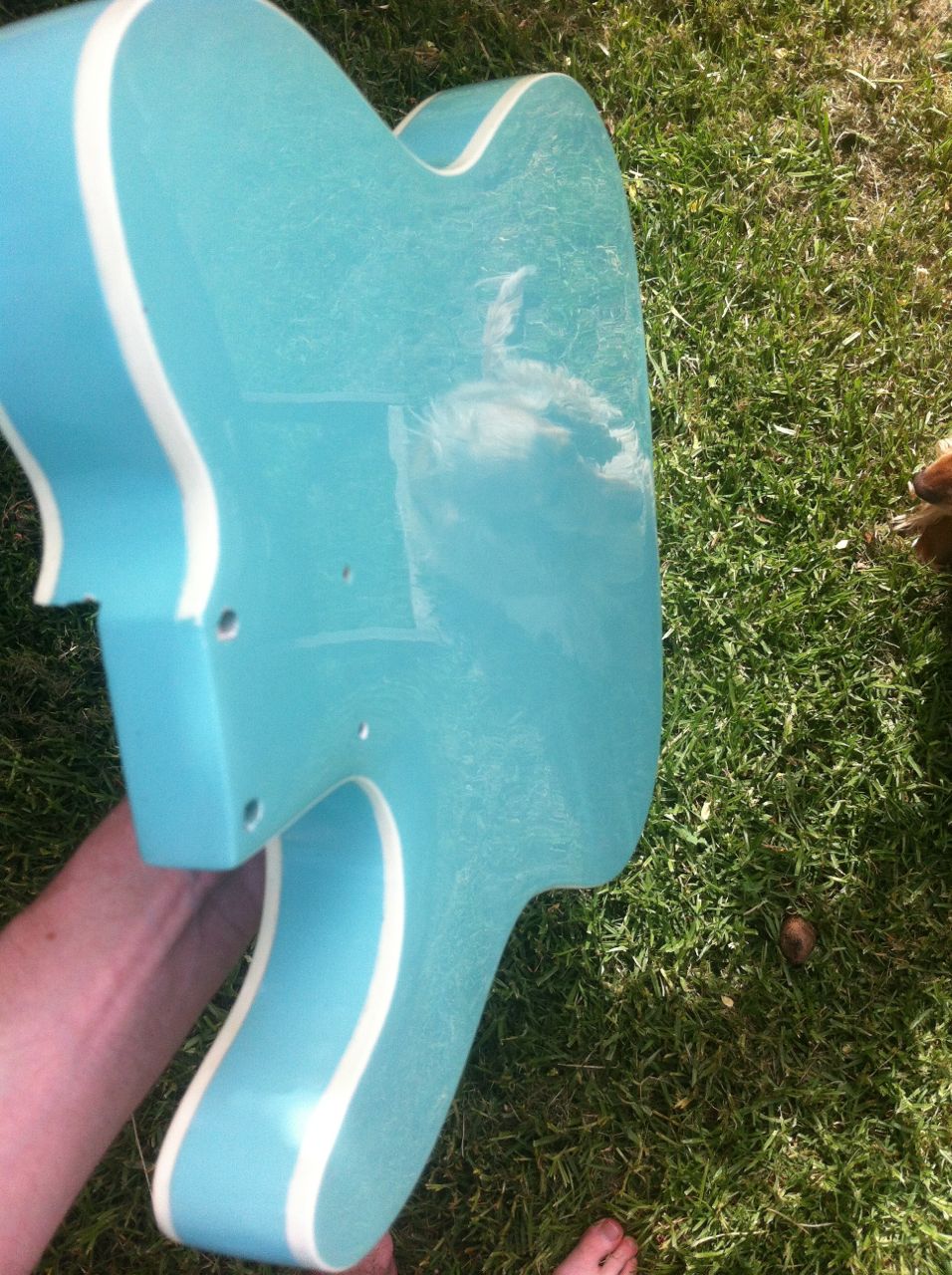

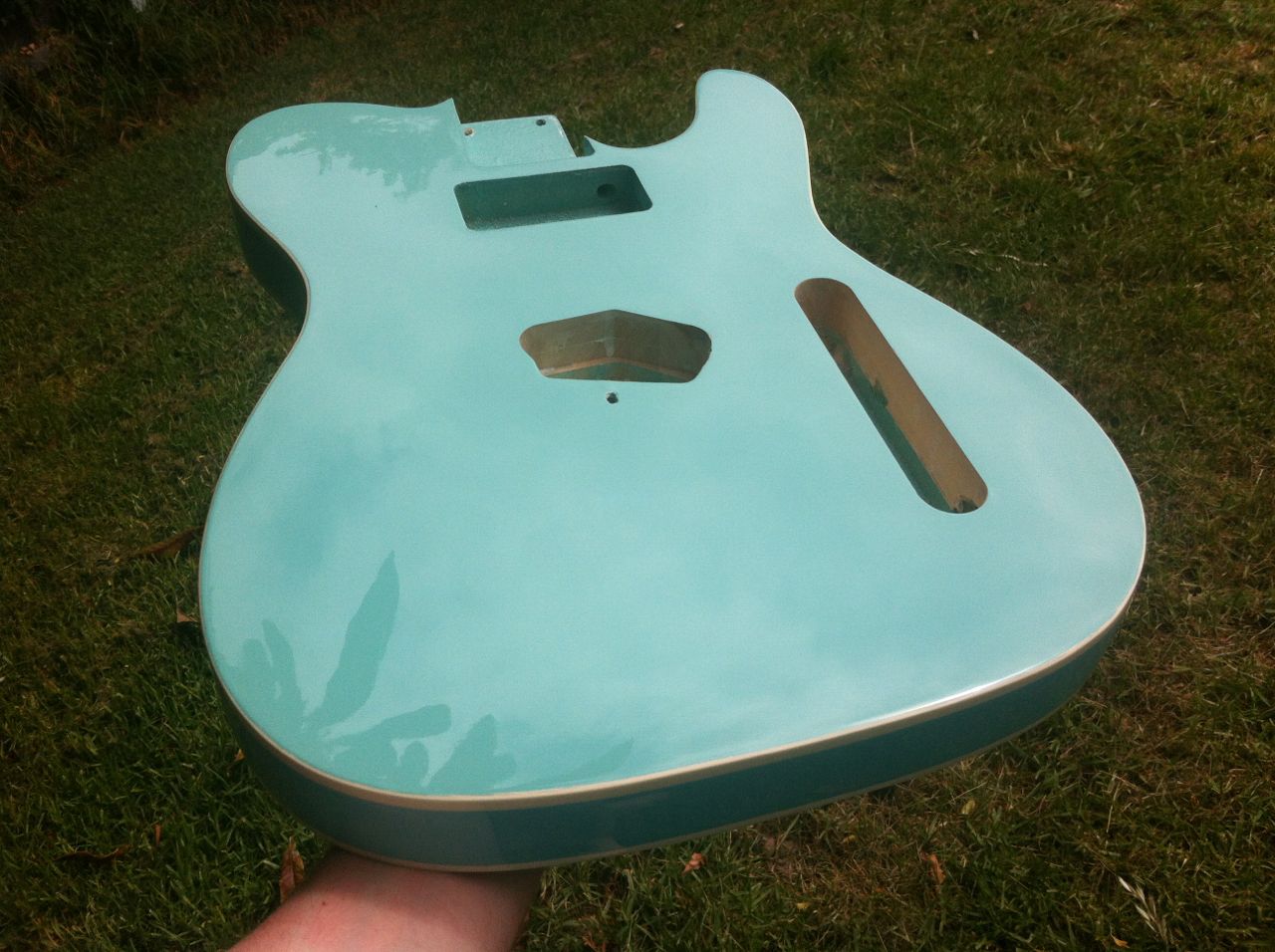

    Following this I also wet sanded the body down removing most of the orange peel with 600 grit then moving up gradually to 2000. I then used turtle wax scratch remover and maguiers polish to get a nice shine up.
ID:	6015   Click image for larger version.
ID:	6016   Click image for larger version.
ID:	6017   Click image for larger version.
    nice one Tim that is really coming along nicely, nice shine !
    Love the table router must make life easier and you nailed the template you copied, well done

    Oh, so you found that you did need to enlarge the pickup routes for toneriders? Good to know.
