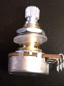

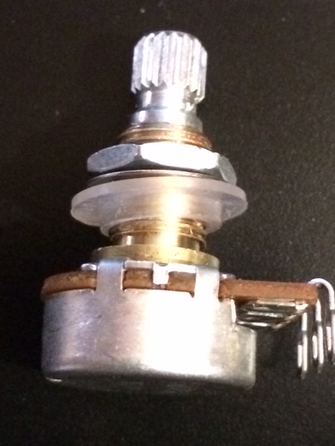

    Since I've preemptively enlarged the pot holes and then thanks to members here found the metric pots I couldn't previously see anywhere... it turns out the same people who had the pots also have 8mm to 10mm pot adapter bushings.
    They look like this:
    I figure two ways those can be placed, from the inside with the washer and nut on the front under the knob, or on the front under the washer.
    Since the pots actually have a 10mm section near the body after the thread stops, if I fit that to the 10mm hole, then the bushing can go on the outside under the washer.
    This will give contact to the 10mm hole on both sides.
    Problem solved, and with the vol/tone pot types I was hoping for.
    Yes, the kit provided ones were the right types, the replacements feel and look nicer.
    - Sam

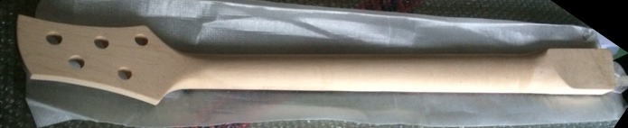

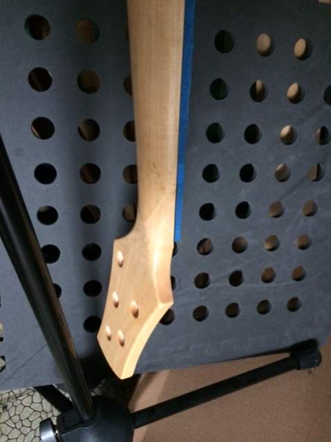

    The Dingotone Colourless Neck Finish kit arrived in the mail today.
    I'd already sanded the neck before I started on the body as the predrilling decisions had all been made.
    So this:
    has become this:
    The colourless as the name suggests doesn't change the colour of the wood so much as it deepens the contrasts.
    I like how it looks.
    Now to let it hang for a week. In the meantime I'll find where I hid my waterslide paper and design and print a headstock logo.

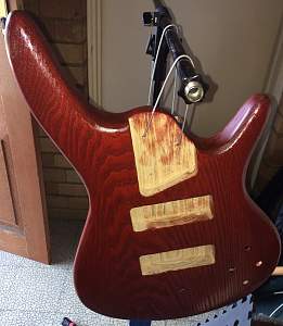

    Applied the first intensifying coat yesterday.
    Still a little "wet" in the picture, but if it keeps any of that red tone I'm going to be pretty happy with it.
    Give it a few more days and it'll get the second coat.
    - Sam
    IB-6S - done.
