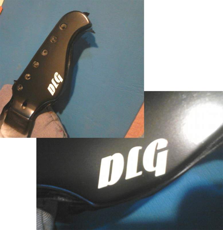

    How good did that lettering turn out!! Fricken stoked about that. I can't believe I wasted all this time trying to bury waterslides and vinyls, cheers Anyport if you're out there;-)

    that looks hot!
    do tell how... all paint?
  3. #73
    Banned bargeloobs's Avatar
    Mar 2014
    1,700
    that looks hot!
    Yeah all paint Stan, I just used the vinyl decal as a stencil. It should cut the clear coats in half I reckon.
  4. #74
    that headstock looks awesome with the lettering Barge, you don't muck around, he's had the kit about 24 hours and its moving along very quickly. Look forward to seeing the body when the flame maple arrives !
    @ Stan I think he had the white coat on the headstock and used Andys lettering to block out the black coat like a stencil, then maybe peeled off the lettering stencil I presume. Ah Barge beat me to it
    Results are spectacular

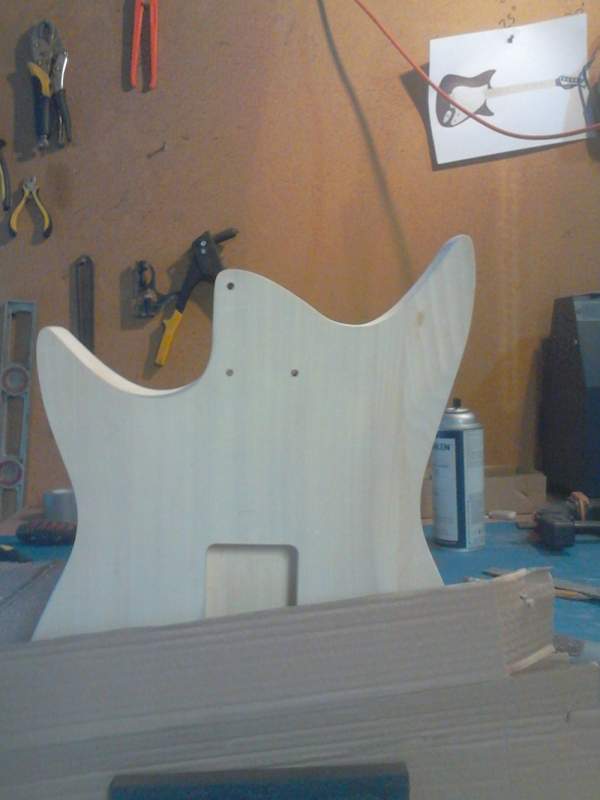

    Speaking of hacking off wood, there goes a bit more...
