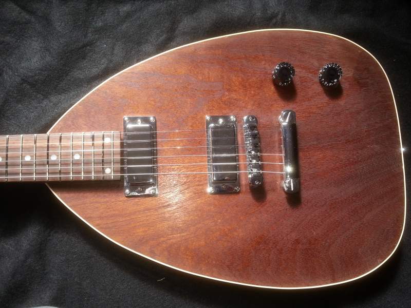

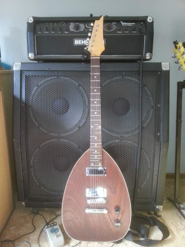

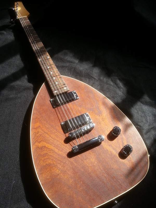

    This dark Cuban beauty is for all intentional purposes "done'
    The strings are on I've plugged it in and it sings .
    I will probably do a few tweeks to the Vol and tone pots as they seem to be rotating the wrong way for my likes.
    The push pulls work a real treat.
    I haven't set the intonation, but it was perfect on all but low E.
    I am guessing that will change when I lower the bridge a bit more.
    Also need a set of Fat pick up rings, or a lump cut out of the Bridge Pup adjuster springs,a s I can't wind it up high enough.
    I've discovered a major draw back with this design style. When I sit down to play it it slips off my knee. DANG..
    I haven't played standing up for many many years.
    Dave, If you don't want the L202 send it to me.
    PK
    Overall I am very happy with how this sounds. has a nice sustain and tone. Not bad for something built from a failed build.
    It was supposed to end up as one of my Eagle 11's
    PK
