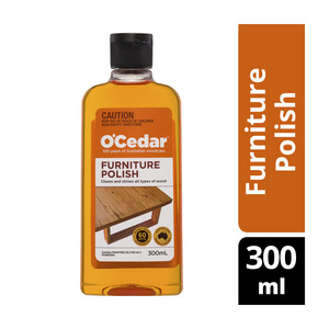

    I had a look online and the O'Cedar product I have is no longer available as "Revive" but the company has just renamed it as O'Cedar Furniture Polish Liquid.
    You can get a 300ml bottle at Coles for $8 which would last at least 6 lifetimes I'm sure! The main ingredient in both is 99.9% Mineral Oil (or what we call Parrafin Oil). Presumably the other .1% is colour & fragrance.

    That's awesome thank you. I'll pick up a bottle the next time I do the dreaded "big shop."

    It's certainly more economical than $15 for 50ml of Dunlop Lemon Oil.
    You could portion it into little bottles and give it your guitar mates for Christmas and still have plenty for yourself!
    Label it as "Graham's Fretboard Magic".
