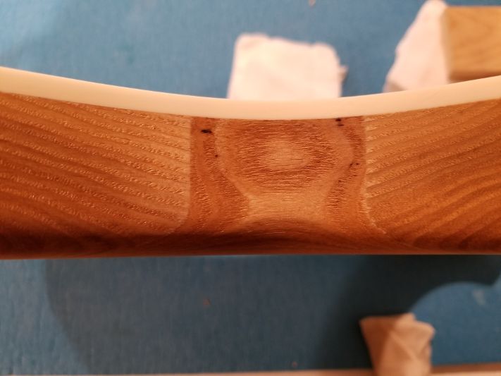

    So with much deliberation and hand wringing, I decided to pull the trigger on the Wudtone Surfer Girl. I've read as much about Wudtone and it's characteristics that I can, but I want to start finishing. I'm at 240 grit on the body and neck, but the Wudtone supplier says I can 320 grit the neck. They also suggested I set the neck before finishing, because the glue that will seep out from setting the neck wont receive the color coat/basecoats and will be noticeable.
    I do notice there are some glue spots where the 5 pieces of wood glued together to create the body are noticeable, more so on the under side piece, can these be wire brushed out? Or do I just live with these?
    Should I 180 grit the End grain pieces as they seem much tighter in regards to grain?

    Those end grain joins are common and should be ok. Still reckon 240 grit is the limit as 320 can end up acting as a polisher.

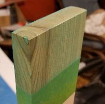

    So I am testing. One application of even amounts of the Wudtone color coats, rubbed, circular, pressed, pushed into the grain 3 sides of the test board. Stippled and finished with the grain. Looks weak.
    Second test on the back of test board, Mixol Green #8, 6 drops, 10 drops of White #25, thinned with denatured alcohol so wouldn't go opaque.
    I'll go thru the Wudtone process according to instructions, hoping the next applications make a difference.
    Now to wait 24 or more hours.
    Any thoughts on this?

    I haven't used Wudtone before. I've used water and spirit based woodstains from a luthier suppliers store. I feel the spirit stains do penetrate a bit more, the spirit ones having a lower surface tension than the water ones. So spirit based stains are more likely to penetrate a more polished wood. However this does also mean that spirit based stains are more likely to penetrate the small cracks in binding, whereas I've found water based stains stay on the surface of the binding and can be scraped off, so it does pay to tape over bindings.
    But certainly it can take several applications of stain to get the right colour depth.

    Simon, does it look like I may end up with Treated Lumber/Timber look?

    Those test samples would suggest you need to keep grain open as much as possible otherwise it may end up like a pastel white wash effect in your chosen stain colour.

    Waz, this test board was sanded with 240 grit. I might just sand it back with 120, then 180.
    Before I do that though, I'll apply another coat or two to see if has any effect. I hate wasting the stuff, but that's better than wasting the body and starting over on it. I guess the idea is to really bruise it up some, eh?
  10. #70
    No need for bruising, just an even smooth all over feel should do the trick. The coarse grits leave just enough wood fibres for the stain to grab onto.
