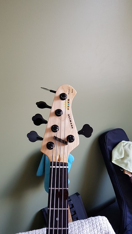

    Luckily it is a bolt on....so I can continue with pickup install and bridge placement etc.
    I think I will have to remove that close tuner....may try tape to pull the rest off....a little fine wet sand....a couple of coats of TRU-OIL as a base....leave for a week and then reapply the decal....wait 24hrs....and ten more light coats of TRU-OIL.
    Oh well.....it will have a BEE on it....it will...really.

    Bummer. Doesn't take much wet sanding to strip lots of layers of finish off and it may have been thinner than expected in that spot.

    Very different sound. I have wired her up...fitted most things...strings are up and had a little blat.
    More work to come...gotta fix my BEE.
    Thanks for your help.

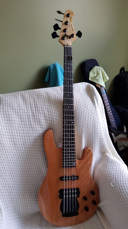

    Pre Amp unimpressive.
    Not a huge fan....pain in the butt to fit and does not make that much difference.
    I have to go to work on monday for 7 days.....so I think I will think about it whilst I am away.
    But...I think a Real Parts order may be on the cards.
    I am thinking of fitting a push pull volume pot to the musicman bridge pickup....it comes ready to be split.
    The neck jazz bass pickup is really strong....the bridge has a great musicman punch...but the bass and treble controls of the preamp are terrible...and the blend pot is horrible....when both are on I get echo....whaaaatttt????
    The headstock string tree goes on easy and looks great. I levelled and polished the frets and the neck moved into good relief easily.
    I had no issue with intonation and I get no buzz at all with a 4/64 string height at 17th fret....wow.
    The neck is quite wide and I keep finding the B string when I look for the E....even doing a scale.
    Love the mahogany body...and the Tru Oil feels so glossy and like a mirror.
    Gotta have my BEE....fix number one.
    Gotta build a passive wiring harness...with push pull split.....fix number two.
    Gotta think about moving the bridge back a little.....the measurements for the intonation were good....but more reflect my experience with Fender style bridges.....this loooooong black thing can go back a good 5 to 10 mm.....the string spread then may give that little better pickup coverage.....presently cannot get all pickup magnets under a string at the same time....strings need to move a little.

    Agree that the blend pot is next to useless on these pre amps. I would suggest replacing the blend pot with a traditional 3 way switch to select neck, both, or bridge PUP's and swap the volume pot for a push/pull to do the coil split if you really think it is necessary. The Bass & Treble boosts are ok and i am still playing around with mine to find best sound settings.
    The sound demo of my Mmb4 gives you an idea of what it may sound like on split coil but push/pull will only give you one option, not both. I found the front/neck coil sounded a bit deeper which was better than rear coil.
    If you want to test the theories before buying more parts check out the split wiring post I did a while back and separate the red & white, and then wire it back up with just one of the humbucker coils working/connected. If that sounds crap swap to the other coil. If they both sound crap, just reattach red & white and leave as is in original series humbucker mode.
    Cheers, Waz
