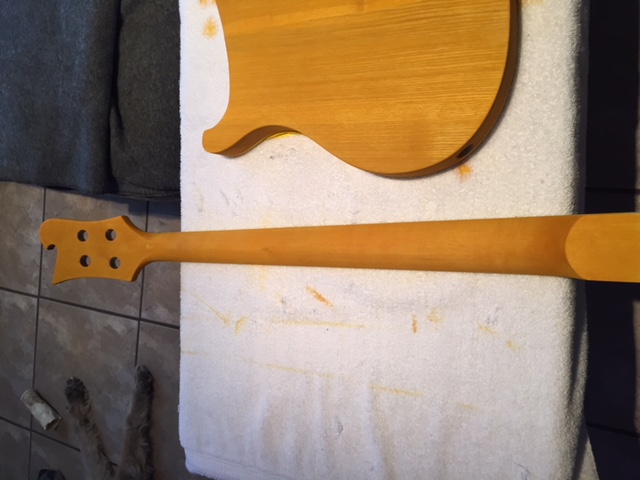

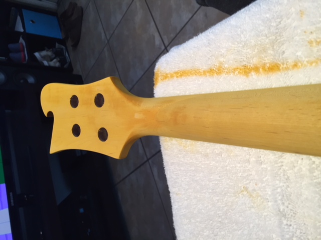

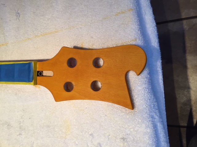

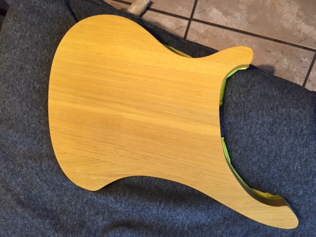

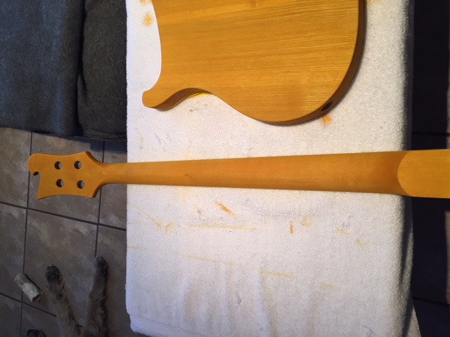

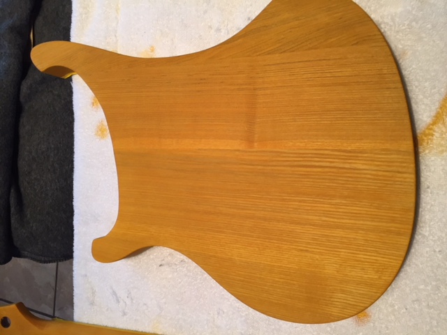

    I got the courage and started staining this morning. I did a few test samples on some spare timber and the mixture I really liked was 1 oz water with 1/8 teaspoon stain. I masked the binding in a way that I could only do the back right now. When the back is done I will peel it off and do the front. The back and the front of the headstock looks really nice and I'm pretty happy with it. The back of the neck is pretty blotchy though.
    2 questions: should I sand between coats of stain since the water is raising the grain (if so what grit)? I was going to ask about what can be done about the blotchiness but as I'm typing this it looks like it's drying up pretty evenly.

    Nice colour.
    The part where neck meets rear of headstock looks like it could have been a bit shinier from initial sanding?
    240 grit is probably all you need to use for a light sand all over, but you may need to drop back to 180 around the sections that didn't take up as much stain.
    As for drying and curing times, no idea as local weather conditions can have an impact but would suggest giving it a day or overnight, at least 12 - 24 hours before moving on to the next stage or layer.

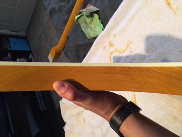

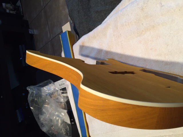

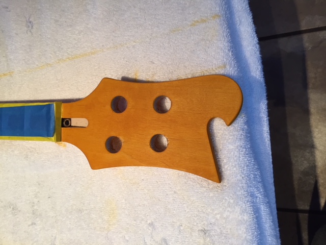

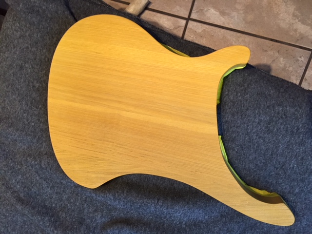

    So this is where I'm at after 4 coats of stain. I did two, sanded with 320, then did two more. I'm really liking the color and I think I'll stop here. I will go over it again but this time with 400 and very, very lightly to get it smooth. Tomorrow I'll pull of the tape and see how the binding looks.

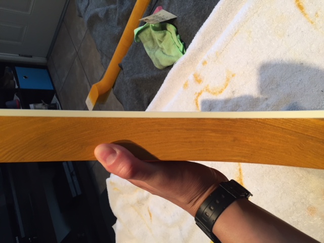

    Pulled off the masking and the binding is in great condition. No stain seeped into any of it, I'm very happy. Now the tedious task of taping off slim top part of the binding.

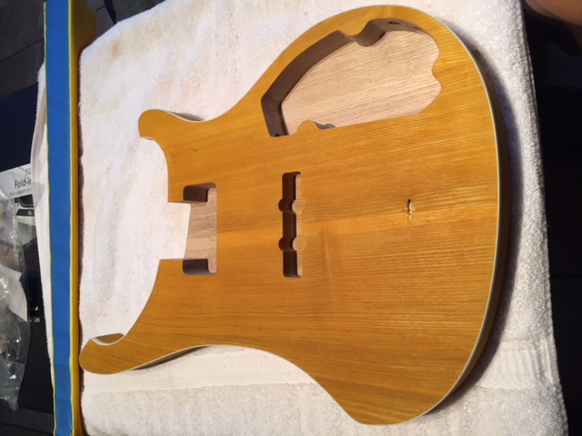

    Staining is complete. The binding cleaned up nicely and the color looks great. The sides have some flaws but overall the neck and body look awesome.
