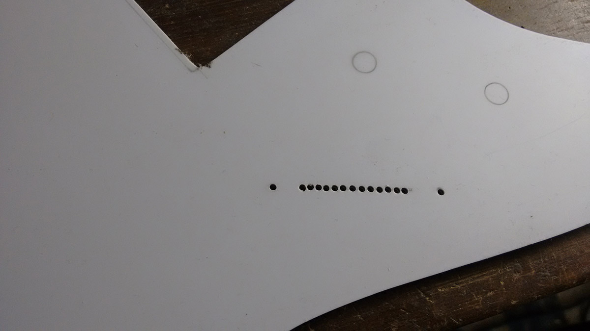

Name:	38 the drill.jpg
Name:	39 the sandpaper.jpg
Name:	40 wheres the neck.jpg
    Next step is to re-attach the neck and strings and test for orientation.
    After that is the arduous task of sanding and painting the body.
    cheers, Mark.

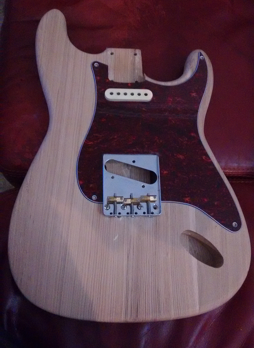

  4. #64
    I adapted a drill stand to drill down through a Tele body for string-through holes. Just set the drill really low in the stand so that the drill bit went below the depth of the stand. Visibility isn't great because the stand only has a small hole in the centre of it, but still, the stand keeps the drill perpendicular to the body. Worked fine for me.
  5. #65
    No worries Simon. I may have another go with that approach when the opportunity next arises.

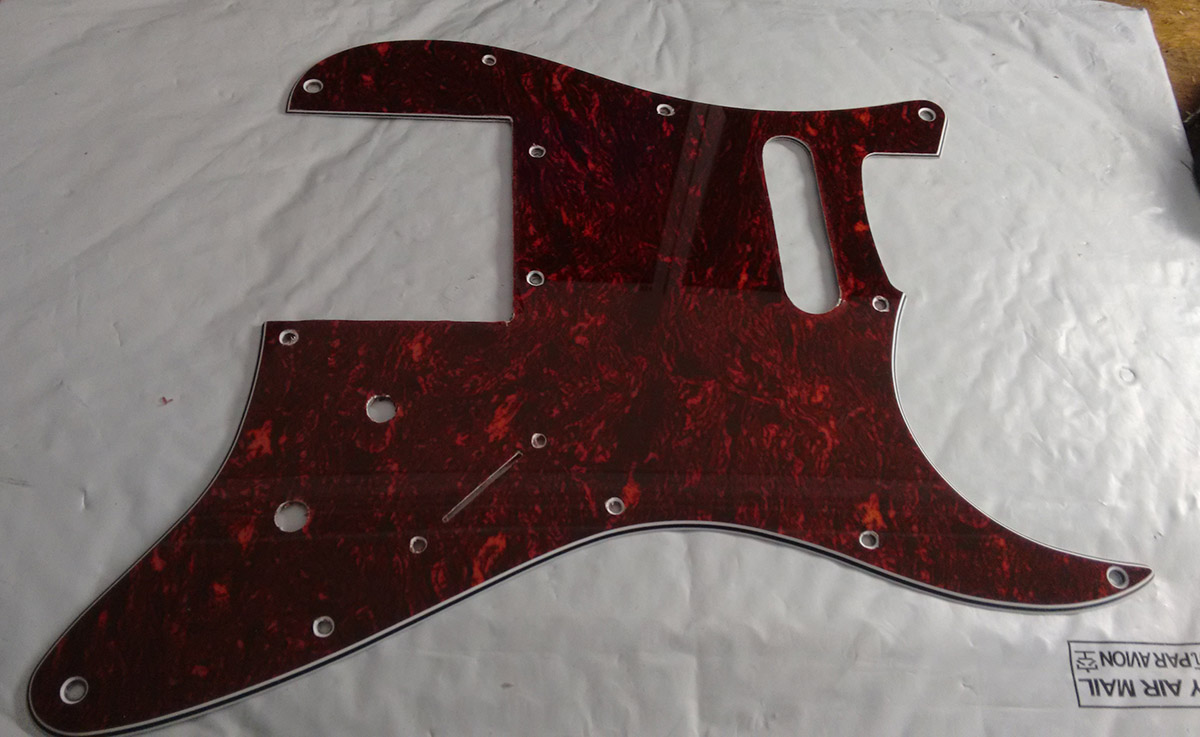

    From this stage, I'm thinking to carry on working the pickguard and install all the electrics.
    Get the guitar in playing condition with all the hardware correctly placed...and then get stuck into the finish.
Name:	41 neck pickguard bridge.jpg
    cheers, Mark.

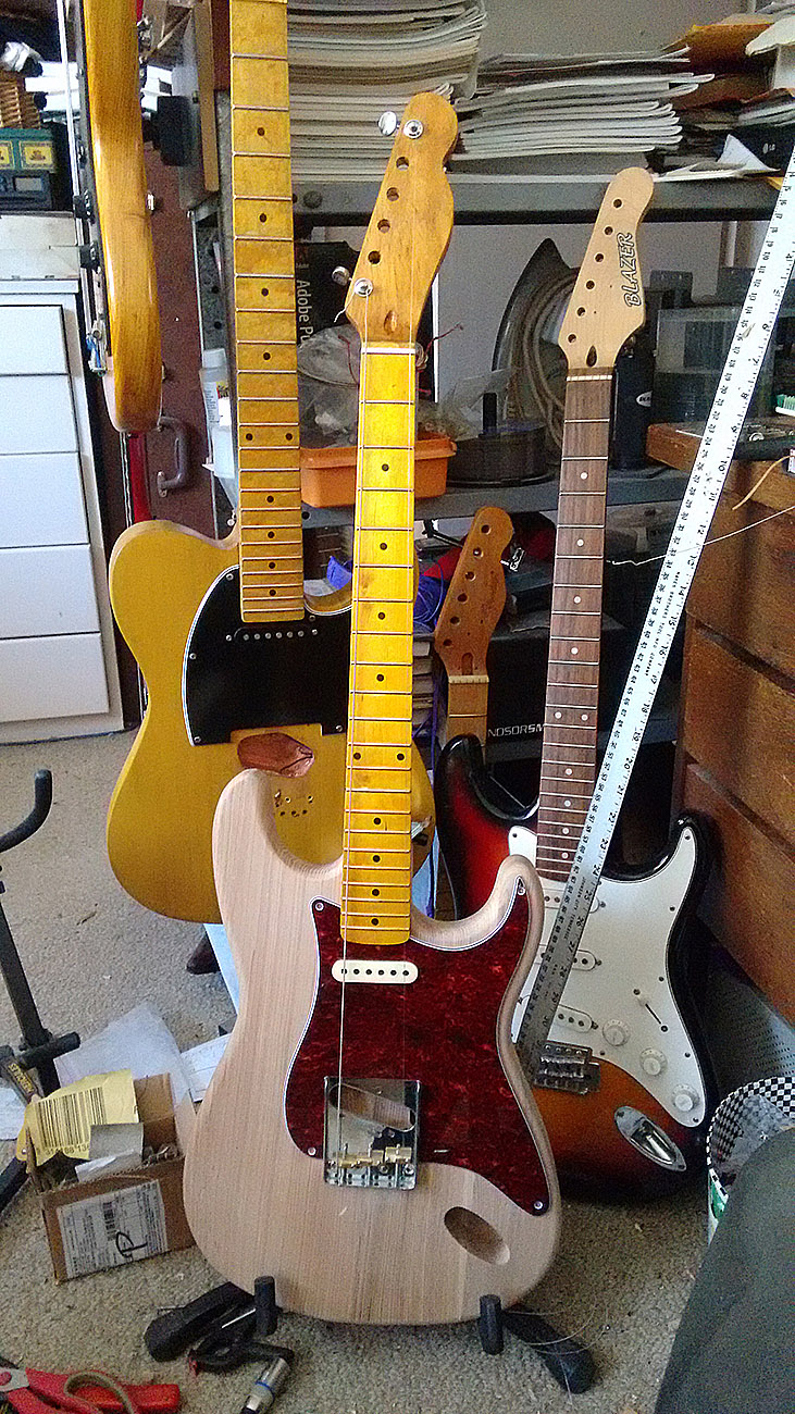

  6. #66

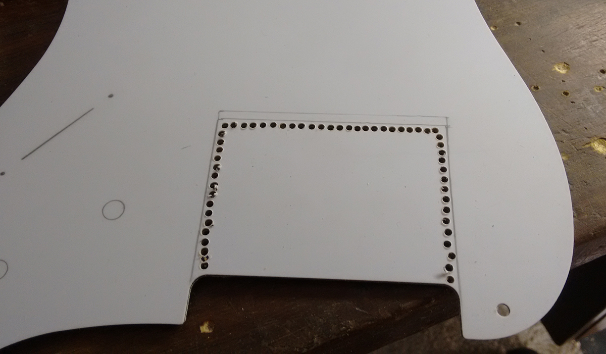

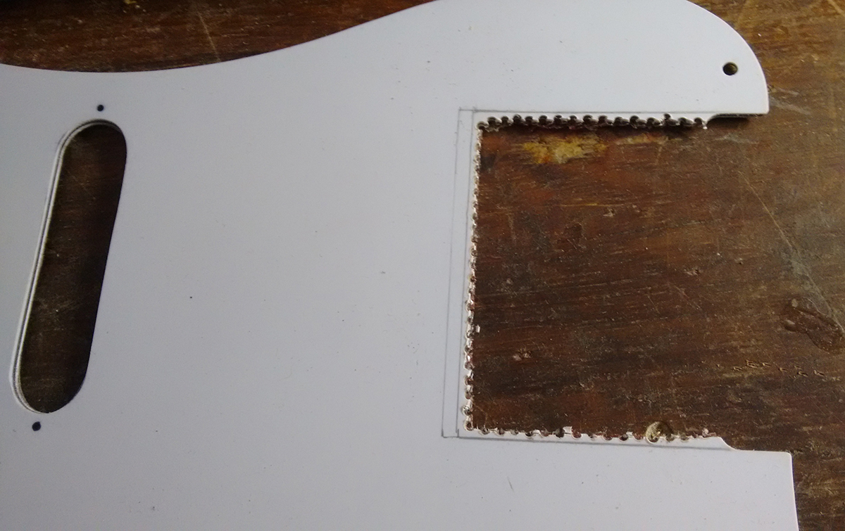

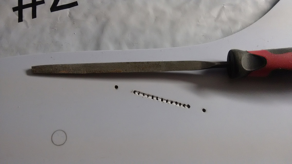

    The saga continued...
Name:	42 drill.jpg
Name:	47 scratch plate.jpg
    Ready for the first full assembly.
    cheers, Mark.

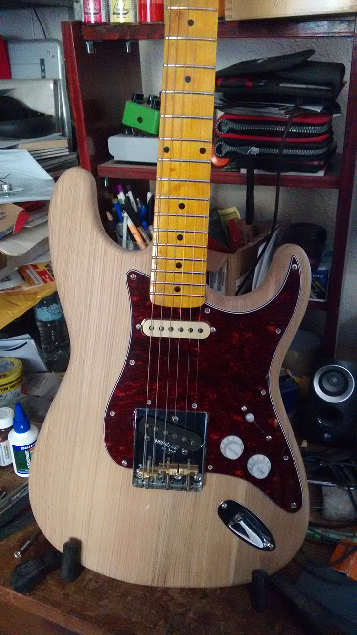

  7. #67

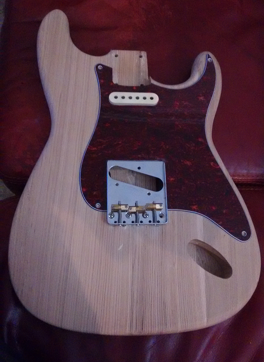

    It's ALIVE!
Name:	48 It's alive.jpg
    Still needs quite a bit of setting up which I'll tackle now that I've reached this level.
    Once I get it playing as well as it should, it's time to break it back down and dispense some elbow grease.
    cheers, Mark.

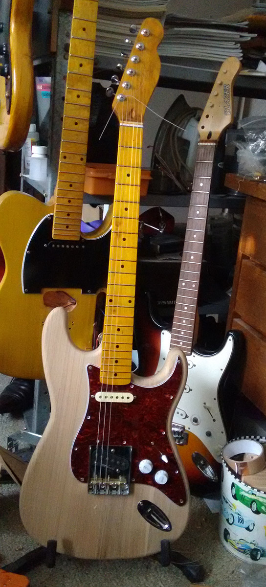

  11. #70
    Most of the frets were O.K. 17 was a tad high, but it's now time to take it apart again and get to the finish.
Name:	59 fret polish.jpg
    cheers, Mark.
