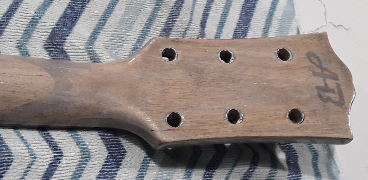

    Great job on the logo Adam, did you print it yourself? Unfortunately I don’t have a printer and I’m no good on the old confused, it took me two weeks to design mine on Microsoft ,then got it printed by “Dr Decal and Mr Hide”where he duplicated it to fill the whole page.
    I now have enough logos to do 40 guitars.
    Thanks wayne, yes i printed a page in differenr colours then a light spray of clear over the top to seal the inkClick image for larger version.

    Quote Originally Posted by Adam Barnes View Post
    Yep. Great logo.
    Classy font.
    Less is more.

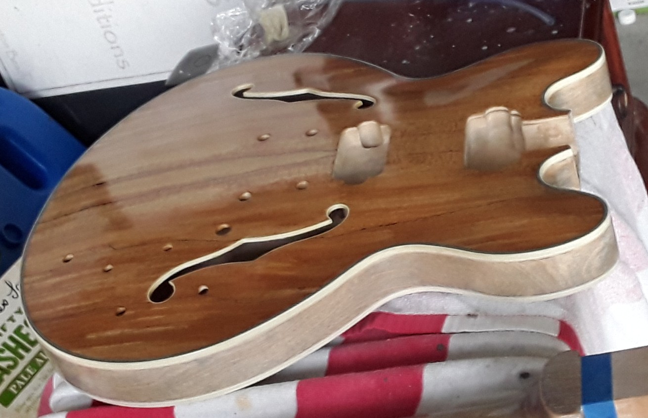

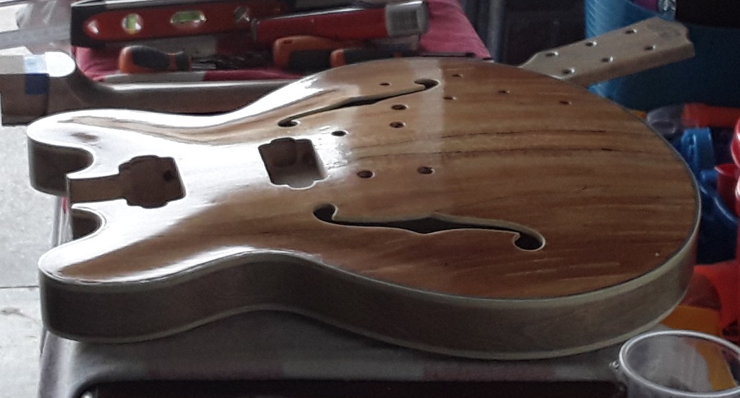

    Over the last 2 days ive been able to get 10 50/50coats of t/o on its touch dry in 30 mins and recoat in 75mins. Starting to really go flat and shiny

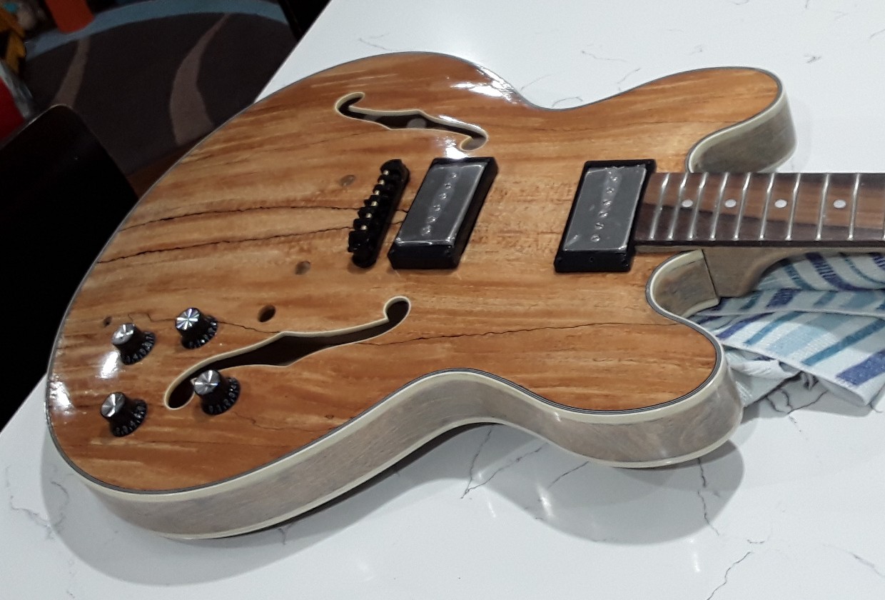

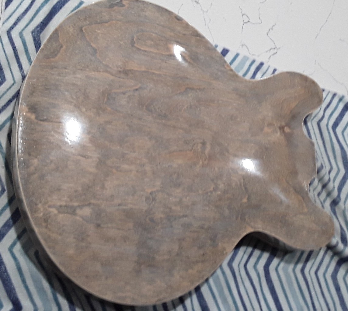

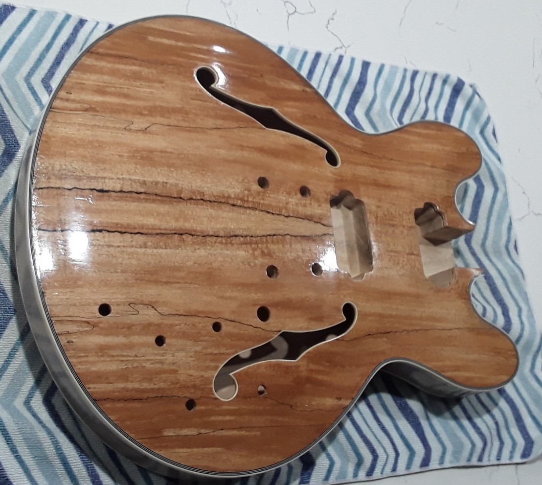

    Im out of oil so that will have to do, I'll let it sit for a few days before polishing up

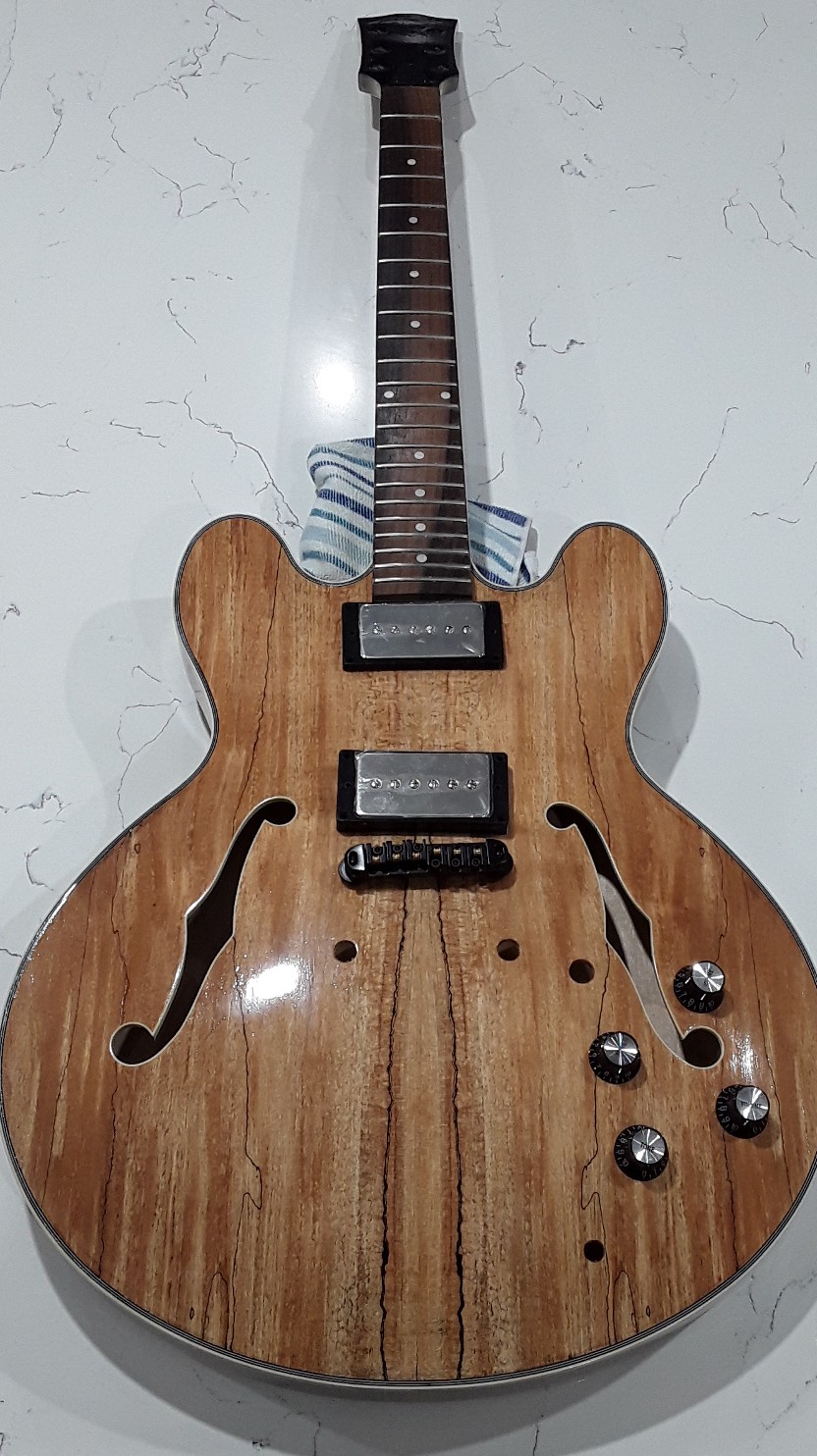

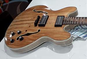

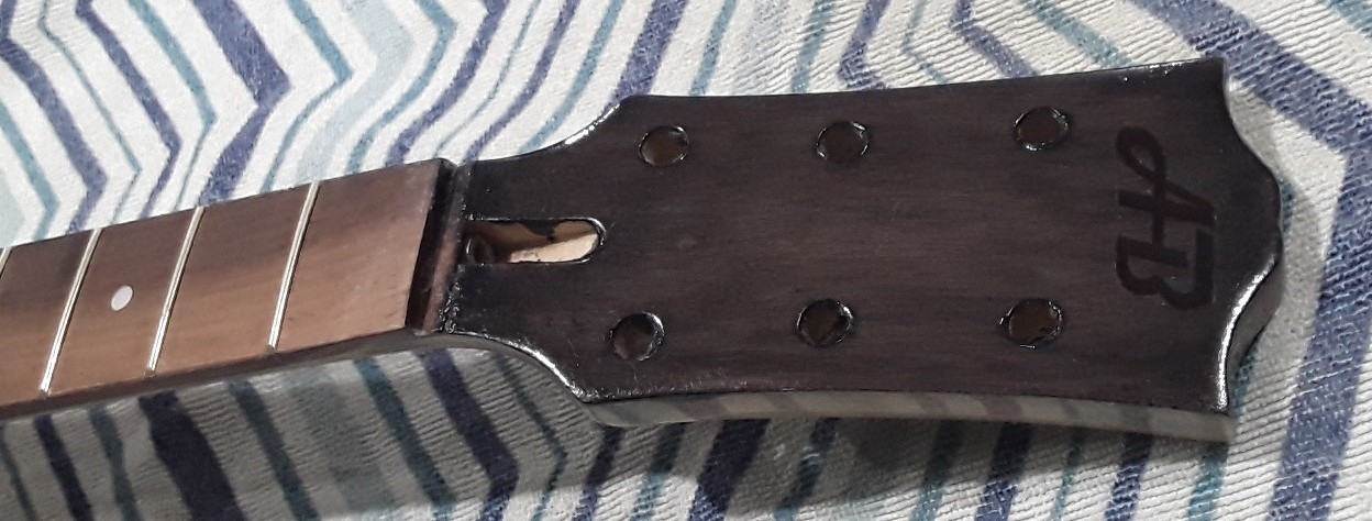

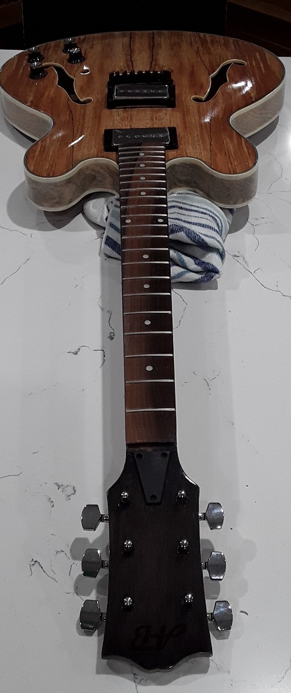

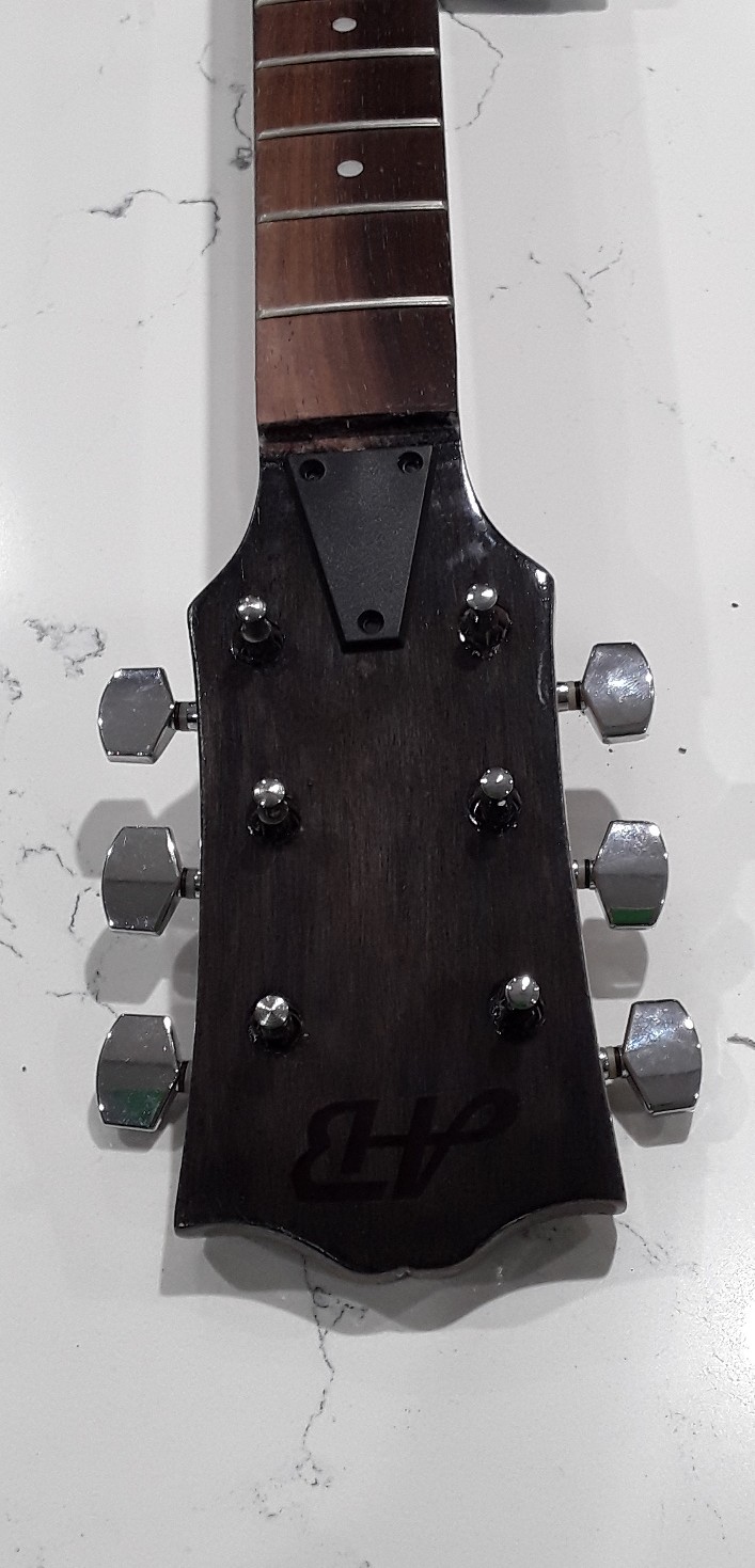

    So tonight ive done the neck flattened and crowned frets and dingo waxed the fret board, the two tone fret board has come up a treat.
    Couldnt resist a mock build ive ordered all black hardware exept for the tuners i like the bit of chrome against the black.
    I was going to make a trussrod cover but after putting a kit one on it sort of suits it, Click image for larger version.
