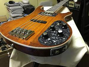

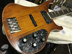

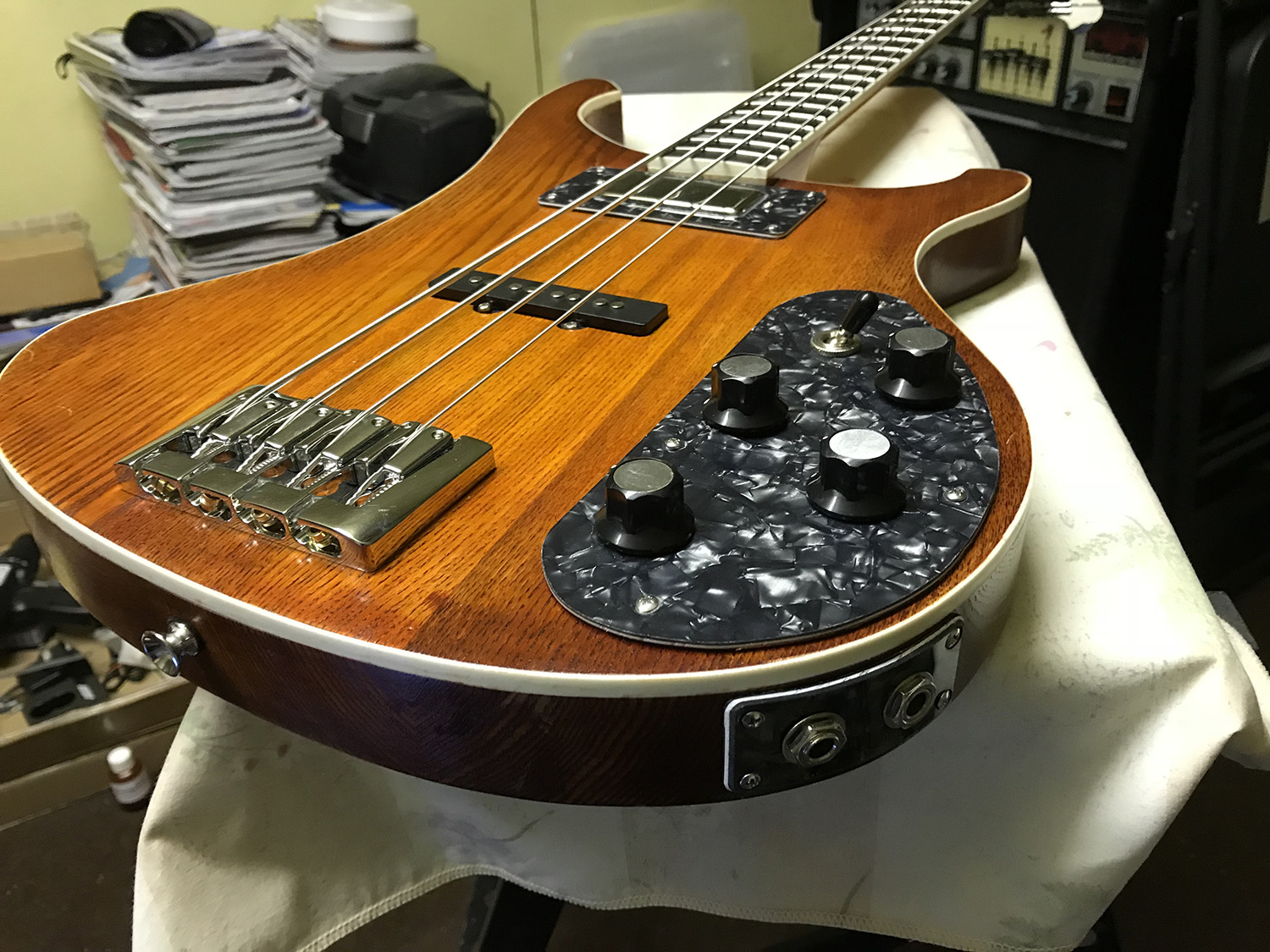

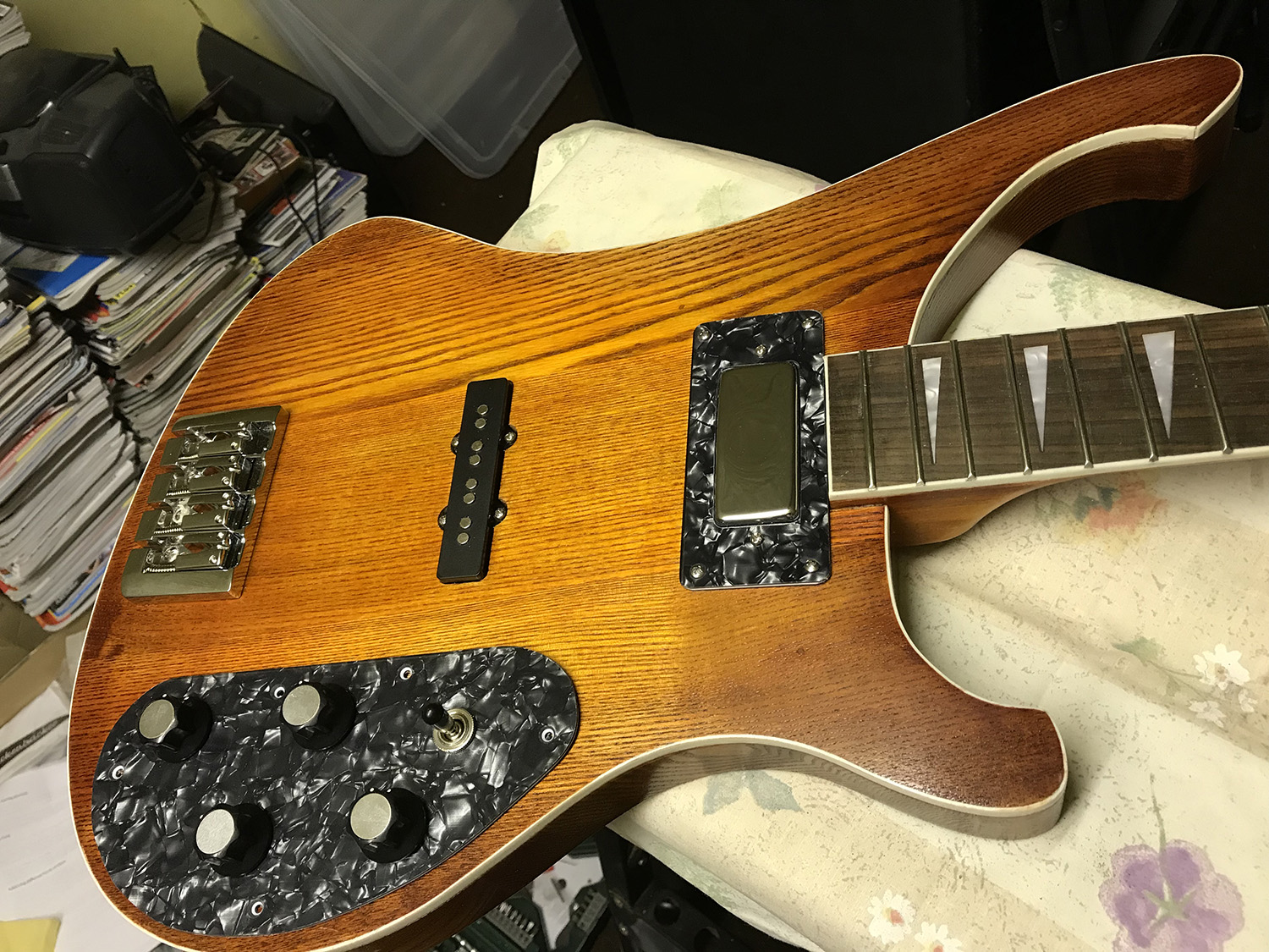

    A few more steps on the way today.
    Pick ups and bridge fitted - I even remembered the earth wire:-)
    Control plate just laid in place for the pics. Have to psych myself up for the last few bits of soldering.
    I had the black pearl in mind for the plastics as soon as I chose the stain colour but I have been having my doubts as the build has gone on.
    Seeing it coming together now I think it might not be to everyone's taste but I think it looks good.

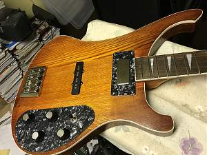

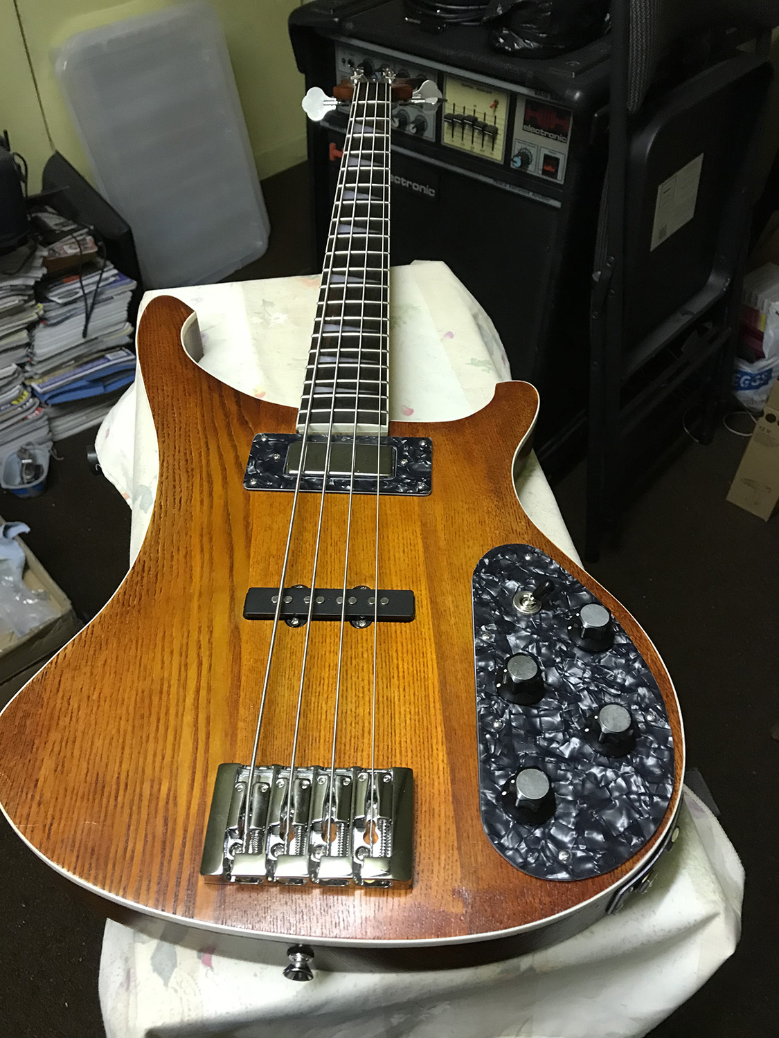

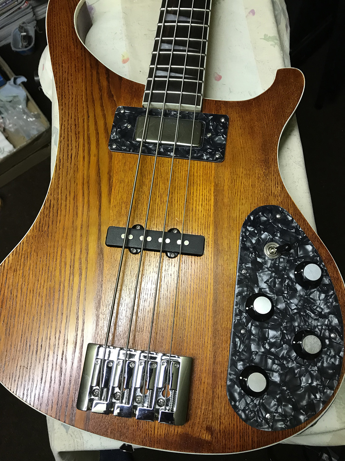

    Wiring finished and its all buttoned up with the strings on.
    There is a slight gremlin with the wiring no doubt due to incompetence/poor workmanship but it is able to make noise.
    The action is very low - strings actually touching the frets at the moment. A quick check looks like it just need raising at the bridge but I am going to gradually increase the tension on the strings over a day or two until they are in tune to let the neck settle then will have a proper look at set-up.

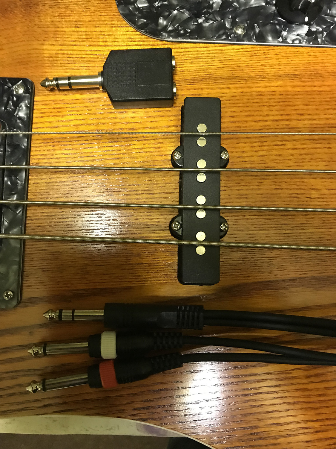

    I mentioned electrical gremlins - well, it wouldn't work I stereo. Only the neck pickup would work.
    Wiring and electronics is not my strong point, I can follow instructions but when it comes to fault finding I am in trouble.
    So I went over and over it and re-made a couple of joints but just couldn't see anything wrong. Then I found a comment on the 'net that if you plug a mono lead into the stereo jack on a Rick it will only work on one pickup.
    This lead me to suspect that the problem was not with the guitar but what I was plugging in to it which was the splitter shown at the top of the photo.
    So I ordered the lead shown at the bottom of the photo and we are in business
    I have only tried it through two channels of the same amp so far but it looks to be a success.
