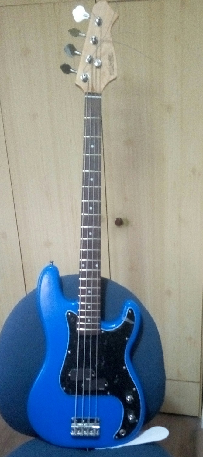

    Thanks Waz!
    As this is my first kit, and I'm learning as I go, and I also had this pretty clear idea of how I want the bass to look like, I chose Ash over Basswood probably because I'm more femiliar with it (I have a few guitars made of Ash), any way I think it turned out pretty cool in the end (I put it together and did initial setup - still need to level and crown 3 buzzing frets) and also sounds great to my taste.
    I will upload a video once I will finish up the setup.

    That looks good. Nice colour too!

    Have to agree with Andy, nice colour combo.
    Hopefully no shrinkage over time to expose the typical Ash grain underneath.

    Thanks Andy.
    Actually t turned out quite similar to what I envisioned
    Thanks Waz!
    Will have to wait and see (again this is my first paint job, the previous bass I build- my first one ever, from scratch - had a Tung oil finish (wood combination walnut on top of Wonga)
