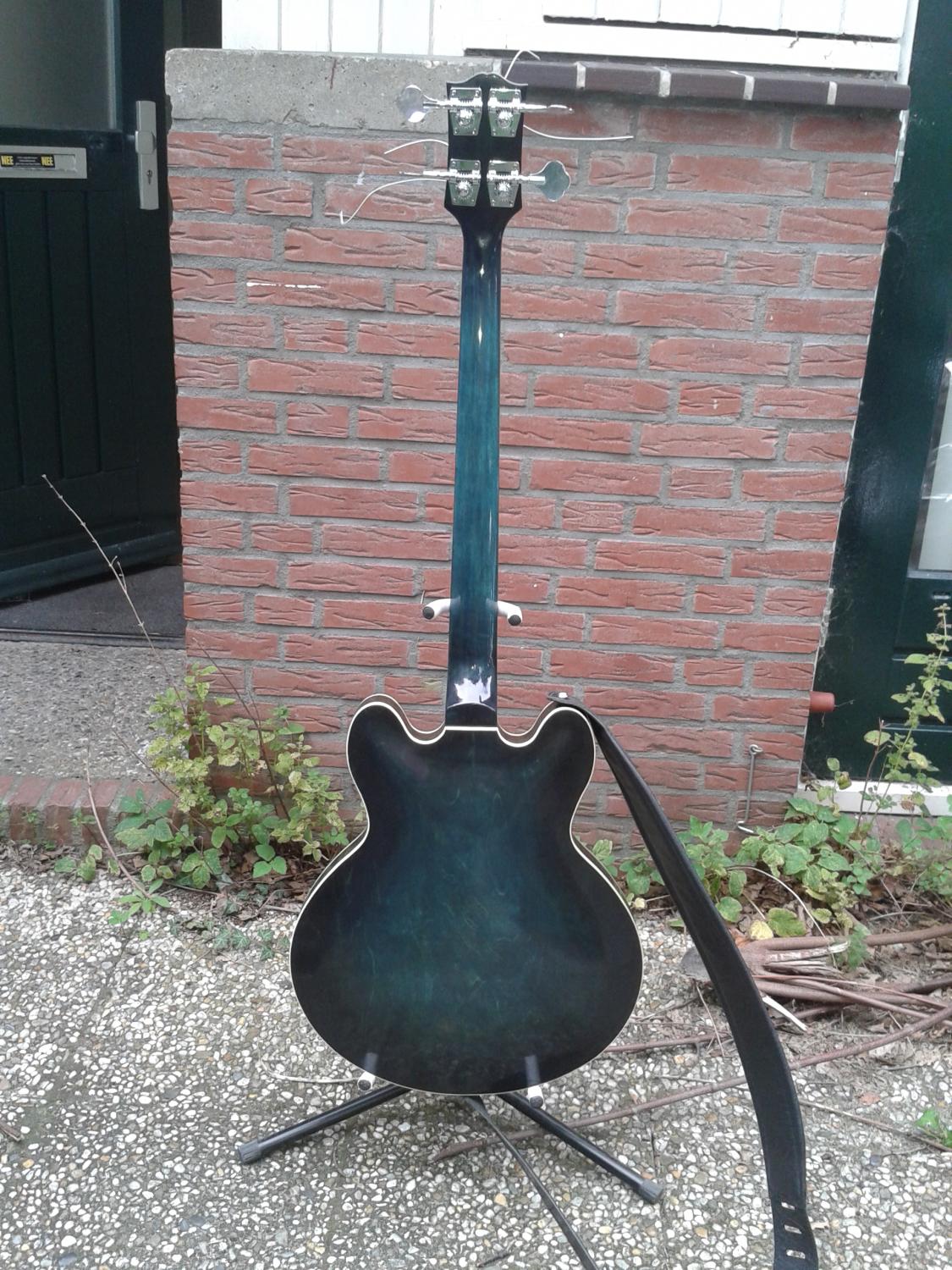

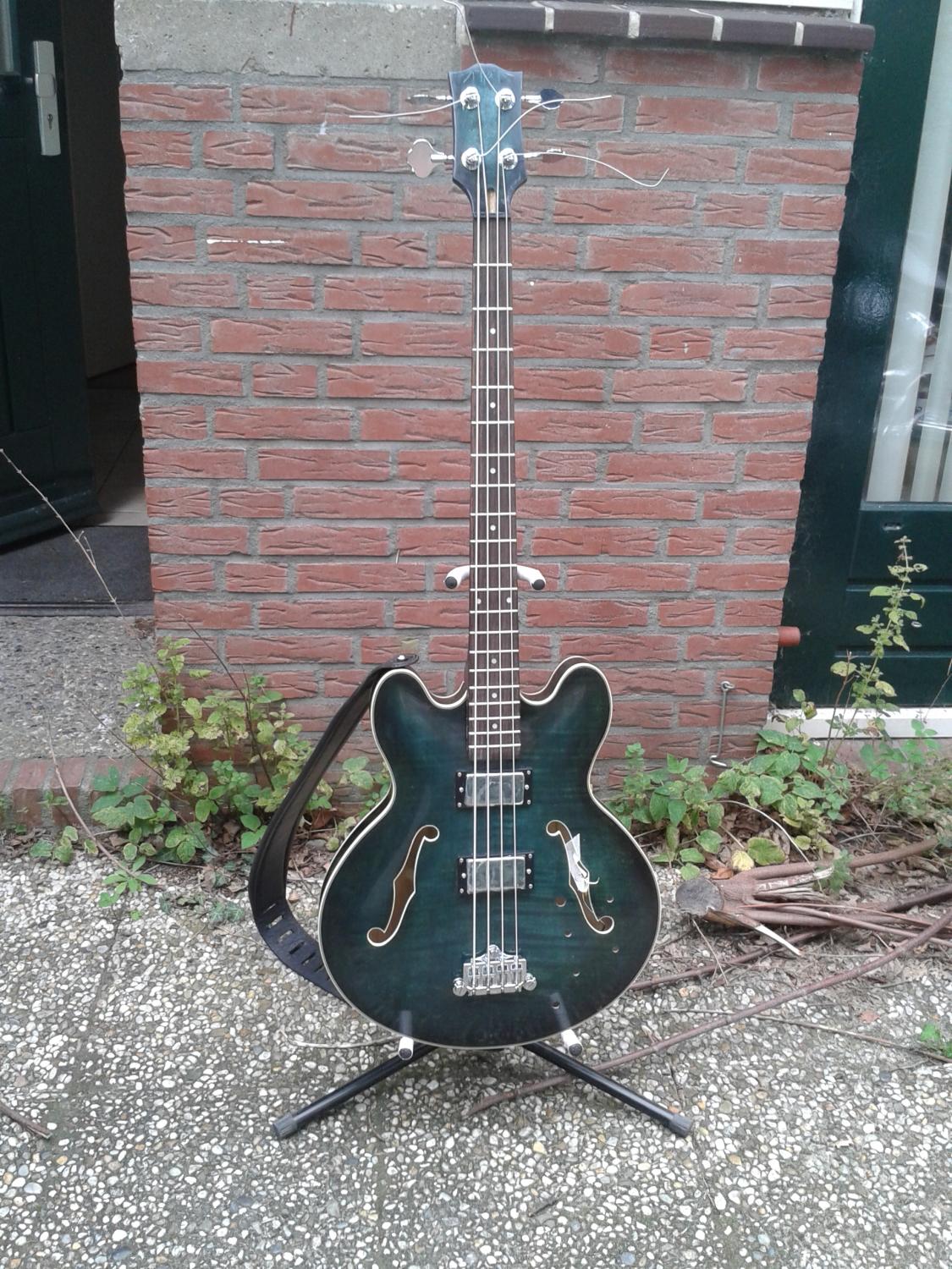

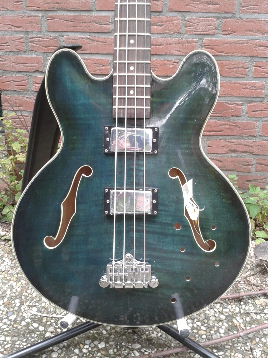

    the building continues.. even though i'm not perfectly happy with the glossyness i just can't be arsed anymore at the moment.
    and guess what.. the next problem rears it's head.. something wrong with the electricks.. gonna take them to a multimeter tomorrow to see what's up..
    in the meantime i can actually play the thing accoustically and for an accoustic it actually sounds better than expected..

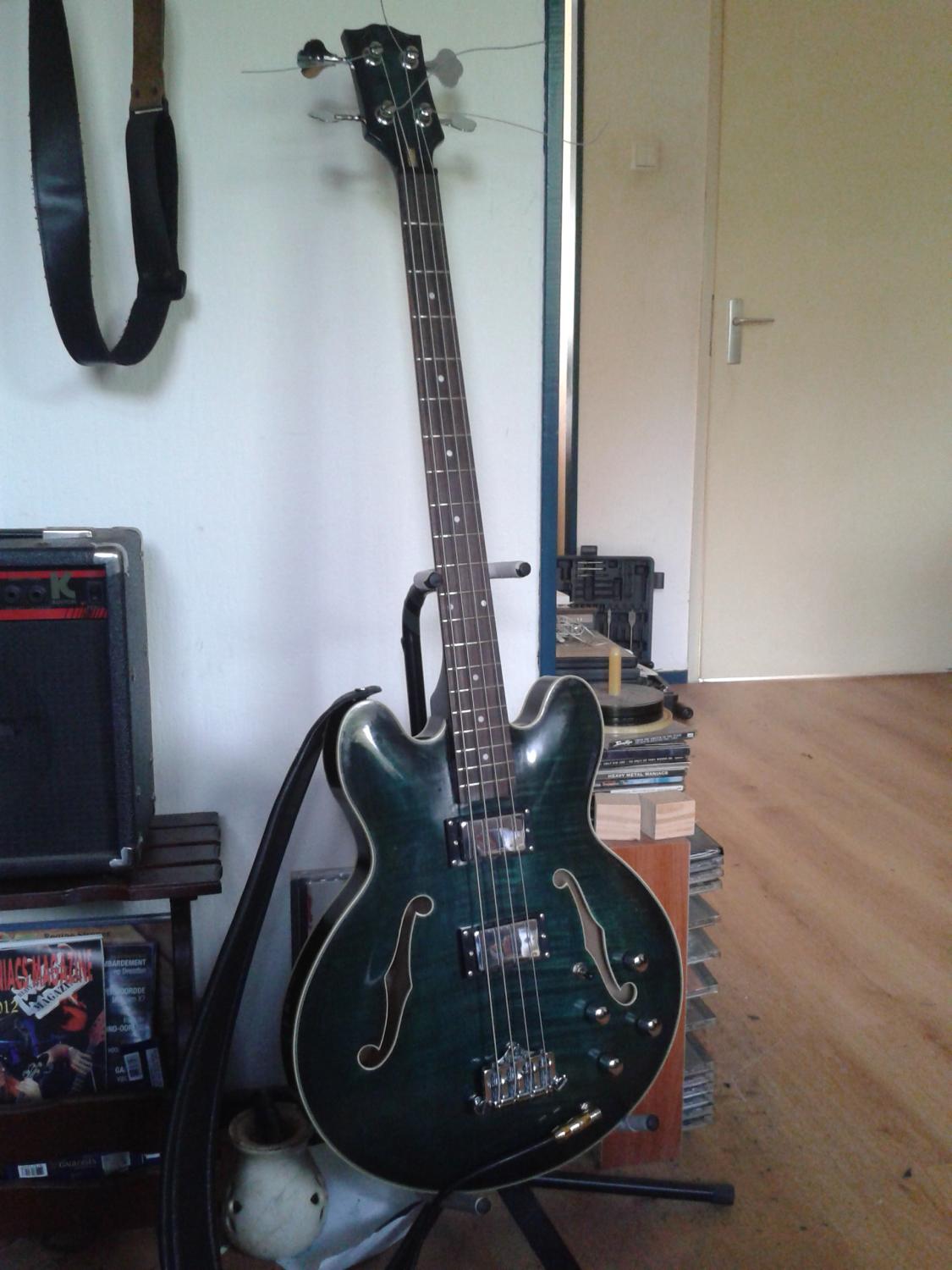

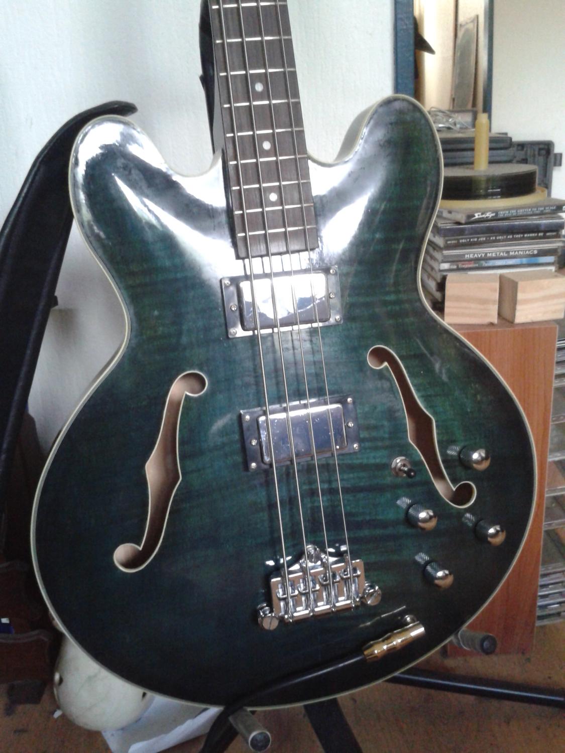

    other than that.. there are some things that need changin on the bass.. the pickups are really low output, may change them at some point and the pots are no good.. they kinda work as switches... 10 is on.. anything lower than 9 is off.. any advice on what pots to get would be welcome.
    btw here's what she looks like finnished...
