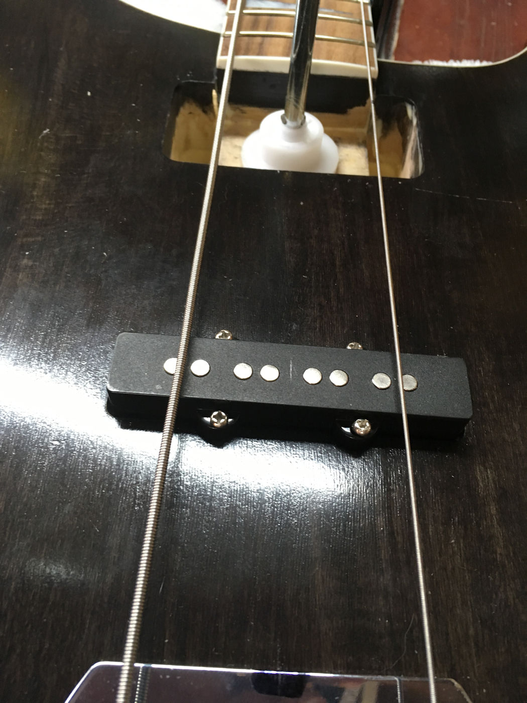

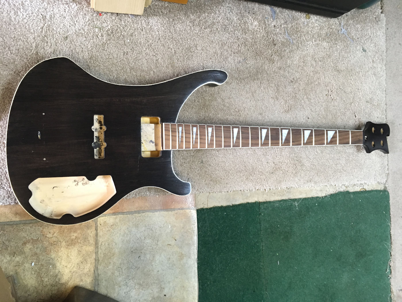

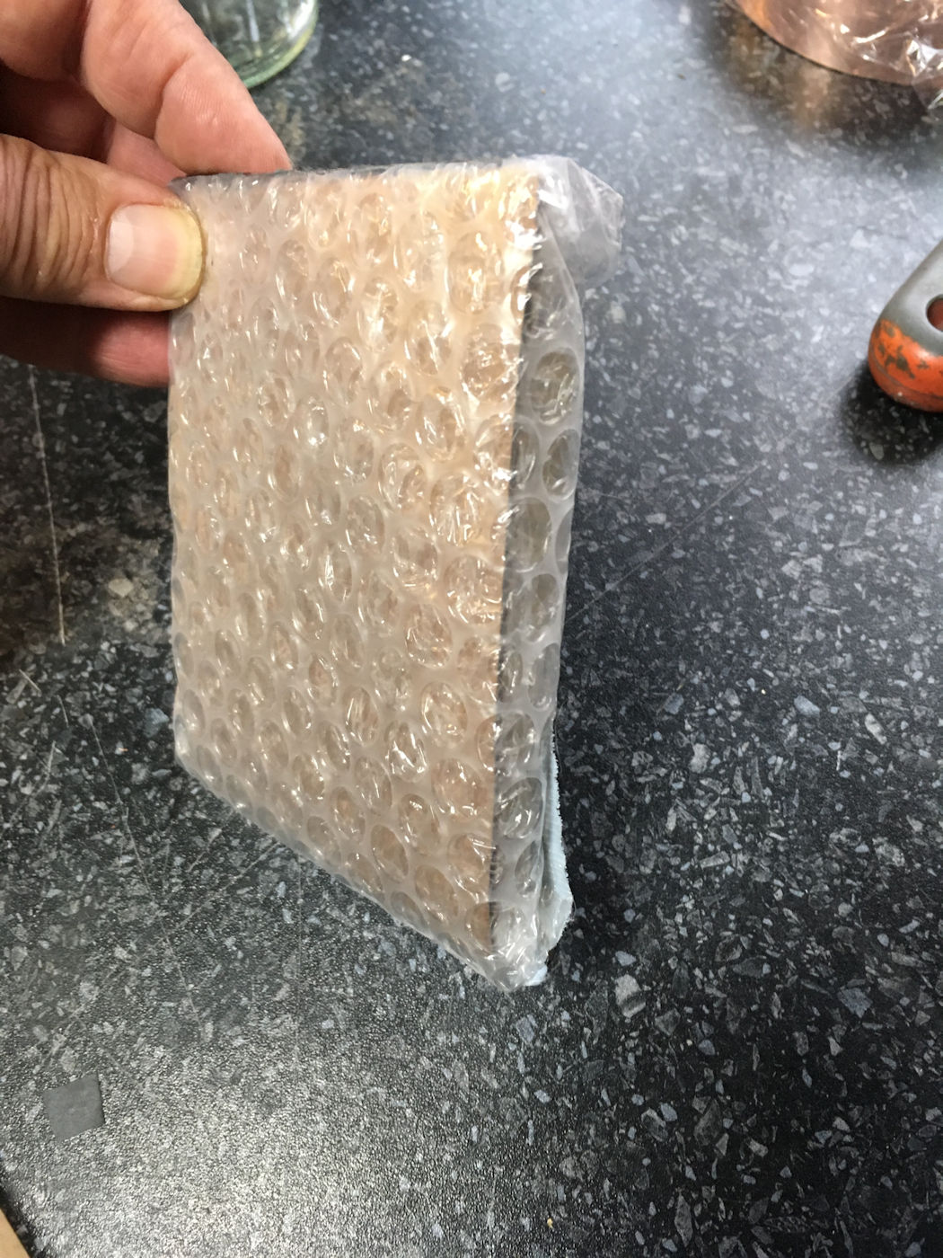

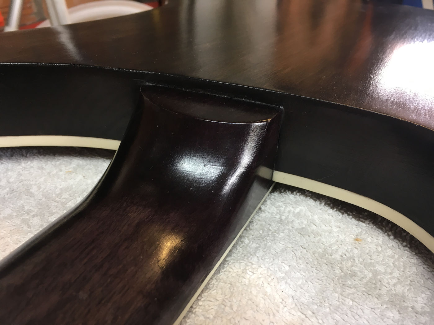

    Neck is now on. Went with it fully recessed as with it in the correct Rick postilion I judged there was enough surface area being glued.
    Setup against rear PUP (after glue applied) is shown with bridge lateral inclination at the horizontal, and the strings can easily be set to the correct position for the JPUP.

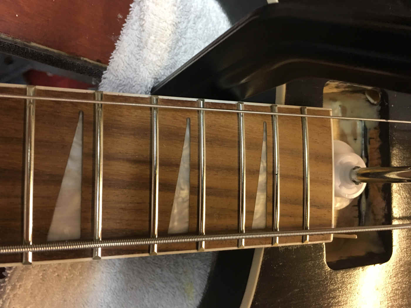

    Neck shows that there are no serious gaps in the fit, even though it was a tad slack because it was recessed.
    Couple of the finished article scratch of the body will be hidden by the pick guard.

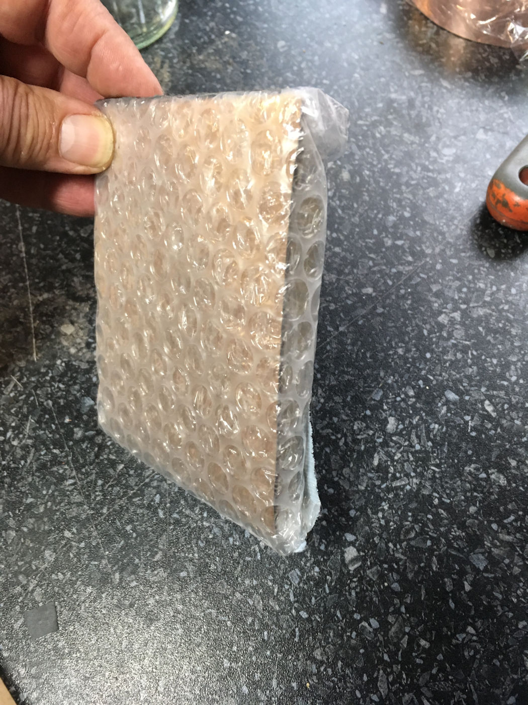

    Picture of the pad I used on the body during clamping. Did a dry run with wood with cardboard pad but the cardboard channeling caused a slight marking of the finish, adding bubble wrap cured this.

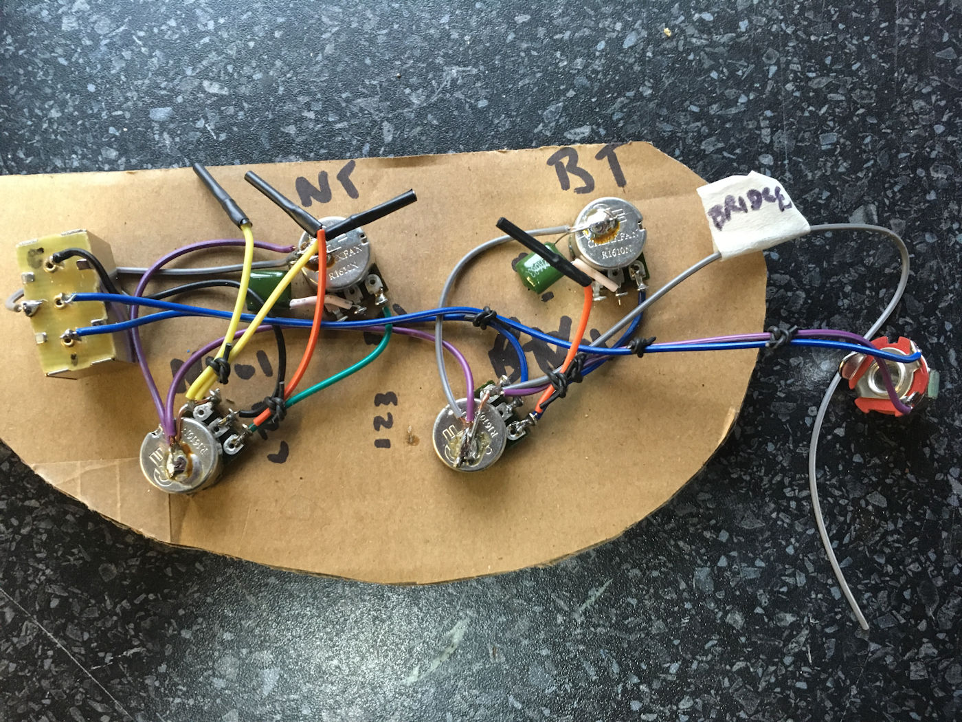

    Wiring done on template. To save routing the body I have used military standard push fit contacts (gold plated) so that the pups can easily be disconnected.
    Also used the screening from standard UHF aerial cable which I will use to screen the pup to control area tunnels.

    Next stage,milliput into the neck slot
  8. #68

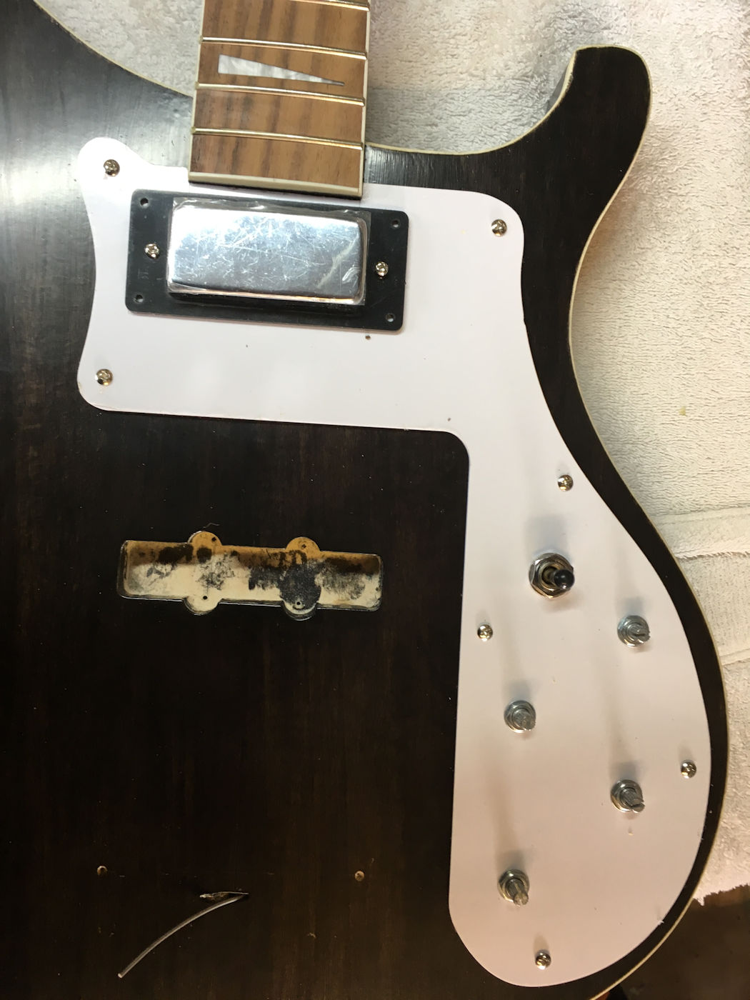

    Pick guard and wiring loom fitted. Didn't end up embedding the neck into it as far as I thought I would. This was mainly due to the somewhat unusual main cavity routing that didn't really match the pick guard fixing holes in that area. Milliput filling around the neck cavity worked well.Click image for larger version.
