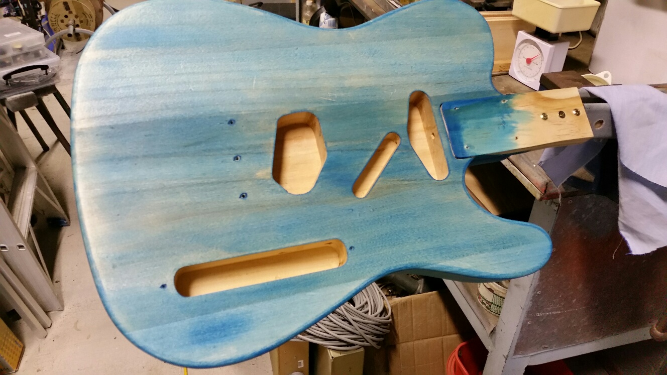

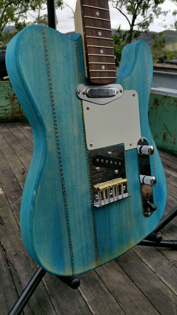

    Can easily see what you are suggesting Sonic but I'm not seeking that look for this build. I have a Tele build (pictured) on the re-works bench with that look in mind but with real denim and Pearl binding and guard.

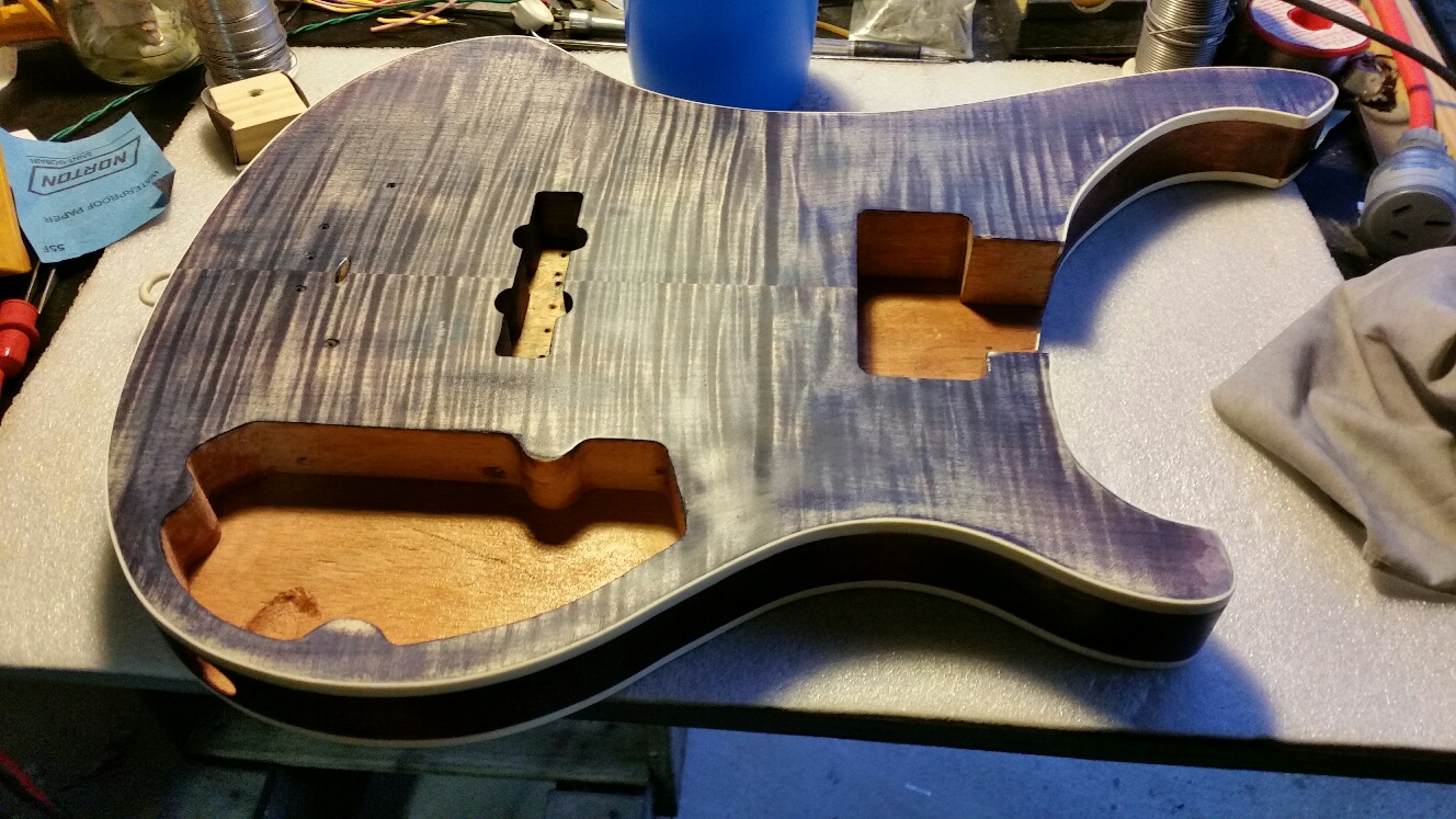

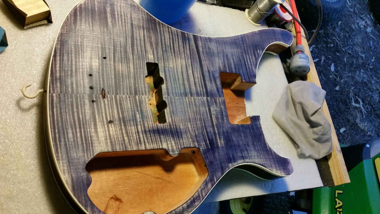

    On this RCM-4F I'm happy with the central fade between the PU's. What annoys me is the blotchy look of the horn and beside the bridge.
    When I applied the polly I started in the light area in the centre and worked outwards. Things started going wrong when I noticed what streaks had happened on the horn, which distracted me from the bigger disaster happening beside the bridge... Less than a minute later in the 28C warmth and 40% RH it was all too late and the Polly had begun to set with all the colour in the new displaced locations....

    That Tele !!!!! Ughhhhh!
    It was supposed to be a stained deep Blue. Sanding sealer on the Alder body put an end to that. Friends suggested it had a denim look so I went with that as the photo's show, but I wasn't happy... looks half arsed cheap and shoddy. Going with a real (soft to touch) light coloured denim veneer front and back with double Pearl binding and guard, reversed control plate, a rails bridge PU and a slim skunk stripe Kmise neck with Rosewood fretboard.

    On a couple of builds where water based inks were used I actually brushed on the 1st & 2nd coats of finish (Tru Oil) as I was afraid a wipe on rag method would drag the stain all over the place which is what may have occurred in this instance.
    The colour on test sample rag looked pretty close to what you have on the body and in theory it should help to cover over some of the lighter patches.

    That's more like it.!!!
    80% of the way there.... a little more sanding to go to even things up a little better ....
