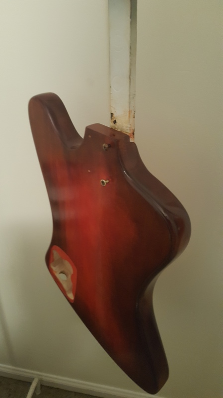

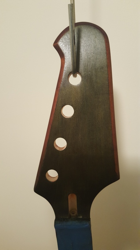

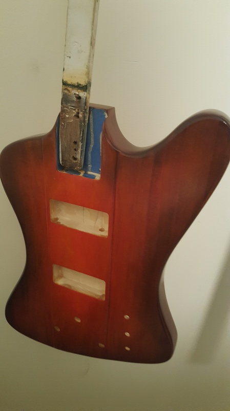

    Some Tru Oil rubbed in and wiped.
    Today I gave her a good soak of Tru-Oil on the body and neck....essentially kept applying it until no more would go in.
    Then I wiped off the excess and had to do some more work on the neck....but the body got two more rubbed coats.
    Let her hang for a couple of days now....and then see what we shall see.
    Wokka....I made the bevel one millimetre wider on the side and the top....so I suppose 2 millimetres wider.
