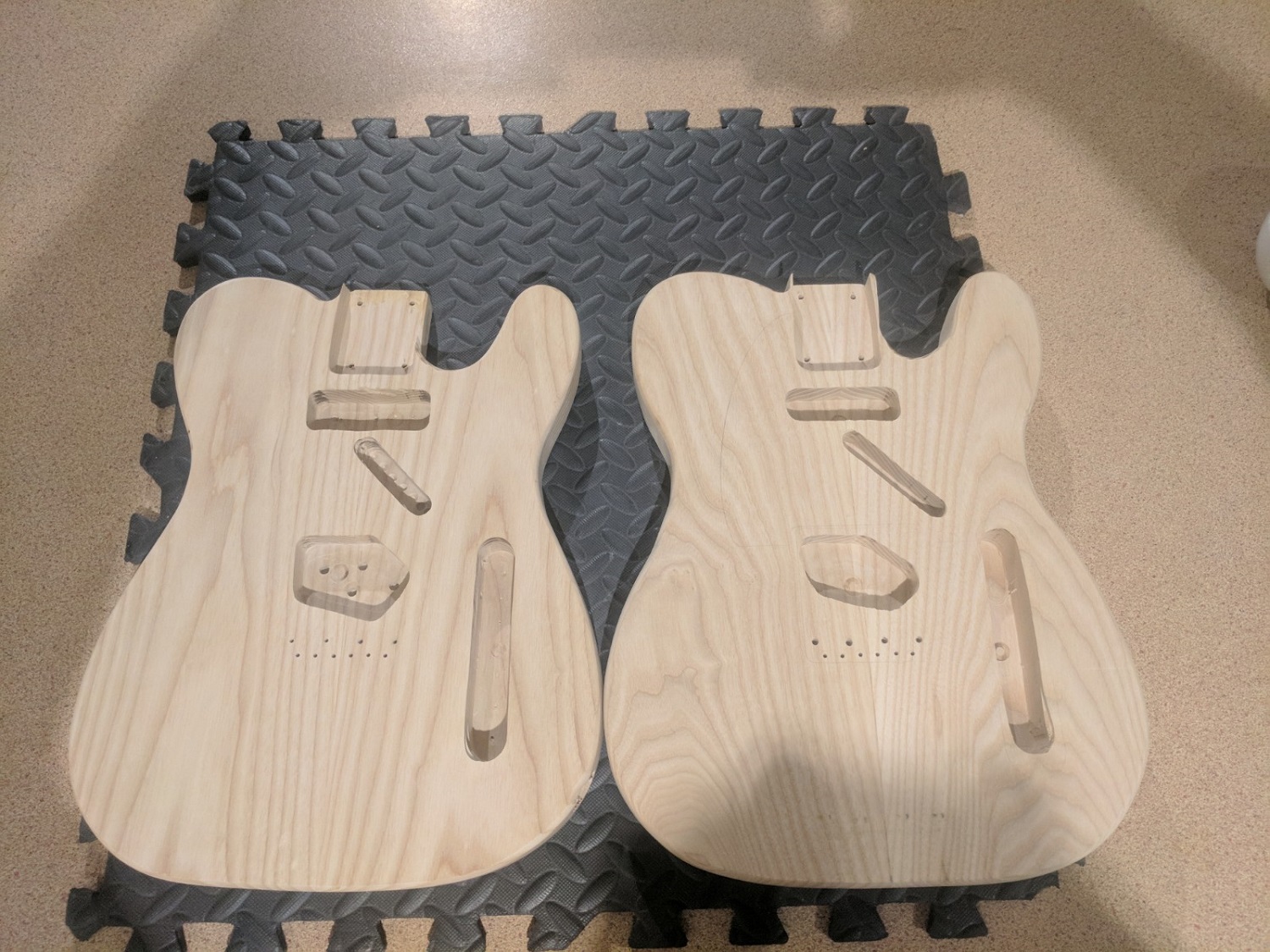

    Here are just some shots of the build so far

    Whats that! two...yes..... I'm making two

    awesome work Andy, they both look tops. Does the left one have a P90 neck and the other a single ? If you want to do away with a pickguard you can drill the neck pup wires straight down the centre via the neck pocket. You have been a busy boy. How much more fun are scratch builds ? You have 100% of the input on the entire body shape/cavities etc
    Have you drilled the jack holes ? They are quite long. I use a 22mm spade drill. You don't have to drill the hole length. Just needs to be deep enough for the jack. I just drill a 10mm drill for the wires once deep enough for the jack lugs
    Its pretty cool Wokks. they will both be single coils and with scratch plate. I just routed a bit more for weight relief. The American White ash is HEAVY.
  5. #65
    cool. I don't mind heavy axes. I reckon it may help the sustain a bit. Alot of my scratch bodies have been heavy but have a nice tone.
    Badass
    I agree, those two Tele bodies look great, now I know for sure that I'm going to have to have a go at building a Tele soon.
