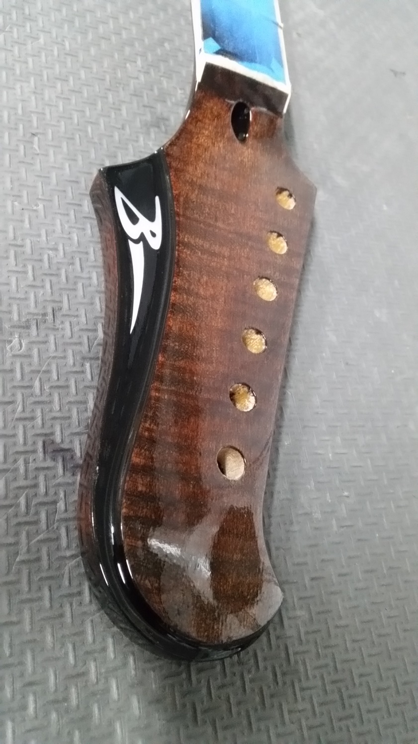

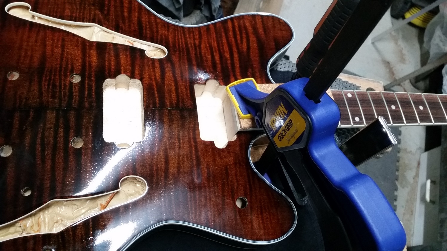

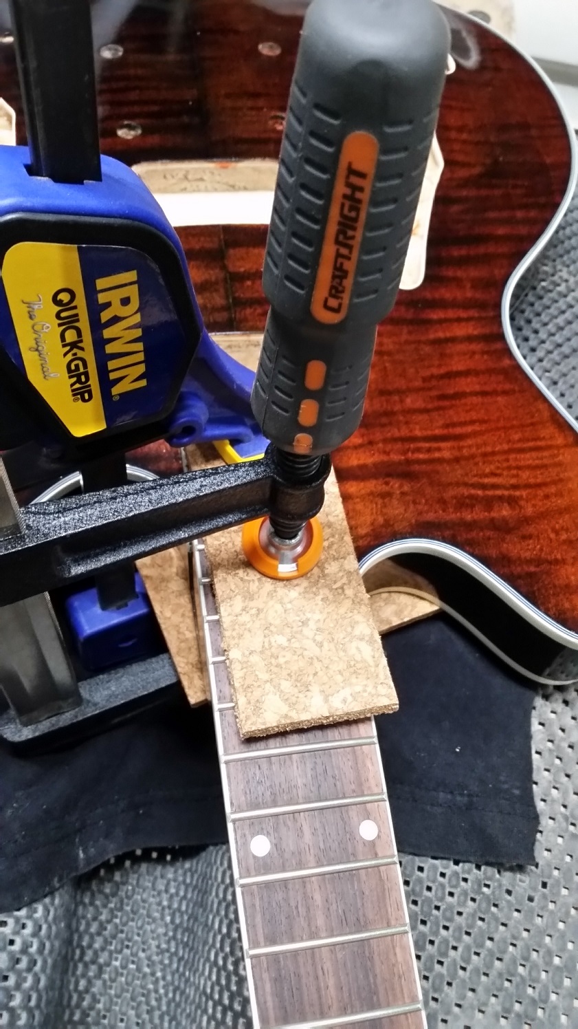

    So this happened today
ID:	28393Click image for larger version.

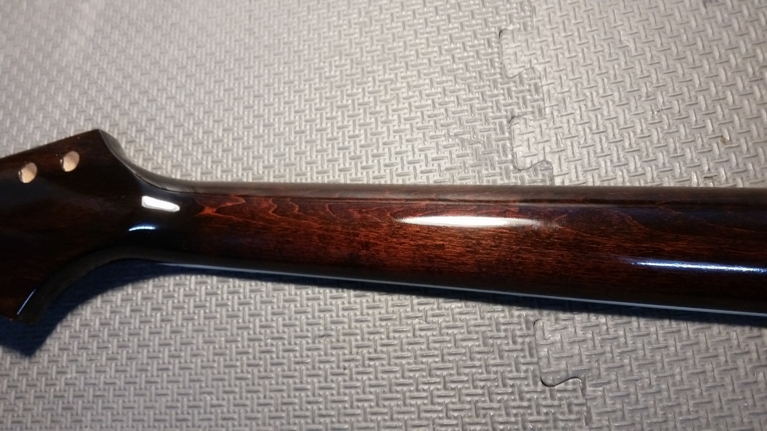

    But before that the neck had been sanded and given another four coats of clear.
ID:	28395Click image for larger version.

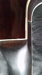

    Been a while since an update so here we go.
    The back came out a lot lighter than the front and the more I looked at it the more I thought should do something about it. Sprayed clear tinted with black to try and darken it a little, was a bit cautious and could have gone a bit darker but it was enough to tame it down a bit. Not the best pic but you can see the difference on the binding where started cleaning it up.

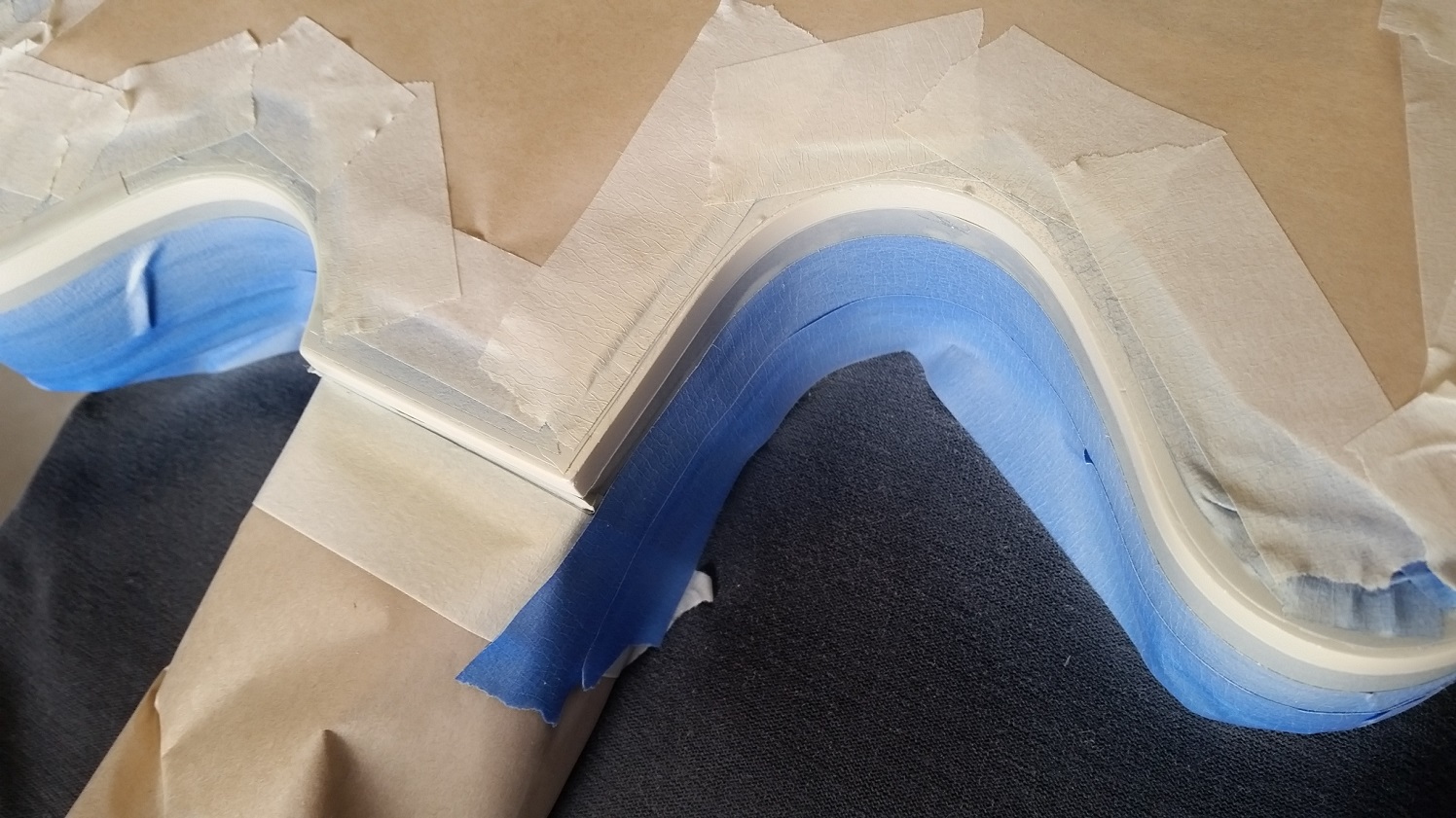

    Did try to mask the binding with vinyl tape, about 1mm of binding width and tight curves didn't work well and ended up brushing on liquid masking fluid. Worked great apart from where the solvents from the clear went through it and softened the painted binding. Then had to mask up and repaint that part.

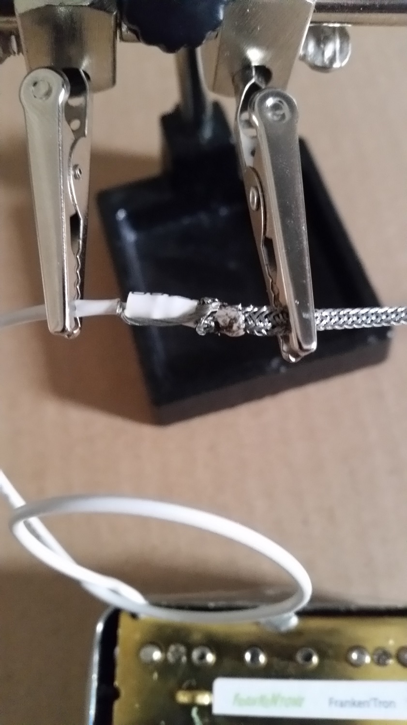

    Started the wiring by extending the wire from the bridge pickup in the hope of keeping it all neat when finished.

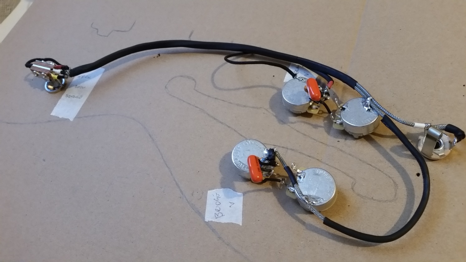

    Wiring harness done, used heatshrink to keep it in shape and also if it ends up being seen then won't be as noticeable as the braided wire.

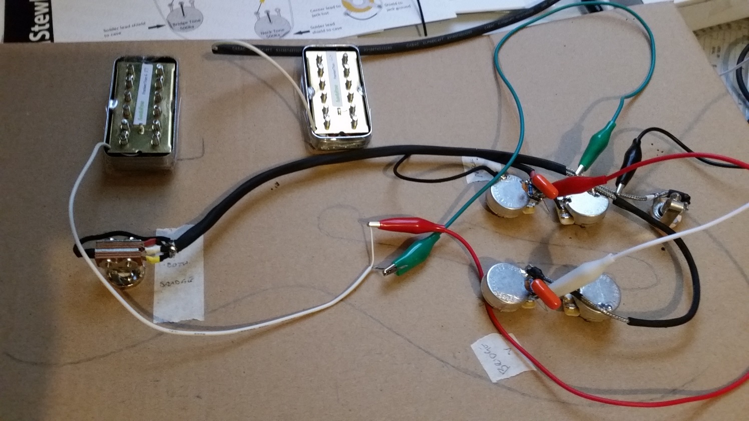

    Clipped on the pickups and it passed the tap test, volumes work, all good.
    I have used full size CTS pots and they fit into the f-holes fine....individually. How they will fit now they are all wired together with orange drops between them may be another story. Could end in tears, or therapy, or both.
