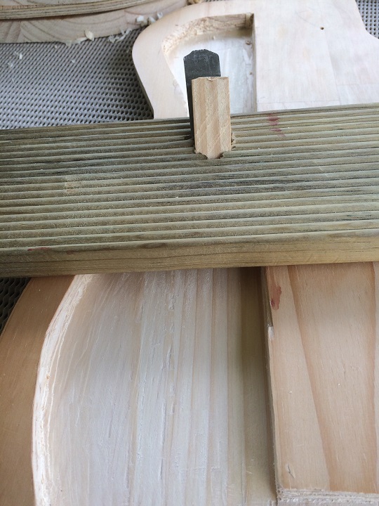

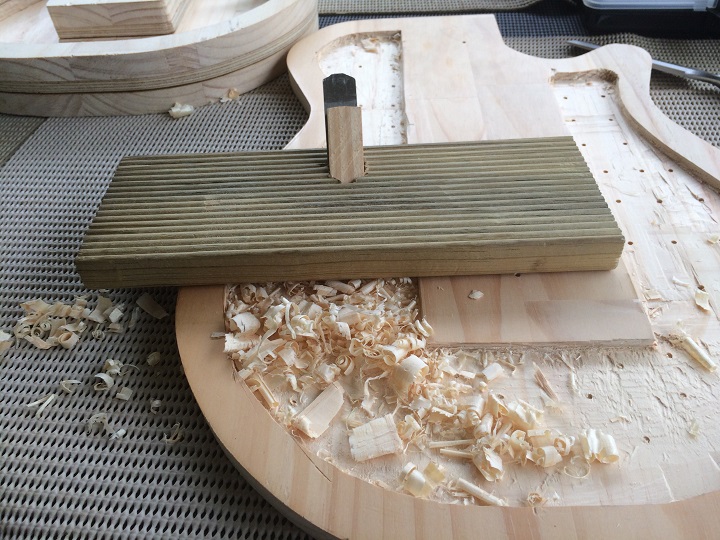

    Then out with the “router plane”

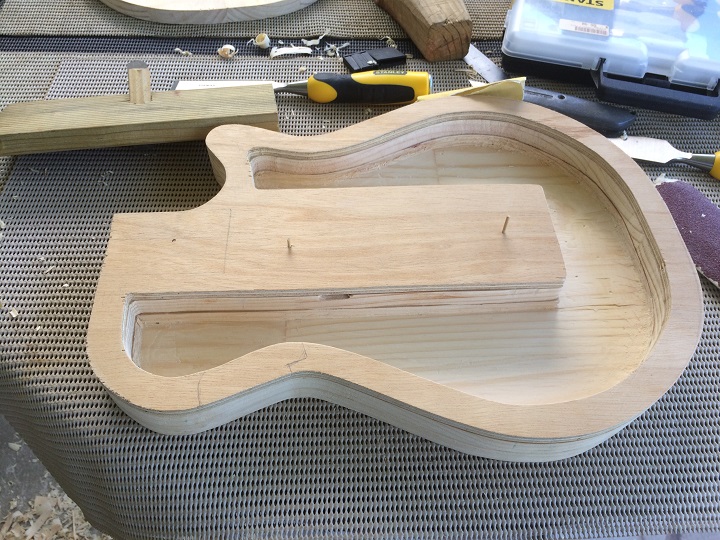

    The finished job
    It is still rougher than I would have liked but as this is only my first attempt and will be unseen inside the guitar it’s good enough for now.
    Next job is to make sure that I have all the internal routing for the wiring figured out and the cut-away for the piezo control unit sorted. The piezo is for an acoustic guitar so it is a bit tricky to mount into the solid part of the body. Once the body is glued together it will be hard to work on, so I have to make sure I have not forgotten anything.
    It doesn’t look like much but I have spent nearly 30 hours just on the body so far so now I am thinking of adding an “f” hole. I’m not going to spend that much time on it and have nobody notice that it’s hollow. Lol.
    Now to think up a good original “f” hole design that suits the guitar.
