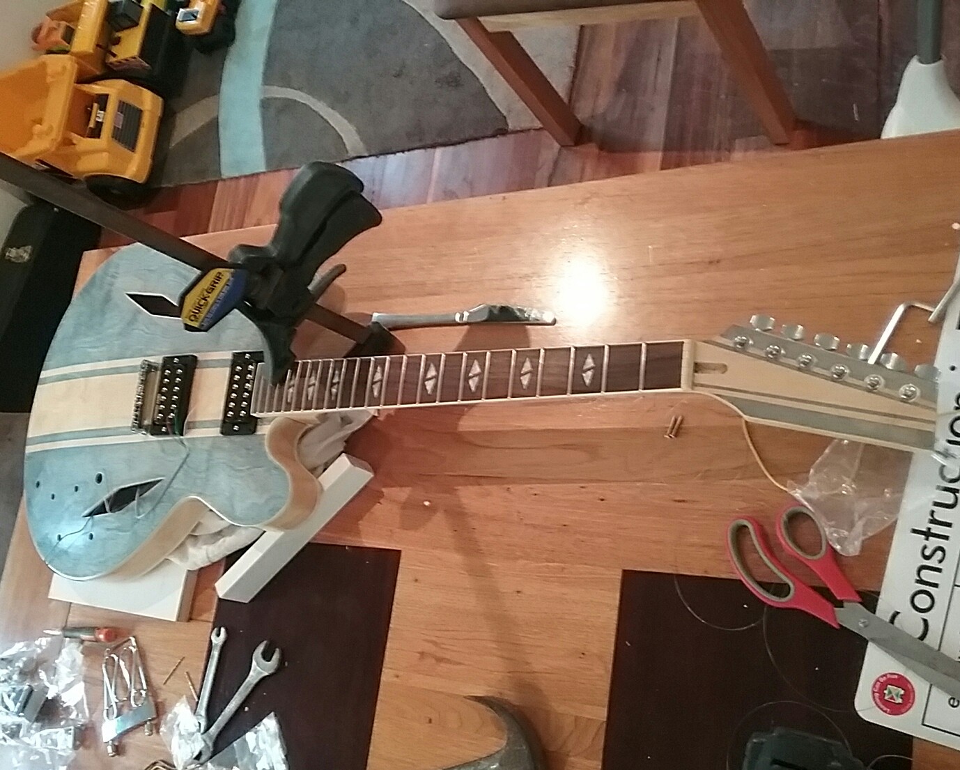

ID:	18133i got sick of waiting for the rain and humidity to go away to do the final coat, so i decided to glue the neck in and fit the tuning pegs, bridge and pickups, ran fishing line on the 2 e strings and all lined up good, i had 313 mm nut to crown 12th fret and 314 to the bridge on the small e string. Hopefully ive got it right ? The wife wasnt too happy about me using the dining table as a work bench

    Hey Adam, looks good. Your measurements are they from the crown of the 12th fret to the saddles and are the saddles wound all the way forward ? a G type scale is 24.75" = 628mm so 12th fret to high E saddle should be about half that ->314mm. The low E string will need to be further back to make up for the string thickness so it will end up being about 317-318mm, will the low E string saddle move that far back ?
    Also just double check front side of nut (FB site) to 12th fret crown is about 313/314mm

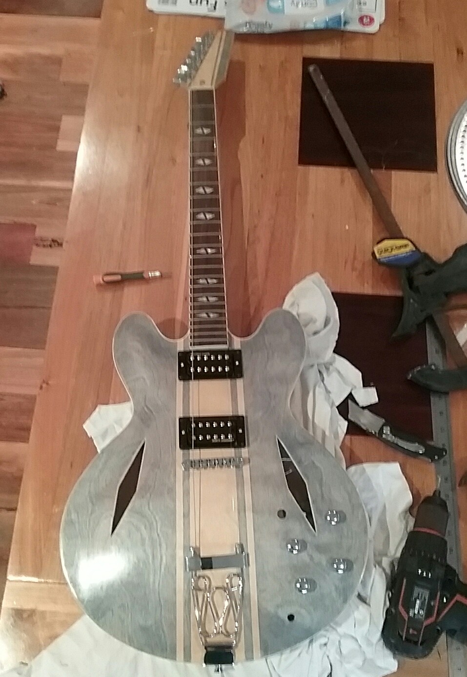

ID:	18134ive got 313 from face of nut to crown then 314 crown to bridge high e and 319 crown to bridge low e there's still a bit of movement both ways
  5. #65
    cool that should be fine to intonate Adam

    Thanks wokka ive been worried since i did it that i had it wrong

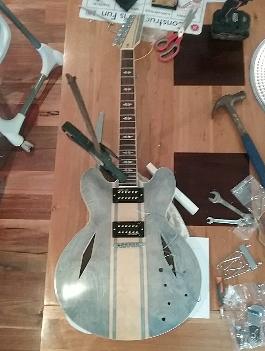

ID:	18147to wet for work today so took the cramp of and put the to e strings on at a very light tension i think ive fluked it the gaps from strings to edge look the same both are 4mm at neck joint. The bridge probably needs to come up little bit. so far all good
