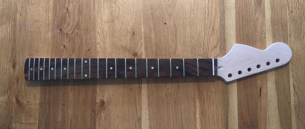

    This one is a bit different: a N1M diary. Yep, that’s a neck from PBG – a maple strat neck. The rest I’ll be making up as I go along. I know, a bit cheeky, but a “kind of” Pitbull semi-scratch build nonetheless. The first step is the body, and after seeing Gav’s scratch pine body I’ve decided to do the same. In a highly controversial move, timber has been sourced from the Big Green Shed in the form of their 90mmx45mmx1.2m and 70mmx45mmx1.2m dressed pine lumber. The reason for the two sizes is that I’ve found the narrower ones are easier to find with clean grain. After trips to two locations and searching through at least 30 lengths of timber, I ended up with bunch of timber at between $9.50 and $12.35 a piece.

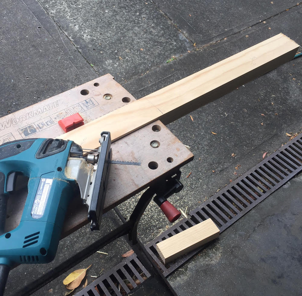

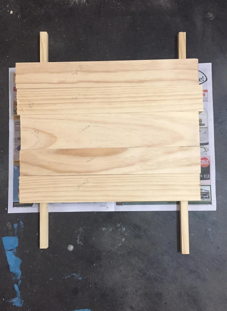

    Prior to cutting I layed out the timber to check for any twists etc so I could roughly work out which bits work best next to others. Once that was sorted I marked each piece (middle, top 1, top 2 etc), and cut them up (jigsaw only just coping with the 45mm depth).

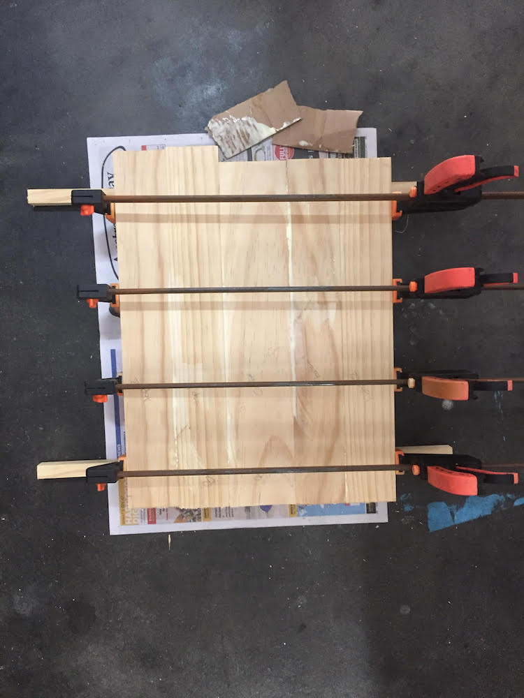

    Time to glue and I dragged out an old set of 4 trigger clamps and a couple of small pieces to lay the others on. I then used Titebond (cheers Andrew!), using a piece of cardboard (from a PBG kit box no less!) to get a nice even coverage. Then put them together and put the clamps on. And that’s where the first issue raised its head: the clamps were old and the triggers not working too well. I thought I might be screwed but managed to get just enough tension to squeeze the boards together. I’ll be going on to eBay shortly to get some pipe clamps!
Name:	260117 glued and clamped.jpg
    And that’s where we sit. I’ll leave it 24 hours to dry and then start preparing the blank.
