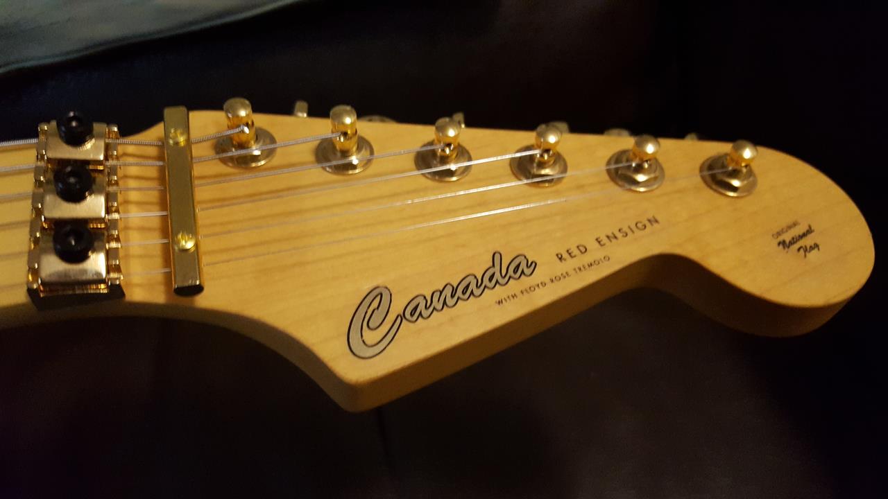

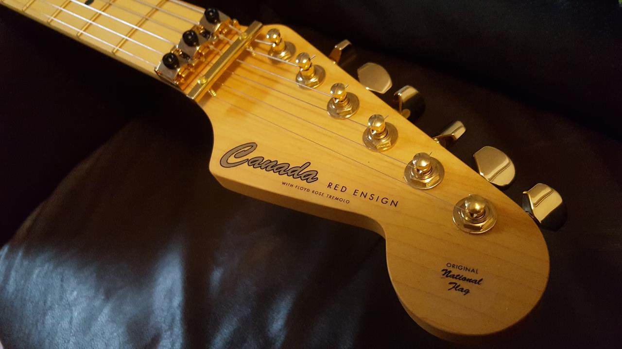

    After a long period of procrastination I finally got around to installing the string retainer bar on this guitar. During the build hiatus I went and ordered a custom decal for the headstock to tidy it all up.

  7. #67
    that really finishes it off nicely. Bravo!
