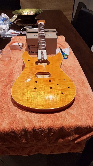

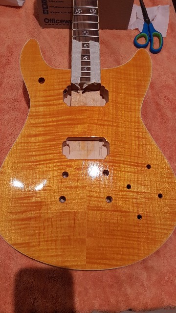

    Finally got my final DT stain coats started... just the top coated so far but looks great... to me anyways.
    Do you rub back a little with final DT coats?
