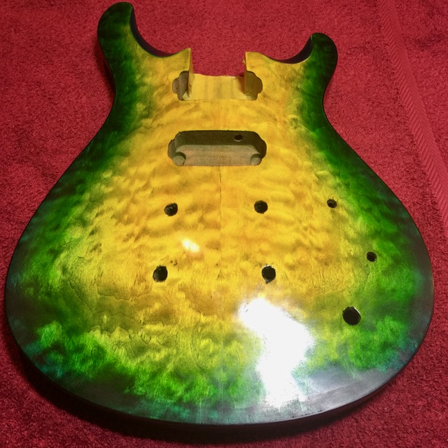

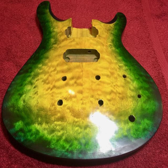

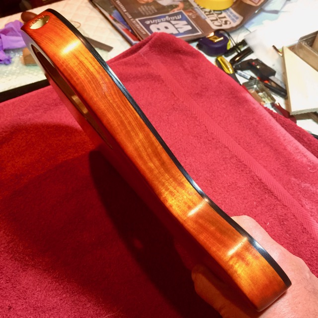

    So another hour of sanding and an hour of rubbing oil. I'm using the U-Beaut Aussie Oil and it goes on fairly well. Not sure how long to let it set before I steel wool it and apply another coat. Any advice?
    I'm fortunate that my wife and daughter have gone away early for Christmas leaving me at home to eat macdonalds, drink beer and rub my guitar.

    On the headstock... I now realise what you all are saying. If I don't move the holes to align with the re-shapped edges, my tuning knobs (or whatever they're called) wont line up with the sides. I'll have to see how it looks and may need to move the holes.
