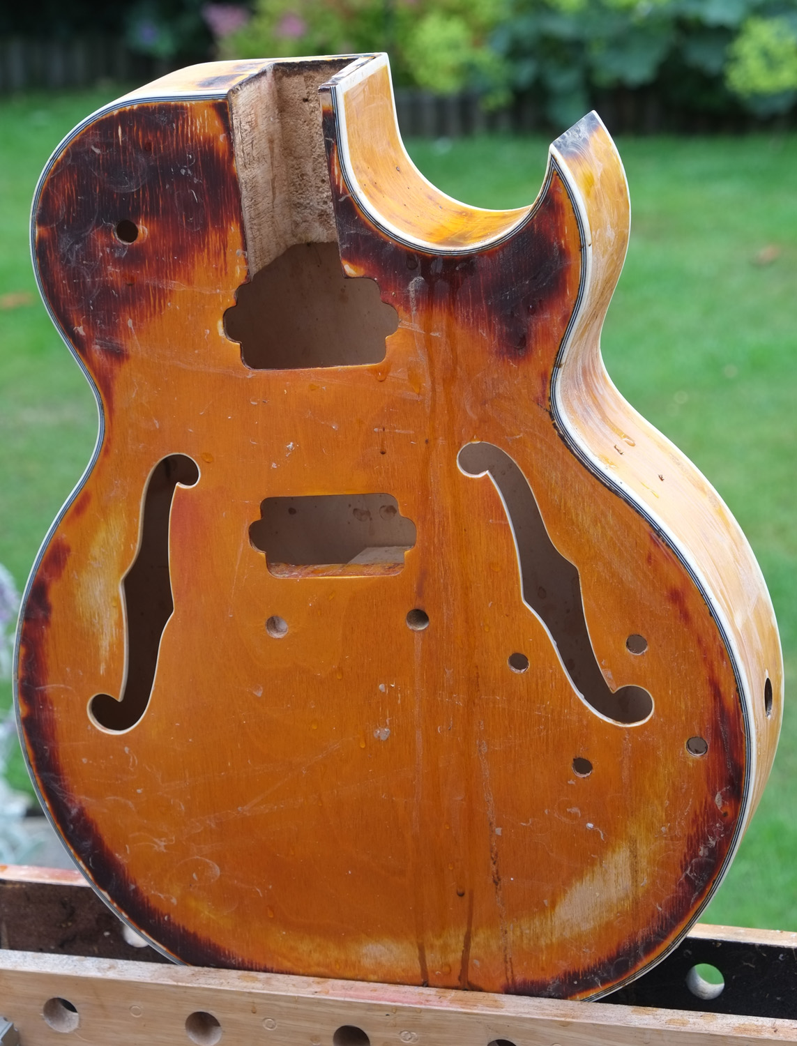

    There once was an ugly duckling...
Name:	6th May small.jpg
    Getting there. Weather isn't conducive to working outside at the moment. Heavy rain all morning and/or very strong winds. Occasional sunny periods but then rain again.
    I'm off on holiday next week, so I won't start any repainting until I come back. But I should finish getting it stripped down before I go.

    Oh my.... It looks as if it has been used to light up the bonfire! I see tears coming down...

    Oh my goodness... well I am sure you will remember this build for a long time and you are better than me because I probably would have chalked that one up to a learning experience and gave up, but you will make it shine I'm sure.. have fun on holiday..

    yeah Simon...ive got tears reading through this thread and finally seeing your last picture.
    mate, there is always the solid colour option. dont quit. as all of the other dudes have noted before me - youre one of our most knowledgeable dudes here.
    and a holiday will probably help clear your head and give you the space you need to attack it when you get back.

    What a shame you don't want a relic-ed guitar (understandably). It looks like a 50 year old guitar that has been through the wars.
