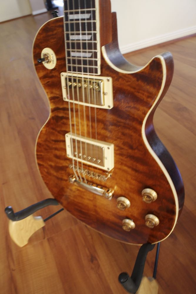

    Yum BMB! It looks like a gold tiger!

    Here goes my second ever entry in to GOTM competition.....This one is an LP1-MQ with gold bits and bobs.....
    Started by cutting the headstock and very cautiously sanding the quoted maple as to not sand through.....
    Then (Sorry DB) i used Feast and Watson's Golden Teak and Red Jarrah stains.....Naughty Oil finished....
    Upgrades include Graphite Nut, Vintage Tonerider Pups, Gold Grover Tuners, Cream Treble switch and Pup surrounds.....and some strap locks.....
    Really enjoyed the build and the confidence is growing with every bit.....
    Anyway, can i say some fantastic efforts this month and i am glad to be in the mix....
    Attachment 10763Attachment 10764Attachment 10765Attachment 10766Attachment 10767
    Still looking for a gold bolt on neck plate
    Beautiful finish!

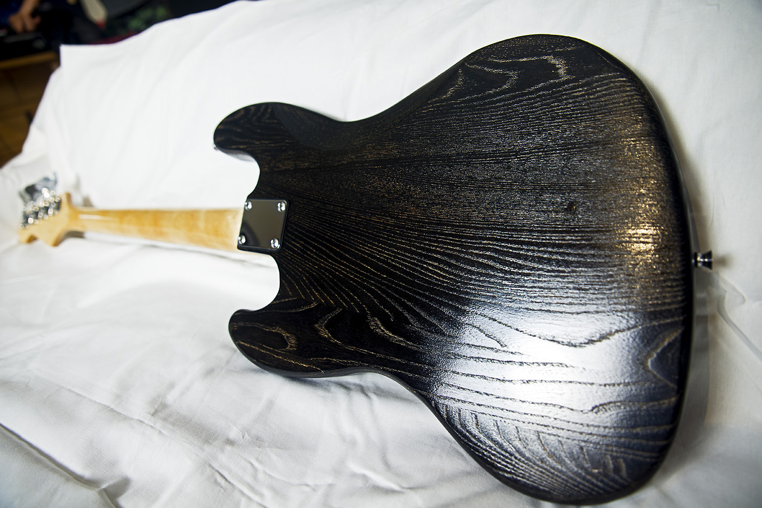

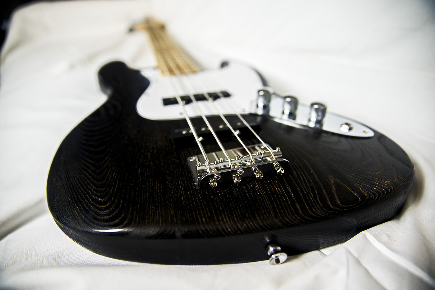

    newbie, second build.
    Ah what the hell, here's my JBA-4 kit finished, Ash body and all stock except for the Entwistle pups (which sound great BTW). Rubbed in black stamp pad ink a half dozen times then 5 coats of clear gloss over the top to let the ash grain come through, Dingo wax for the fretboard. It's my second build and certainly won't be the last.

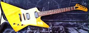

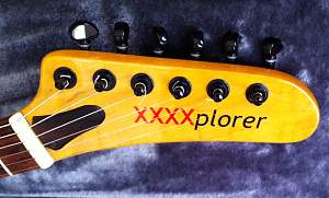

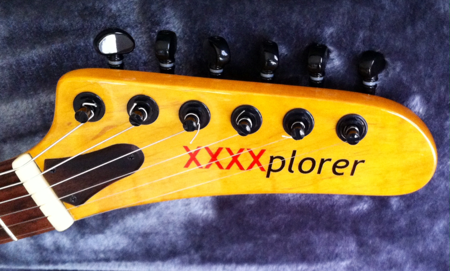

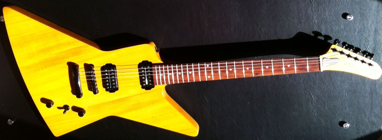

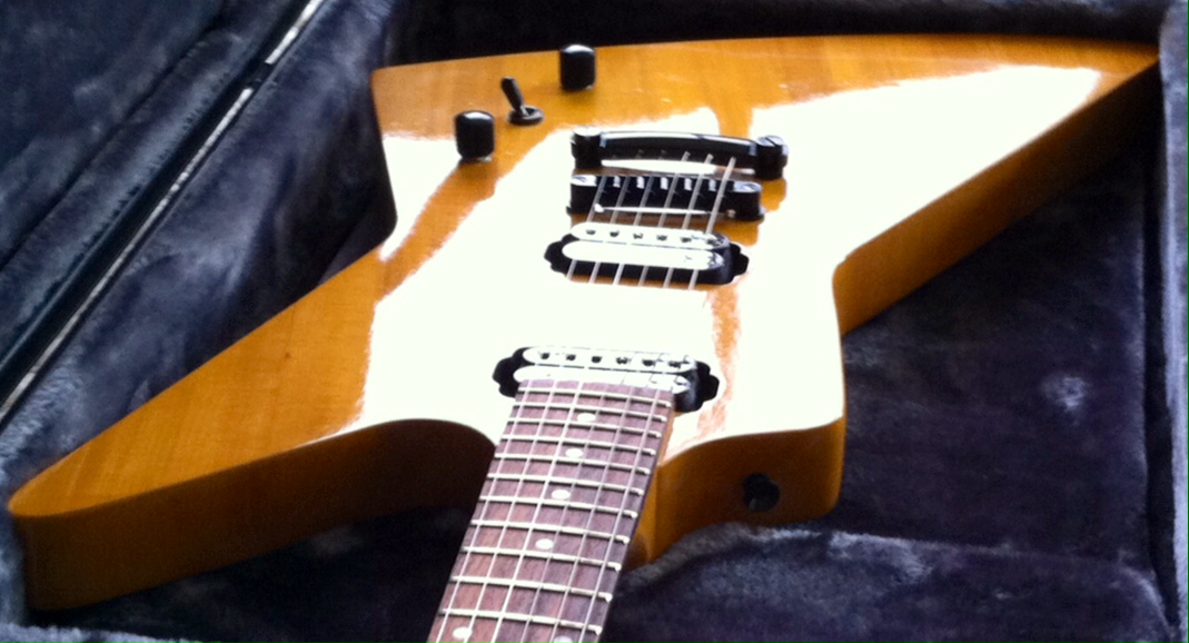

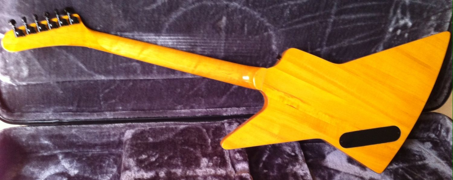

    EX-1 finally done.
    Been a long time getting this one finished and below I have listed all the mods and upgrades:
    5 Coats Dingo Tone Coolangatta Gold Base Stain
    5 Coast Dingo Tone Coolangatta Intensifier Coat
    20 + (maybe even more) coats of Tru Oil
    Dingobass Bone Nut and Neck Setup - best investment anyone can make. Awesome job and many thanks DB.
    2 x Bourns 500k Audio Taper Push Pull Pots - one used to split neck PUP to slugs and the other to split bridge PUP to screws
    Set of Tonerider Alnico IV Classic Vintage Voiced Humbuckers
    1 x Sprague 0.022 Orange Drop Tone Capacitor
    1 x Fidelity resistor & capacitor volume control upgrade
    1 x Gotoh 3 position switch
    1 set of Grover Locking Tuners
    1 x Rosewood Truss Rod Cover
    Dingo Tone Wax used on Rosewood Fret Board & Truss Rod Cover
    Cat music Conductive Shielding Paint
    Epiphone genuine Explorer Hard Case
    Only standard parts used were the Bridge, Tail Stop, Strap Buttons & end jack plate and 1/4" socket as too hard finding a black retaining nut for a switchcraft one as threads differ.

    That is a wicked black there GenX Dave. And I'm quite fond of Waz's stripped back EX.
