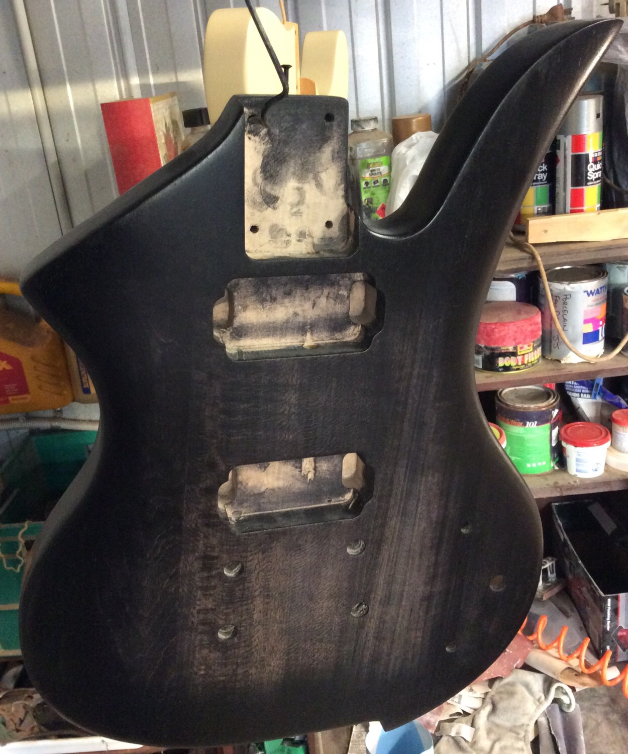

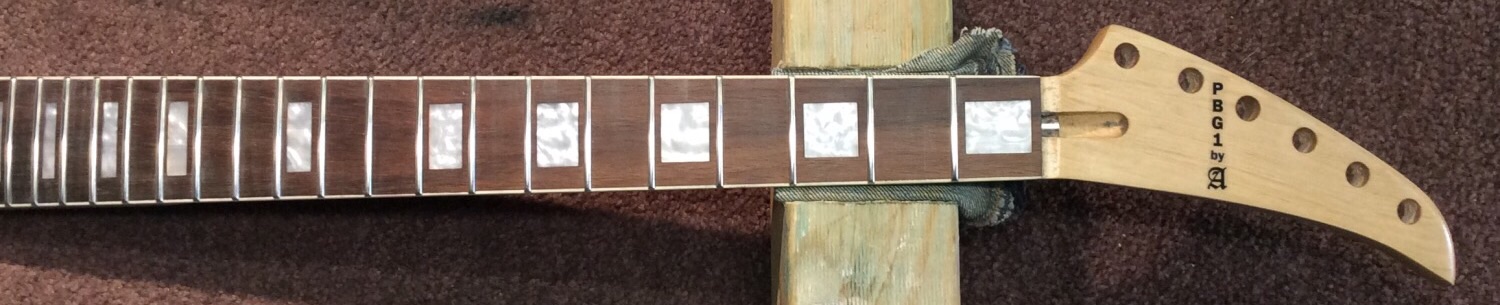

    Not much has changed visually, but everyone enjoys picture updates.

    The neck has one good top coat on after having to sand back, the body has its first top coat.

    Loving that headstock.....looks great.
