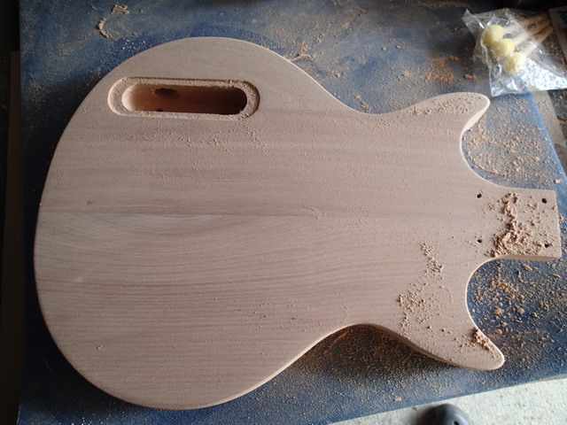

    Sooo been a busy boy servicing my camper, cleaning up the car and all those other horrible jobs associated with going away on holidays.
    Wife decides to have a nanna nap so i snuck off into the shed for some serious mens business, sanding, woman are quite welcome to do my sanding for me, i dont discriminate
    The look on her face when she woke up and walked outside and here's me covered in hog dust, classic
    Into it with some 180, theres a few flaws in this body and i need to get stuck into them, i usually start with 220.

    180 works it nicely through the flaws

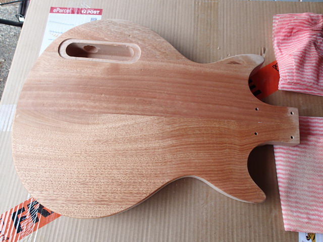

    180 done on the back
    You can hardly see this blemish now, it wont be there when i finish

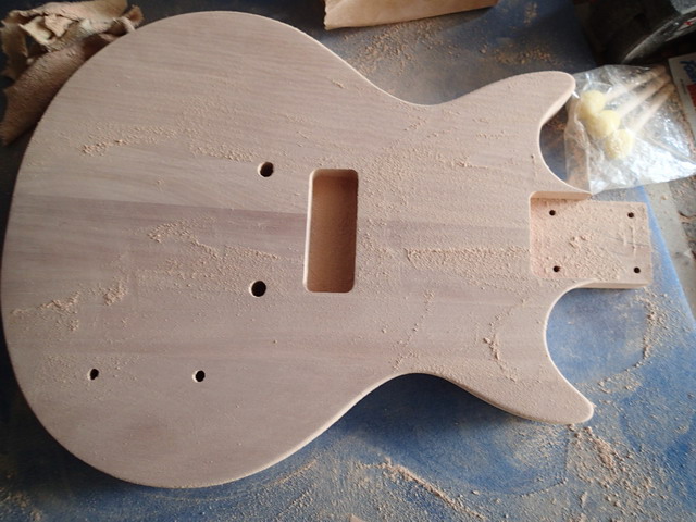

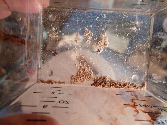

    Saving up all the hog dust i can get, i use it later if i need to fill.
    Plenty of it

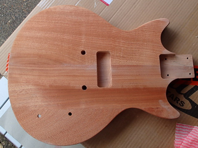

    The flaw is nearly out the 220 will get it

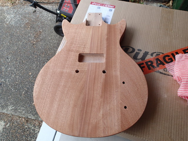

    Hit the top up
    Clean off with some Naptha, takes all the greasy dirty mits off.

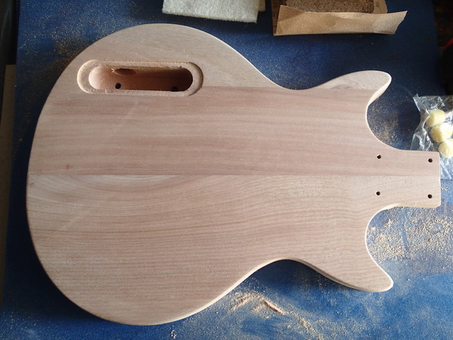

    Wipe the top down with naptha

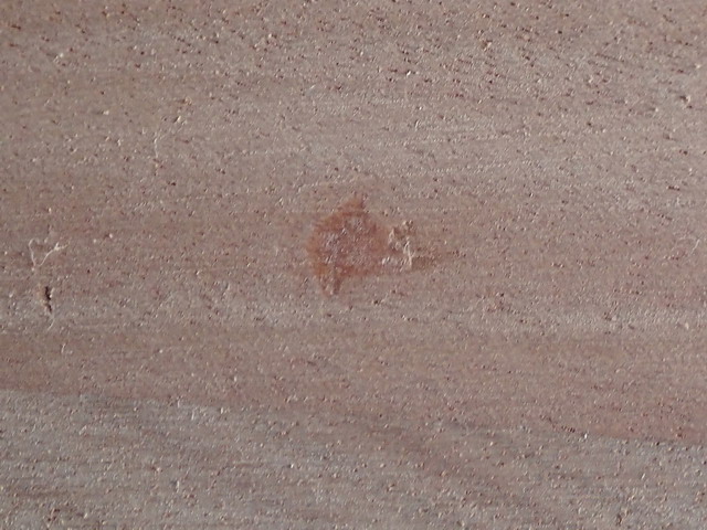

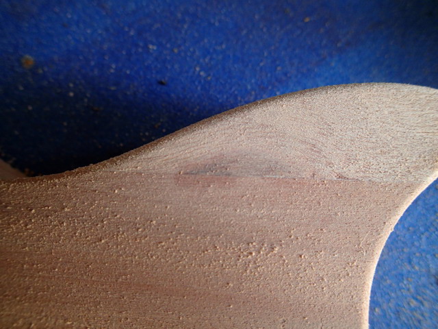

    Then i wipe it over with a damp cloth, and it show up the flaws, like that bottom bout i am hoping thats not a glue spill
    Better to find the problems before you start any finishing.
    Moderator dingobass's Avatar
    4,491
    Looks like glue.... Best sand that bugger out.
    Banned
    Dec 2015
    1,171
    Yeah mate i was thinking its glue, no escaping the crud.
