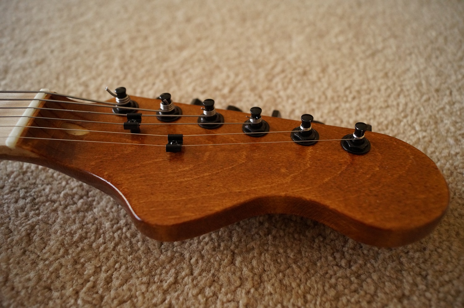

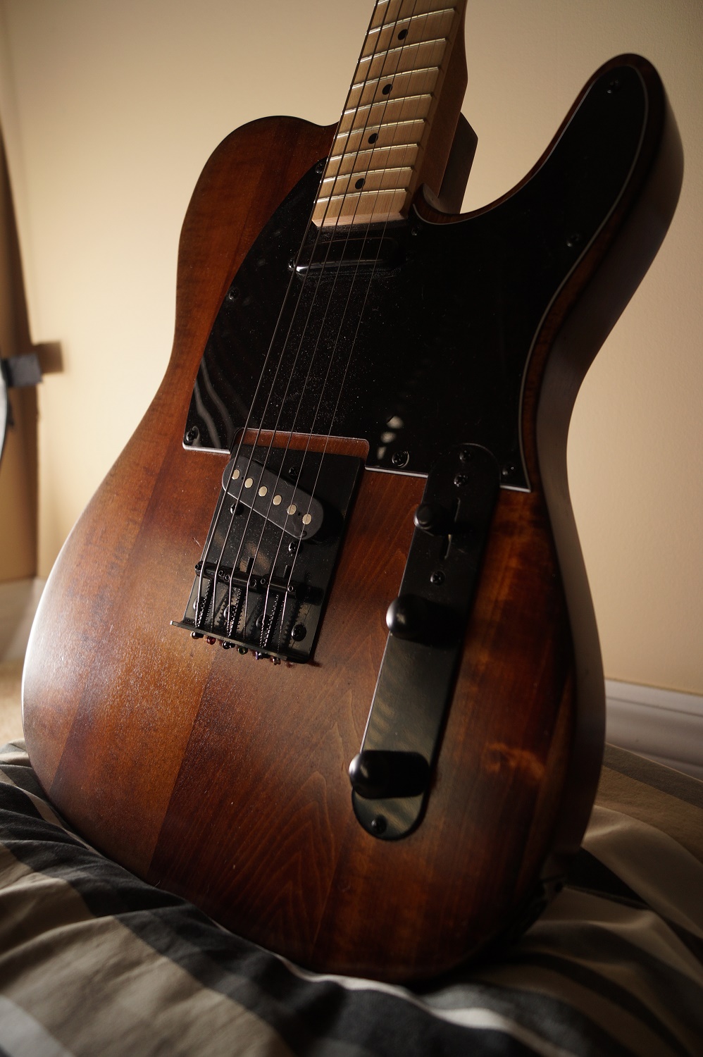

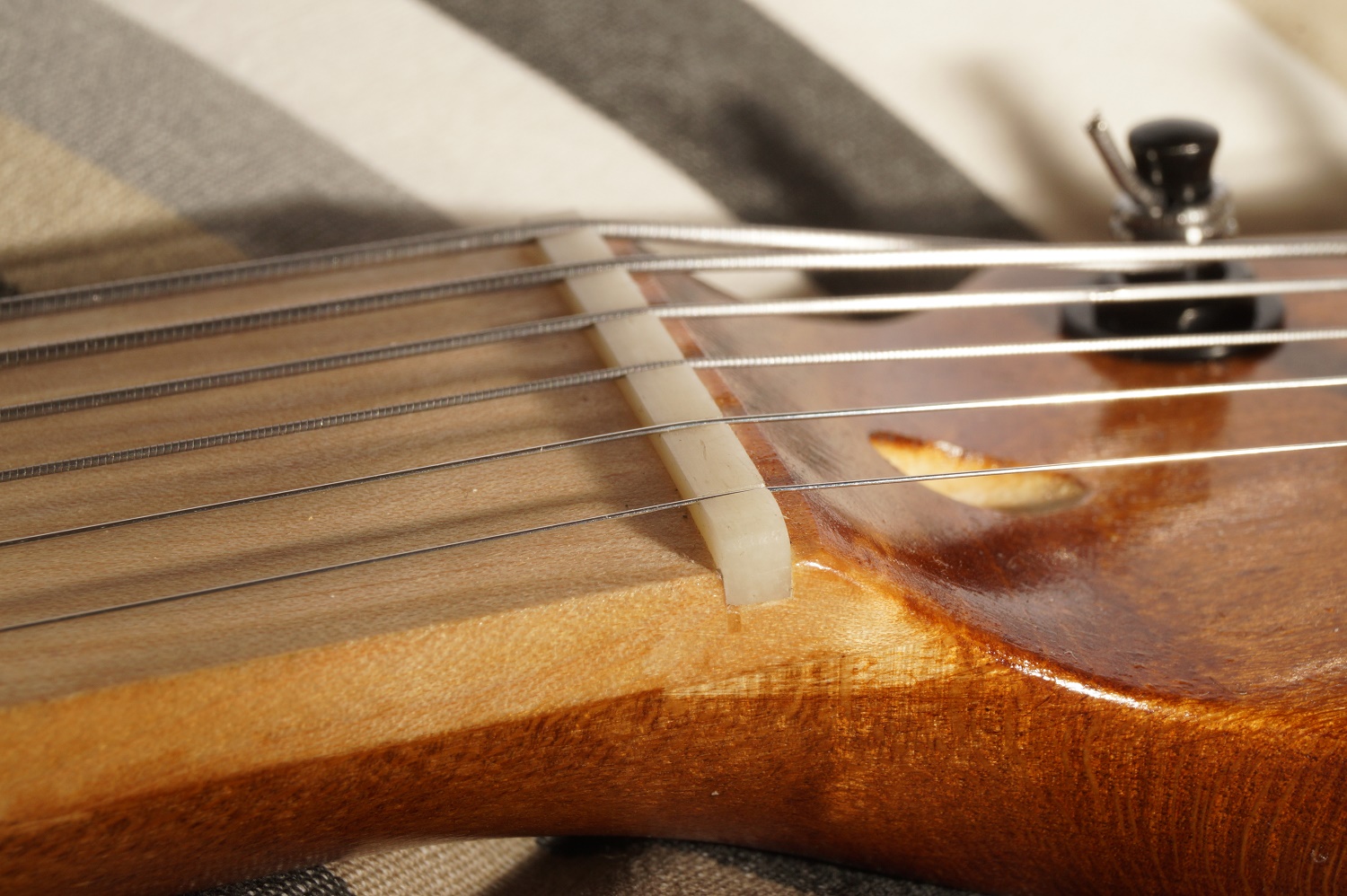

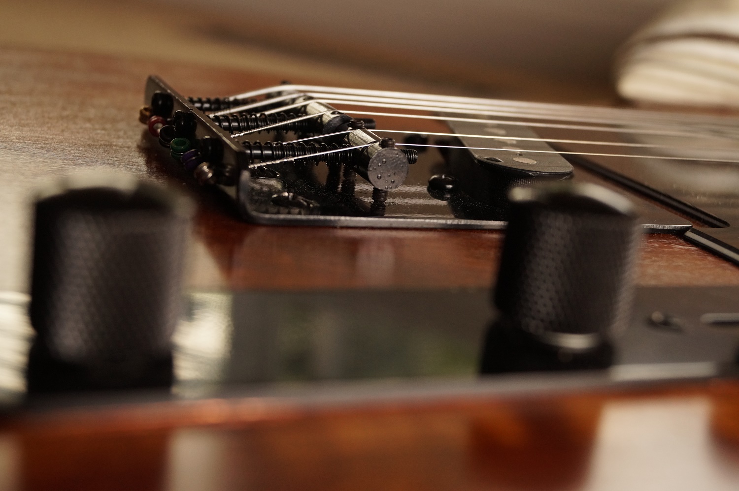

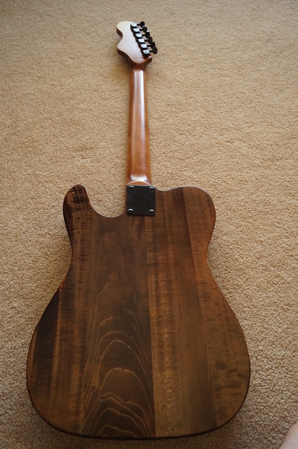

    Here are some shots of the finished kit (sans strap buttons - not sure if I'll put them on or not).
