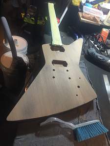

    not much going on...just hanging around...drying

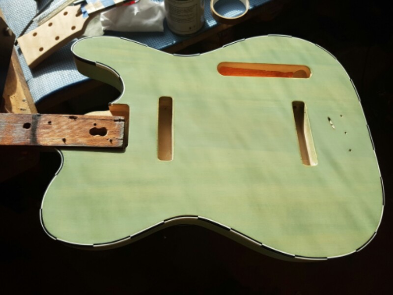

    I have had similar thing happen from either applying too much or over working the application..
    Let it cure for a few days then give it a swipe with 320 grit to open it up and give it some tooth.
    I only rub in one direction and brush the sandings off after each wipe, this helps to stop the paper glagging up.
    I also give the finish a light sand between each coat, this helps to level off any high spots and stray cat hairs...
    The pic is after 4 coats of the new Ocean Mucus colour, left for two weeks to cure then cut and polished..
    It is still a bit soft, so after I leave it alone for about three weeks it should be nice and hard and ready for the final buff up

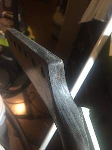

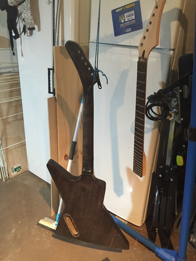

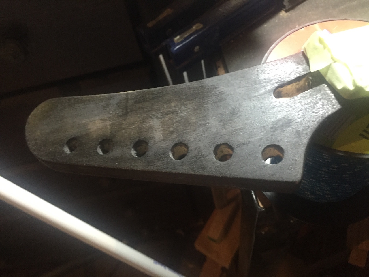

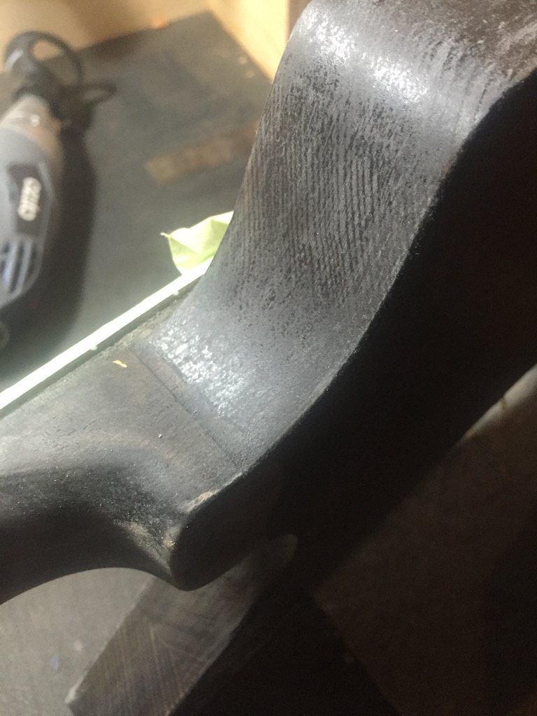

    Well as much as I was hoping i could bring it back, i have had to resign myself to defeat with my first DT finish.
    Overall it was patchy with some areas having a nice shine starting and others looking dry and rough. I had gone across it with some gentle rubbing back and re-finishing. cut way way back on the amount of final coat in the application but after 4 coats it just wasn't getting any better.
