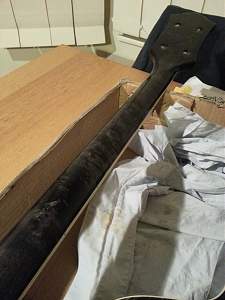

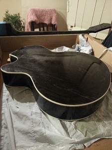

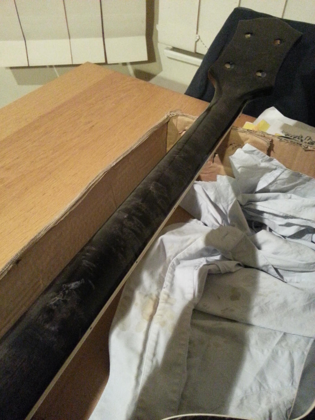

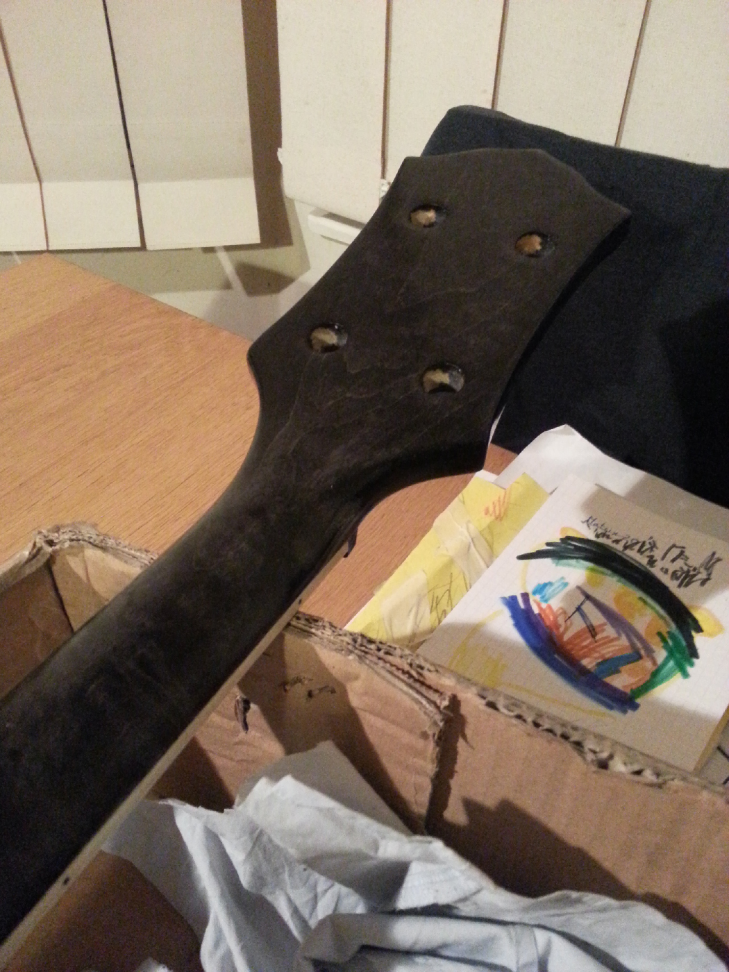

    it's been a while. progress has been really slow but steady.
    I have now reached TO coat 15. Did 2 TO sanding (one at 10 with 800 grit and one at 15 with 1000 grit). Loving the results but it's a patience game.

    It is starting to look great.
    I checked the frets' distance as well and everything looks good ( a whisker off in some places but nothing major)

    I reckon there is another 5 coats minimum. The head stock has given me problems on a couple of occasion when applying steel wool and sanding where I went right back to the stain in a couple of very small areas. So more TO it is...
