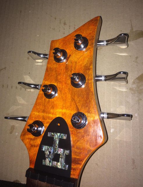

    The machine heads arrived today. Replaced the kit ones with some Gotoh chrome ones as the bridge change instigated a hardware change to chrome from black.
    Looking a bit golden in the afternoon sun there.
    Oh, and put a logo on the kit supplied truss rod cover. Cut some paua veneer and sprayed vinyl sealer over it.
    That's meant to be T VI, as in T 6.
    - Sam

  3. #63
    Jan 2013
    3,162
    T 6 as in Tilders 6?
  4. #64
    Quote Originally Posted by keloooe View Post
    Yes. There wasn't really enough room for me to put the full name like I did on the IB-5 or ST-1.
    - Sam
    IB-6S - done.
