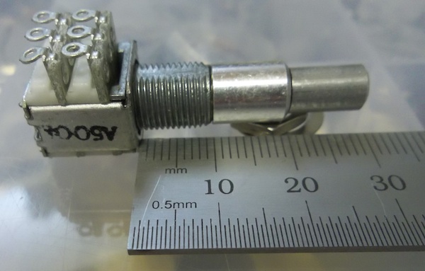

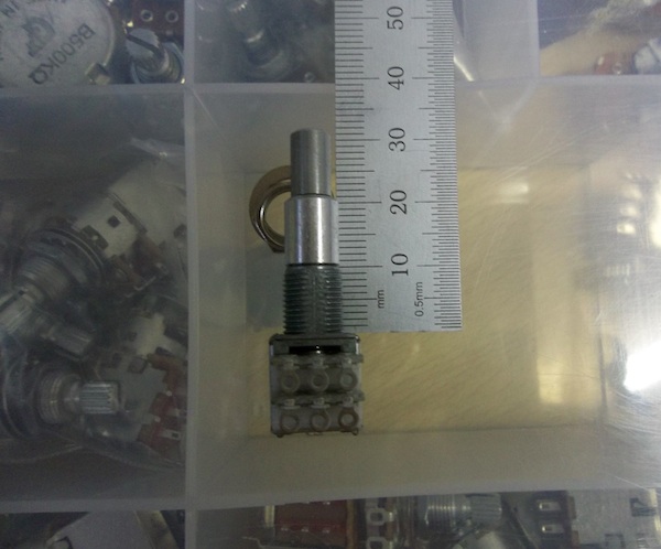

    Grabbed some pics of my Alps 500K concentric pots for you:

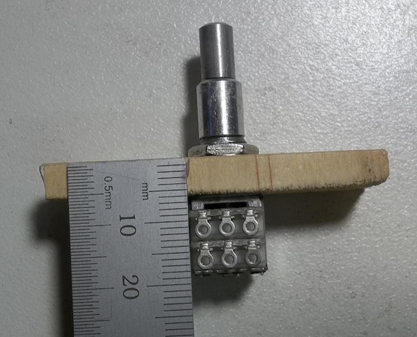

    And, just as a quick test, mounted on a 6mm thick strip of wood with a washer and the nut finger-tight:
    Same, with the knobs loosely sitting in place:
    Anything around 5-6mm or so thick should be fine with these pots, so I think they'll work with your JR's cavity.

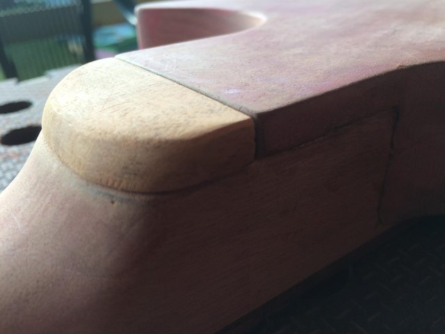

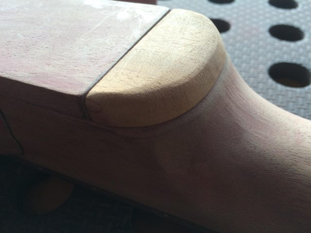

    Did more shaping on the filler bit today.
ID:	4859Click image for larger version.
    Held it in place and mimed playing up that end of the fretboard and once the transition is puttied up it should be pretty comfortable.
