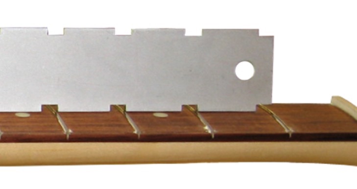

    Hmmmmm... Bit of a brain bender..
    If the neck is twisted you would see it by sighting along the neck but I dont think thats the problem.
    Grab a 600mm steel rule from the $2 shop and notch it to correspond with the frets, this will let you check the overall straightness of the neck.
    Pretty sure from looking at the pics and your description that your neck has a forward bow.

    Not your fault at all, if the neck has a front bow all you need to do is loosen the strings and tighten the truss rod.
    Usually if you tighten it so it has a 2-3mm back bow, when you tune the Guitar the string tension should pull the neck close to dead flat.
    Might take a few goes to get it right, but with the aid of your straight edge you should get it sorted

    Here you go Aidan make yourself one of these out of a 600 mm stainless rule as DB suggested. Sometimes building guitars can be frustrating , but you'll learn so much from this ready for any future builds . See pic attached

    You already have a ruler straight edge just notch it as per pic
