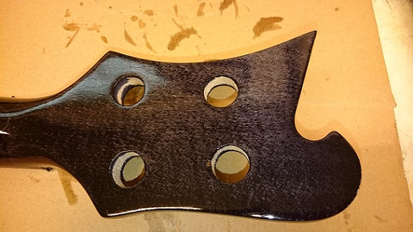

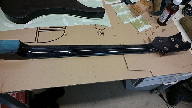

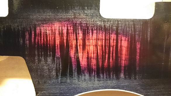

    So here are the pics I promised a while ago. Still the quality is poor because for some reason I have to reduce these to under 100kb.
    Anyway, the shot of the flaming was taken before the first TO wet sanding. I thought it would be nice to see this up close.
    Then for comparison pics of the neck from a far and up close so you can really see the grains and color. From a distance and poor lighting it seems almost black.
    On the back of the body there is quite a bit of flaming too. Didnīt flip on the top because the back is still in progress with the TO.

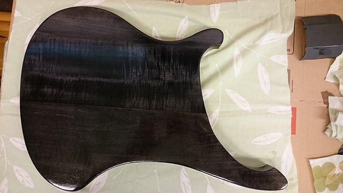

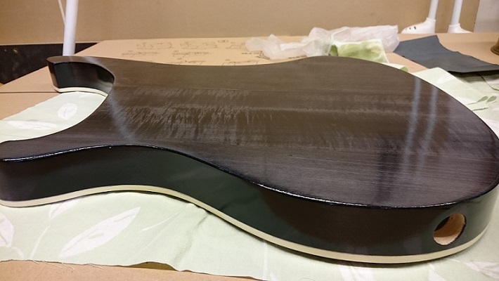

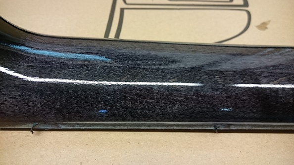

    And more pics to show
