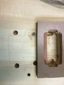

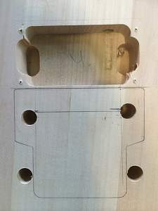

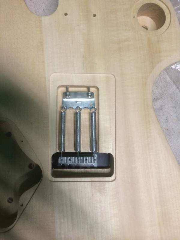

    as i said the girl went in for her routing to fit the floyd rose and boy did we have a few problems... lets work through it all...
    first of all we couldnt get exact measurements because as we foound, pitbull guitars dont have measurements with there kits or online ( that i could find anyway) so we had to work out the scale length and all other measurements of the guitar and just hope they were right, still have know way of finding out whether they are okay untill i put her all together again, were pretty sure we got it all right though. after figuring out our measurements, we finally managed to make some templates up
    here are some pictures of the cuts on just scrap pieces of timber.
Name:	1 test front.jpg
    front
Name:	2 test back.jpg
    back

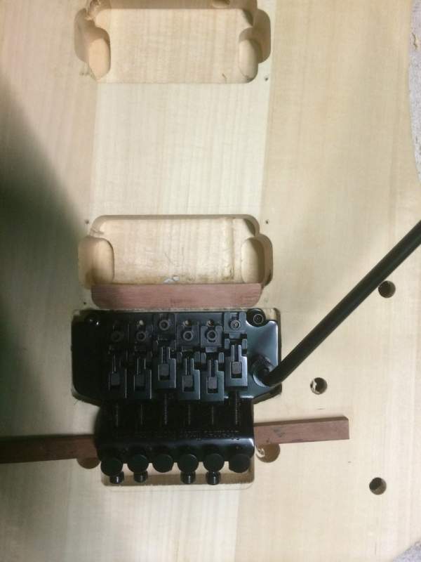

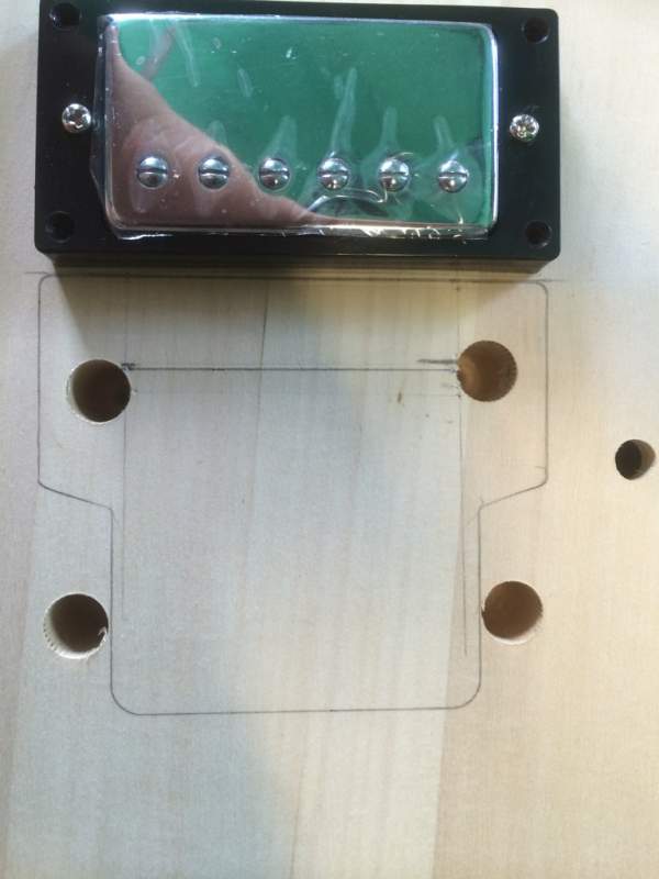

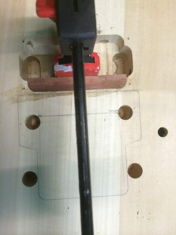

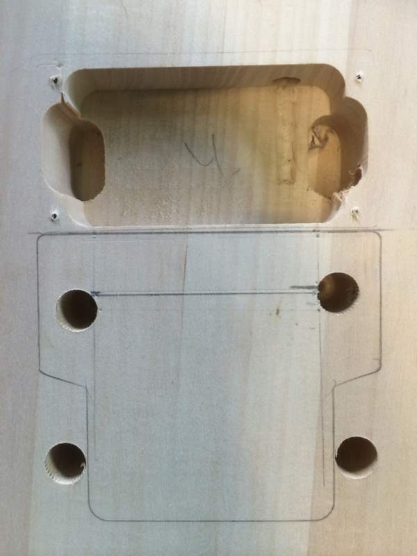

    then when we were happy with our cut we decided to do the outline on the actual guitar... take note of the gap between where the bridge will be and the where the pickup will be. you cant see the gap? thats because it is virtually nonexistent!
Name:	3 outline.jpg
    without pickup
Name:	4 outline w pickup.jpg
    with pickup

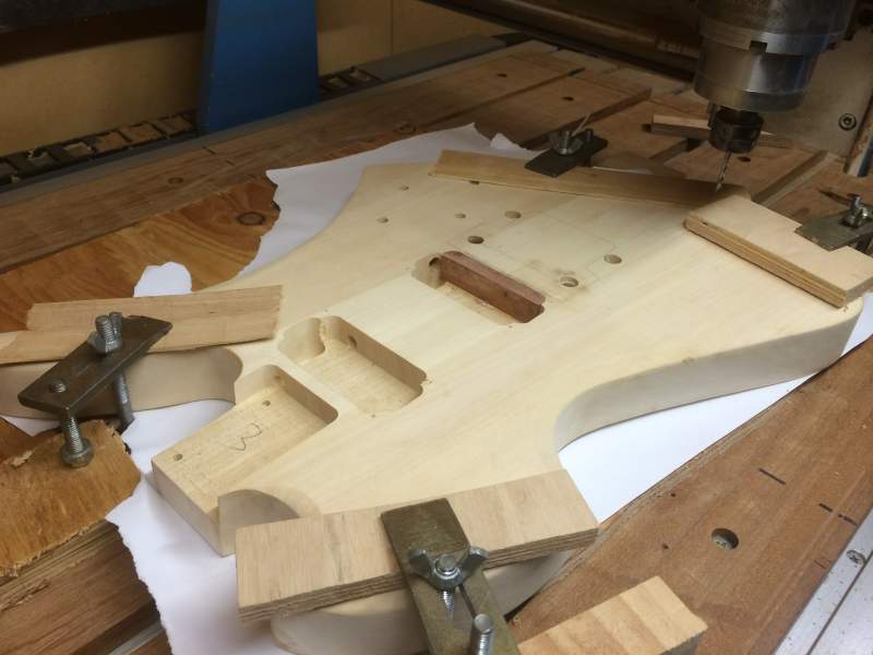

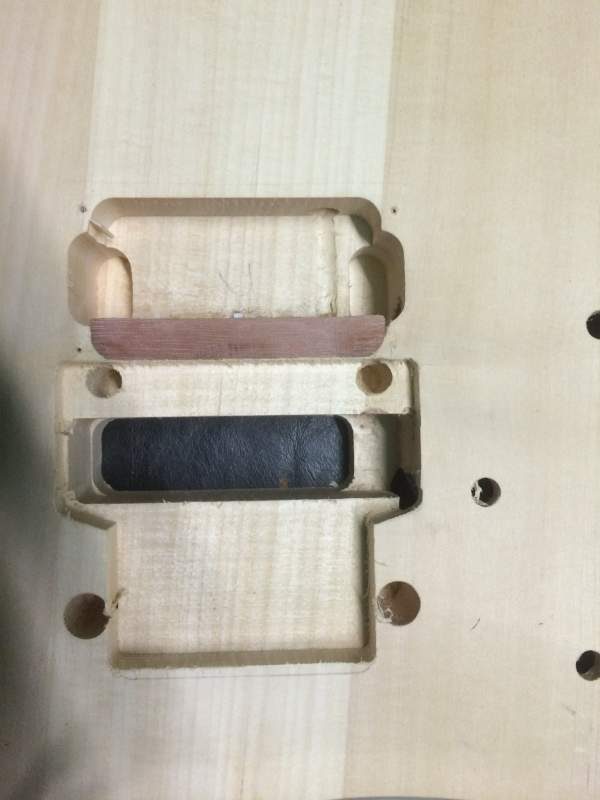

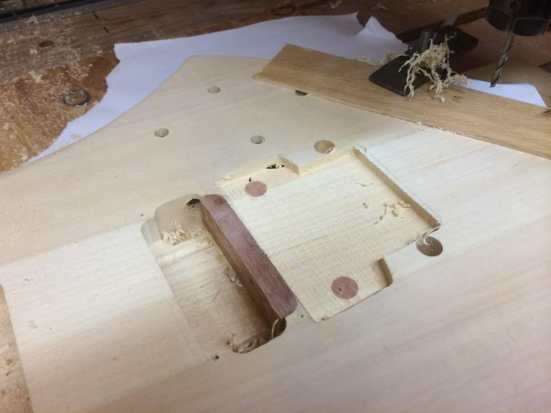

    that meant doing 2 things, option one was to forget the floyd rose and pay the guy 70 bucks for his efforts or.. option 2 was to move the bridge cavity forward 10-15 mil and chock up that pickup cavity. of course i decided to go with option 2. meaning i was going to have some patchy looking wood on it meaning the stain was going to end up looking like absolute crap. so instead of staining it like i originally wanted to, im going a solid colour, still probably a red. good thing i didnt order that custom colour from DB huh?
Name:	5 filling pickup cavity.jpg
    glueing in the filler
    For some things, some times, it's the same time all over the world, and I think we know what time that is...
  3. #63
    Jan 2015
    Brisbane, Australia
    186

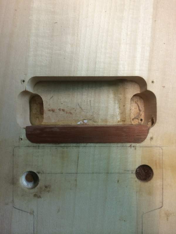

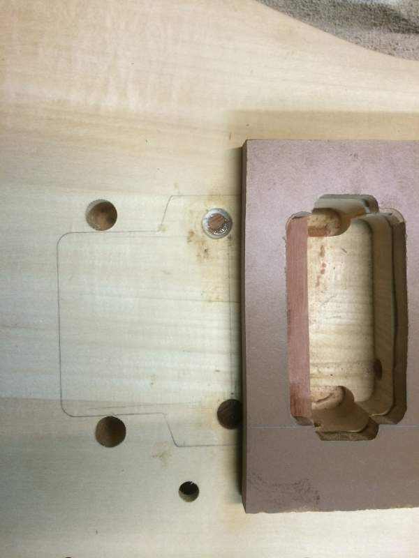

Name:	6 pickup cavity finished.jpg
    filler finished
    next thing was to do was to outline the new pickup cavity.
Name:	7 pickup cavity template.jpg
    pickup tmplate in place

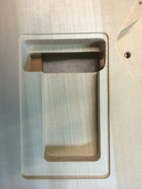

Name:	10 finished bridge cavity front.jpg
    finished bridge cavity at the front

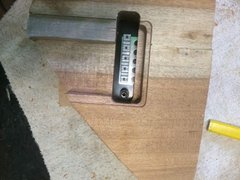

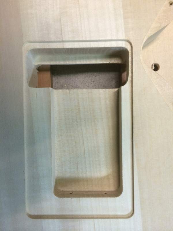

Name:	11 finished bridge cavity back.jpg
    finished bridge cavity at the back

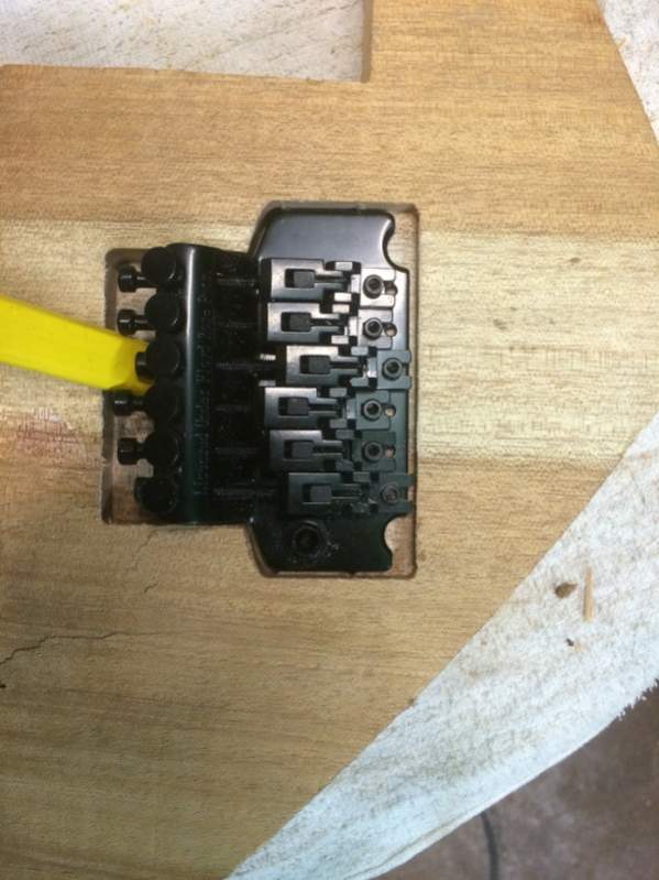

Name:	12 bridge in place front.jpg
    bridge installed front
Name:	13 bridge in place back.jpg
    bridge installed back.
    so this is it so far. unfortunately i forgot to take photos while the new pickup cavity was being cut but all the same im pretty happy with the job this guy has done and all for under $100 (think it cost me $90 for everything he did). dont forget to scroll back through my lasat 3 posts to see my progress
