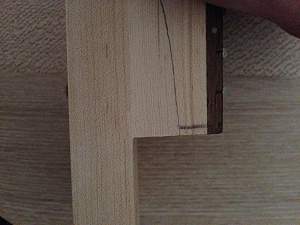

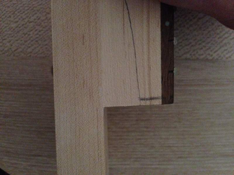

    right so I've sanded absolutely everything back to 400 and now I'm looking to make the necessary adjustments to the scale length.
    First off, I've remeasured and at the moment it looks like it is 312mm from nut to 12th and 321mm from 12th to bridge on the low e saddle wound all the way forward with the neck pickup in, with the neck pickup out the measurement sits at about 318mm and I did some measuring on the pocket and neck heel and it looks like taking about 2mm off the neck will allow the heel to reach the back of the pocket
    My question is, which part to take out, either the top part which is actually hitting the pickup surround and stopping the heel from making contact as pencilled in here:
    (it's just that little rectangle and the pencil is a rough approximation)
    or, should I file that entire face back so its uniform and a bit simpler and leaves a bit more space in the cavity?
    Thanks for your input this obviously isn't something I want to rush into which is complicated by the fact that the only files I've found around the place so far seem to be large bastard files which I don't want to put anywhere near my guitar
  8. #68
    Hey Willem,
    you need to use the measurement with the neck pup in place. You need to take off about 6mm perpendicular to the fingerboard (toward the 22nd fret) and more than likely take off enough of the heel so the new face of the fingerboard sits flush with the neck pup and ideally you want a 12th to saddle measurement of about 315/316mm should give you intonation.
    Here's a pic of the offset of my 22nd fret, I had to take a bit of meat off mine.
    If your not sure about this I can help you bandsaw the meat off, thats what I did very late in the build so at least you haven't started the painting

  9. #69
    sound like a plan wokka I might have to take you up on that but I'll see what I can do myself I've got my dads birthday this weekend and school starts next week so I'm probably going to be a bit busy
  10. #70
    no worries Willem, don't bother doing any more sanding as it may get some small scratches on the side of the neck putting it through the bandsaw on the side but shouldn't be much damage. THis should have been the first thing to sort out.
    I never found out till the gluing the neck stage and the neck was all finished
