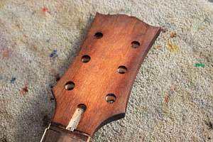

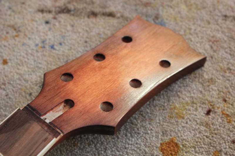

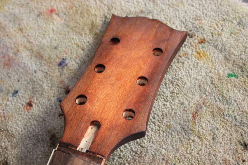

    Today I got to spend a little of Boxing day on the build. That meant finally getting to sand and colour the neck and headstock. I used the same colour combination as on the body of the guitar - although the neck has taken the colour differently and ended up much more darker and redder. I still think it will work well in any case, even with a darker neck. I also attempted a small burst on the headstock. Not as good as the body but it's ok. If I decide it isn't good enough then I can always spray back over it later on . Anway here's how the headstock and neck looks with the soak coat of TO applied.

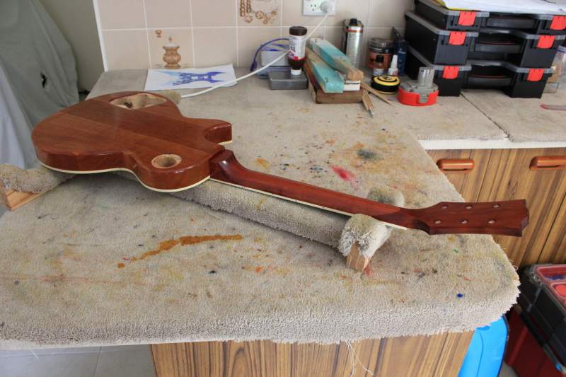

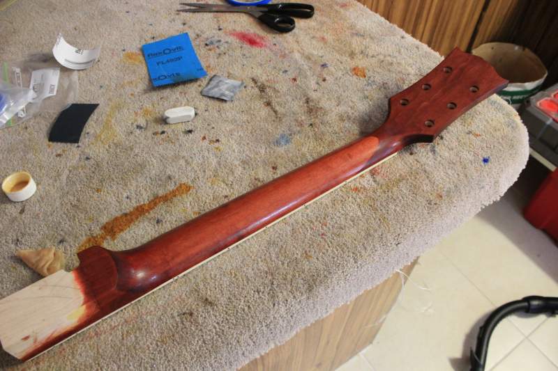

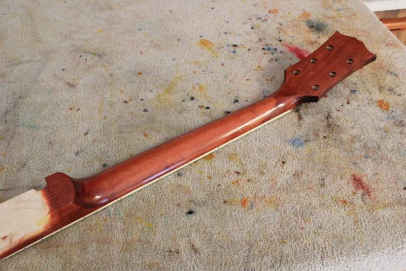

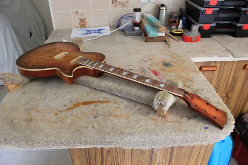

    Thanks @Stan. I think I'll go with the cream as I've never gone this way before. Over the last few days I've been slowly building up he TO on the neck and headstock. I've got about 8 coats on there at the moment and have wet-sanded once with 600 grit. Will slowly be working my way through the grits to 1500.
    The colour is a little darker then the body colour, but it's growing on me. I've also come around to the headstock burst - I think I'll keep it as-is.

    A few more coats of TO and I'll be able to set the neck. I'm still waiting for my new pickups rings from Realtone, as well as a couple of electronics upgrades. In no time I'll be getting this baby assembled .
