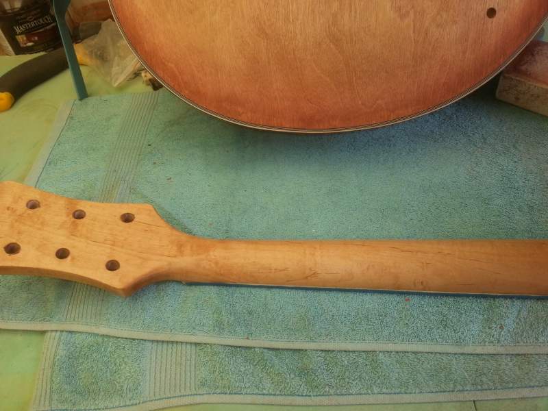

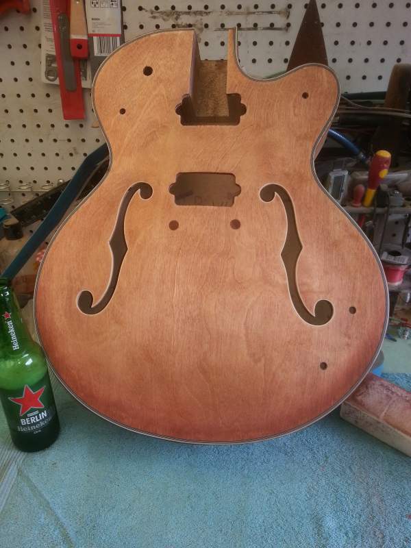

    Nope she's still not white. put in a lot of hours bringing up a suble burst on the tail edge to hide the glue overrun, and even if I have to say so myself I think it's coming along real fine.
    Now the reson for doing this is two part. No one else has seen this yet but the neck has a nice subtle burl in the maple. and It would be a shame to hide that too.
    Cheers PK

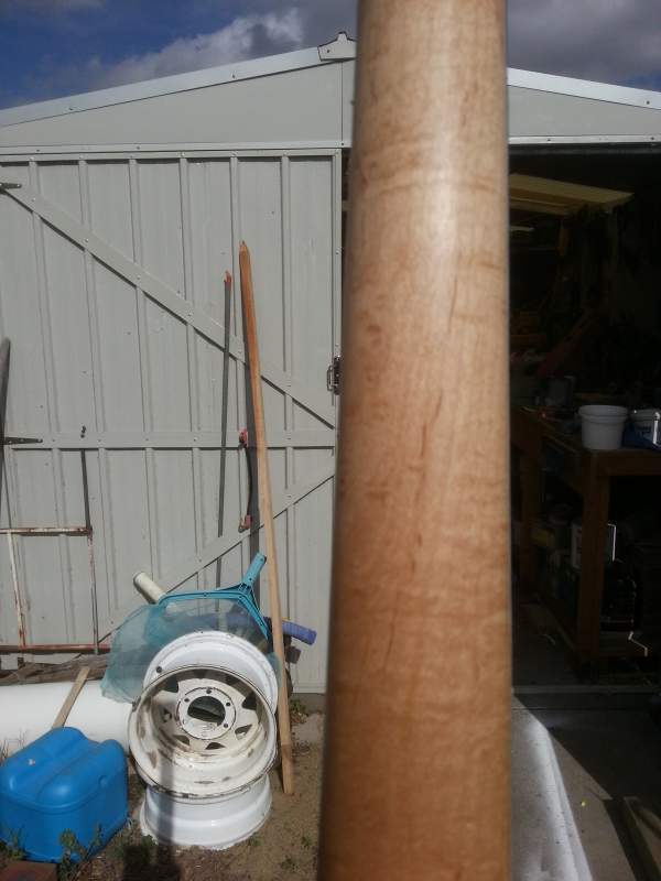

    Sublte burl in maple neck
    Not sure if it came out as well as it does to the naked eye.

    nice one PK, what is the stain colour you used ? Some nice grain indeed. Might as well not hide the grain
  6. #66
    Mentor kells80aus's Avatar
    Jan 2014
    Wyndham Vale, Vic
    775
    The First colour is in the filler Stain, U-Beaut colour. mixed with timbermate. 1 part Black to 4 parts cedar. applied all over including the neck. then rubbed back.
    Then it has been Tung oiled(oops NR). the burst area has been rubbed back as far as possible as it has a glue filled grain. I've applied several layers of filler. after that the area is rubbed back a bit and U-Beaut colour Cedar applied Neat to the area then wiped back with a wet rag, as the U-Beaut Colour is water based. I did this a few times to build up a tapered burst aver the area.
    I know I am mixing water and oil based colours here but need to get the penetration into the grain first.
    Cheers PK
