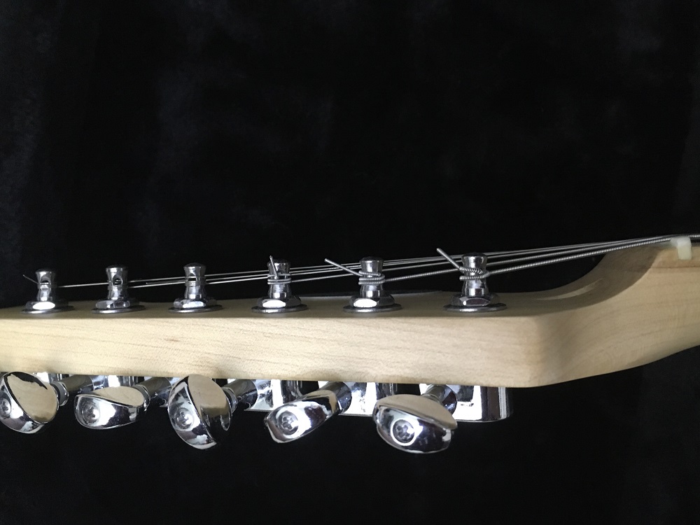

    This works fine with no trees:

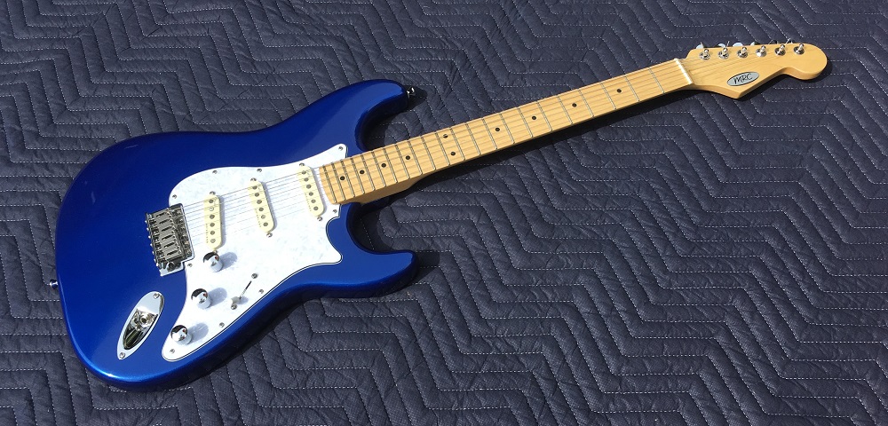

    This is just a shameless exhibition of said guitar!

    Nice Mc - I like the unconventional scratch plate and the chrome knobs!
    I like the look of the triple tree - Amazon seem to sell them too.
