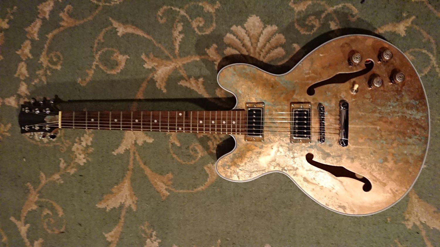

    Was going to take a few better photos tonight or tomorrow as I had too many out of focus ones last night. Once I have the photos i'm happy with i'll post in the gallery and send it in for February GOTM. Here are a couple of 'soft focus' shots lol
ID:	33151   Click image for larger version.

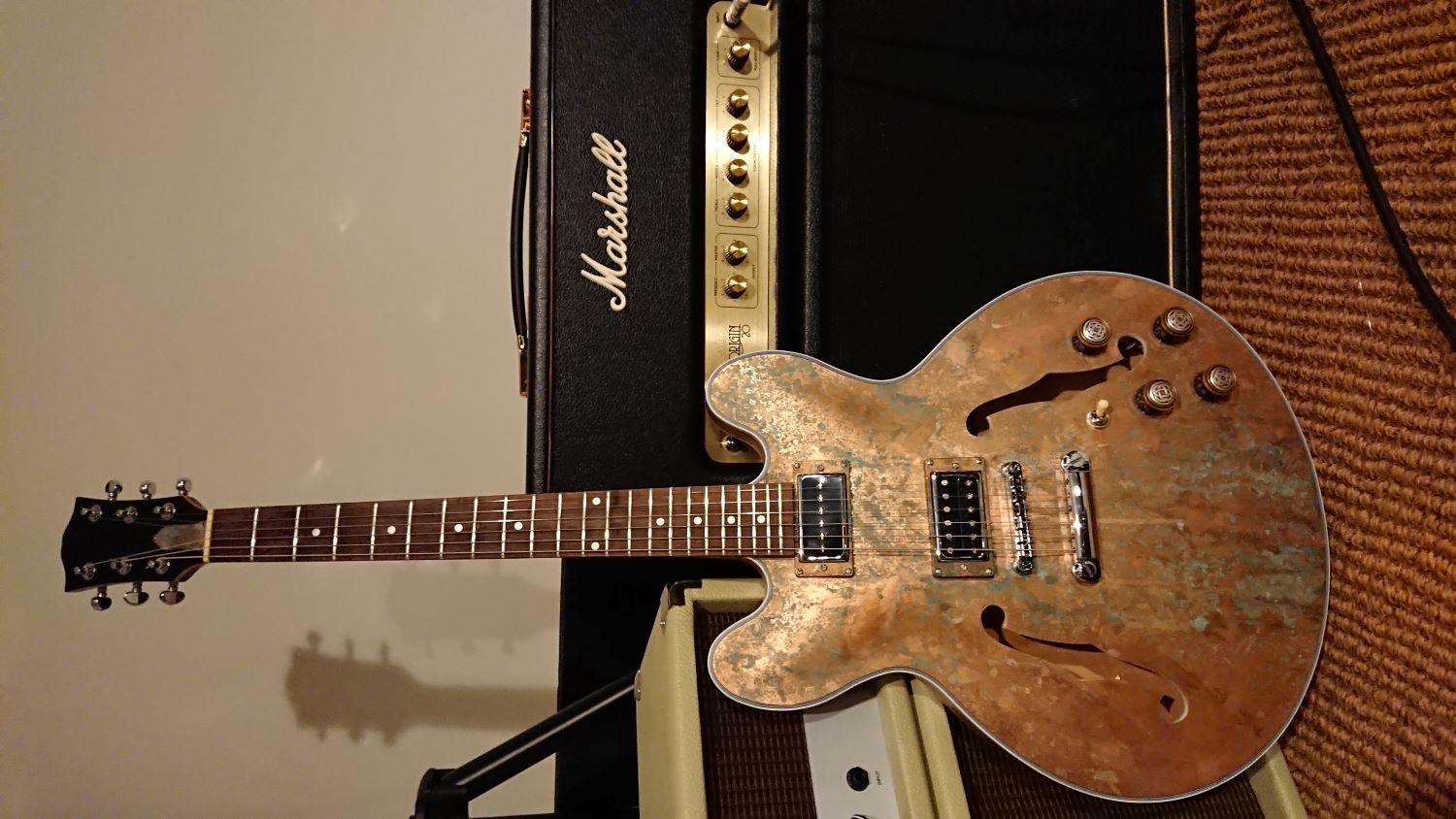

    And upright with the amps

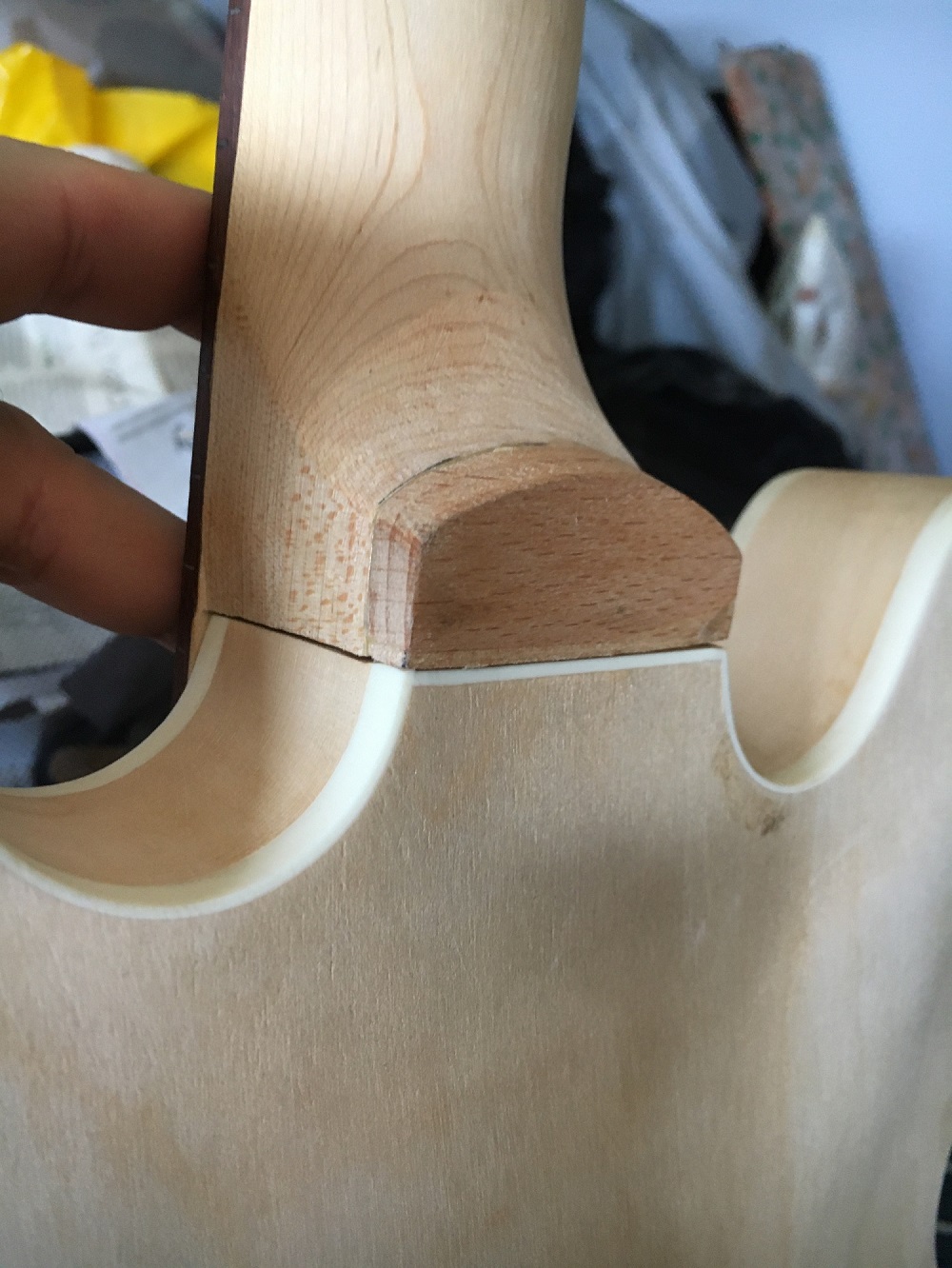

    I've just Re-Started my modified ES1 build [Re Routed for Kinman P90's- had to take 5mm off the thickness of the neck tongue because the V 2 Kinman P90's pickup's are deeper than Humbuckers....New V3 Kinman P90's are slimmer so won't need that mod]
    I also extended the neck heel so it extends over the body binding, like it does on my Gibson ES 347 [more comfortable as well]

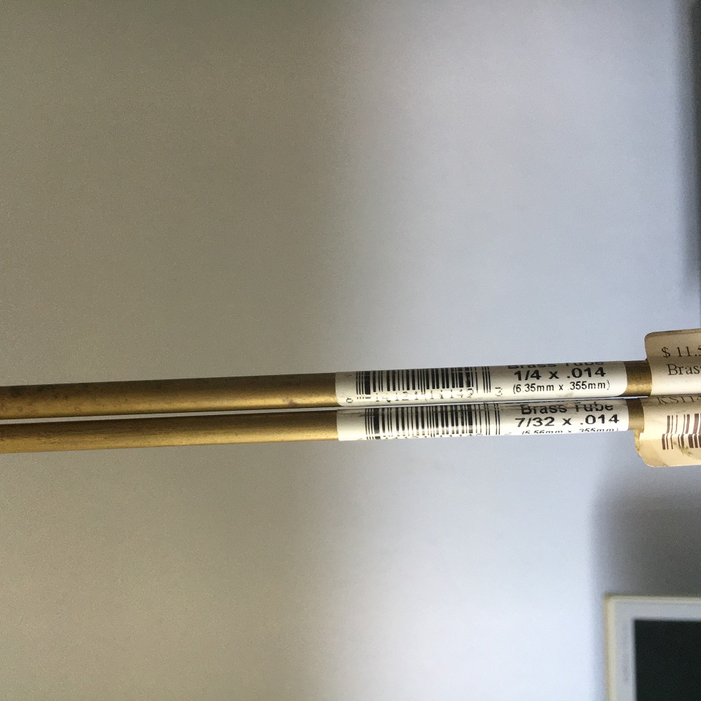

    To do it you need two lengths of Brass tube, easily bought online from hobby shops.
    Outer diameter one should be 6.35mm, inner diameter one should be 5.56mm, get Brass wood screws that have a head slightly larger than 6.35mm [pretty much stock size that is easy to find] that will hold the two brass rod assemblies together once screwed down.
    You just cut the tube lengths to the required length, place them appropriately, and just screw them down....I small amount of lubricant like WD40 sprayed between the brass tube might help things, but TBH I doubt it would be needed.
