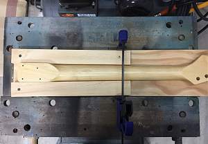

    I made a similar jig...the only difference on my jig is I have 2nd piece of timber mounted to the bottom board that pivots and "clamps" from both side of the fretboard.
    I'd like to see that. Makes me wonder if there shouldn't be a "jig" thread. I am guessing there is some pretty ingenious stuff--like the jig you just mentioned--that most of us have not seen before.
    It's nothing flash, but it's worked for me. I had some MIC strat necks that were about 2mm thicker than genuine "F" necks, but the neck pockets on the bodies were correct depth, so rather than routing the pockets deeper, I chose to plane the neck heels down.
    Here is the jig:
Name:	neck heel jig.JPG
    The whole thing can be clamped to the drill press table when drilling, or slid across the table when using the Safe-T-Planer.
    The neck in the jig is already planed, drilled, finished, and fret levelled. Ready to go into the body in my other thread.
    I just put it in the jig to demonstrate.

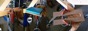

    I don't have enough time or patience to make a good looking jig. I don't have enough skill to go without one. So my favorite kind of jig is one I can cobble together quickly using "found objects" in my garage. Case in point is this monstrosity that I just threw together to mod a pickguard. It's made of a piece of old light fixture, a part of circle cutting jig from my router, and some boards my kids broke in Taekwondo, and a few clamps. Ugly as sin, but it works and took about 15 minutes to make
