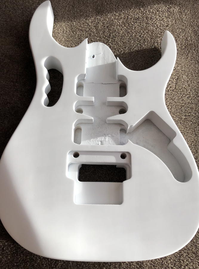

  10. #60
    NEED HELP / ADVICE!
    Whilst my headstock isn't ready yet, my body was ready for wet sanding! So i started the process very slowly given its my first time, and sanded the entire body with 800 grit. It worked really well. I left the edges as i was worried about the amount of clear coat that was on there.
    Next i sanded the entire body with 1500 grit and again it worked well....EXCEPT for one tiny spot where i sanded through the clear, white and into the base!
    I then did the entire body, including monkey grip and edges with 2000 grit but left the spot where i sanded through. At the end i had a really good result and its ready for a cut and polish, with the exception of that one tiny annoying spot!
    I really don't want to start over as the rest of the body had no sand through issues and came up well, and i'm not sure how to best save this...i'm sure there is a way and just need some advice.
    I've include sand through and general body pics.
ID:	30044   Click image for larger version.
Name:	Sanded Body 1.png
ID:	30045   Click image for larger version.
Name:	Sanded Body 2.png
