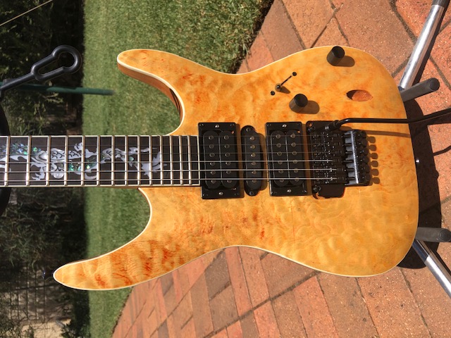

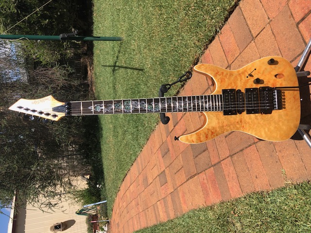

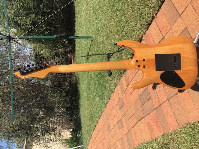

    Finally finished
    Except for the hassles with the Dingotone it came together quite well

    I like it a lot. Not as dramatic as the original intended colour but beautiful all the same. Well done!

    Looks great! Sucks that the Dingotone was a pain in the arse to work with, but you've done well to keep that veneer intact and get a beautiful end result. I actually really dig the strawberry blonde look.

    A few days after I finished the build I noticed the neck pocket wasn't centred correctly, so in frustration I put it in the rack with the rest of the guitars.
    Now I'm thinking it can be fixed by taking the side out of neck pocket to move it across to centre it & shim the other side.
    Question is : The screw holes in the neck will need to be re-drilled & as I'm only moving the neck across about 1mm I will need to fill the existing holes with something.
    I'm thinking an epoxy resin or filler.
    Has anyone done this? or Has anyone got any suggestions?
    Cheers
    Ron
