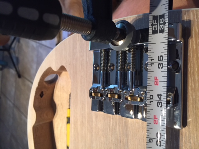

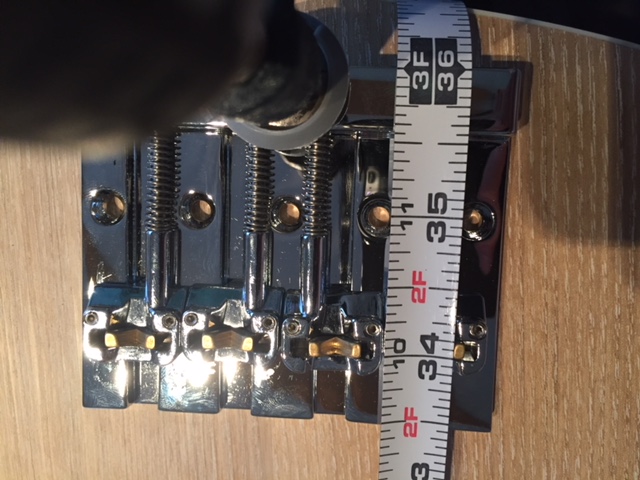

    Got some parts in today and I want to get the bridge holes drilled before I start staining. I measured from the fretboard side of the nut to my saddles, or at least within their range of adjustment. Does this look right?
  8. #58
    Yeah, looks good.
    Usually 34" to treble side saddle on the G string as the thicker ones will need to have room to be wound back a bit when doing intonation.
