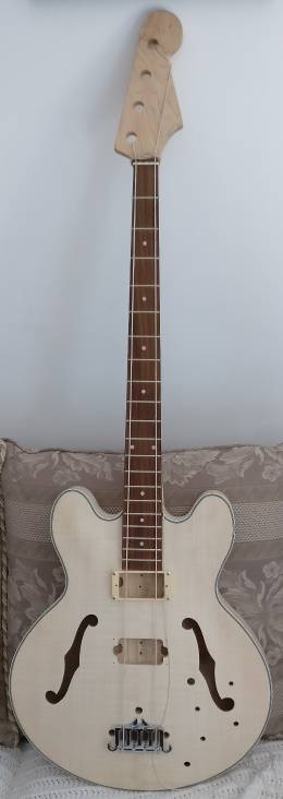

    Not a great pic, but it's beginning to look like a bass. I need to cut a nut and do a setup to see if I have the neck shimmed right. It's close but I won't be sure until I adjust the truss rod. Between the neck angle, the neck height, and the arch it has been a b***ch.
    The center block is also super narrow. And the "south" bridge post broke through just as with my ES4-B kit. Making the center block 2cm wider would solve a lot of problems. I don't even think it would add much to the weight since toe wood is so light.
    I glued a piece of wood in through the f-hole (just as I did with the other kit. I think it helped, but the main saving grace is making it string-through. That way the strings push down on the bridge rather than trying to pull it out.
    Not set up. Not convinced I have the neck angle right. Temporary nut. No string tree and just an old set of ancient flatwounds I had lying around. But it played it's first notes tonight. Click image for larger version.

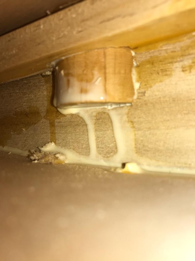

    Here's a pic of the inside taken through the F-hole:
    In placing the original three point bridge, I had already broken out the side of the center block. I glued in a piece of wood in a vain attempt to hold the post threaded ferrule in place. It didn't work. When I would try to raise the south side of the bridge, it was just spinning the ferrule in the hole. I needed to get a big piece of wood in there to hold the ferrule solidly. I just could not find a way to do that through the f-hole. I was able to glue a piece of wood in place, but because of the arched top, it was not flush with the top (you can see that in the pic). It was, however, solidly bonded to the center post, so it is helping to hold the rod in place on the south side. you can see the glued piece at the top of the last pic.
    Although this put a big hole in the top, it was actually the least intrusive way I could think of to extend the side of the center block far enough to accommodate the ferrule.

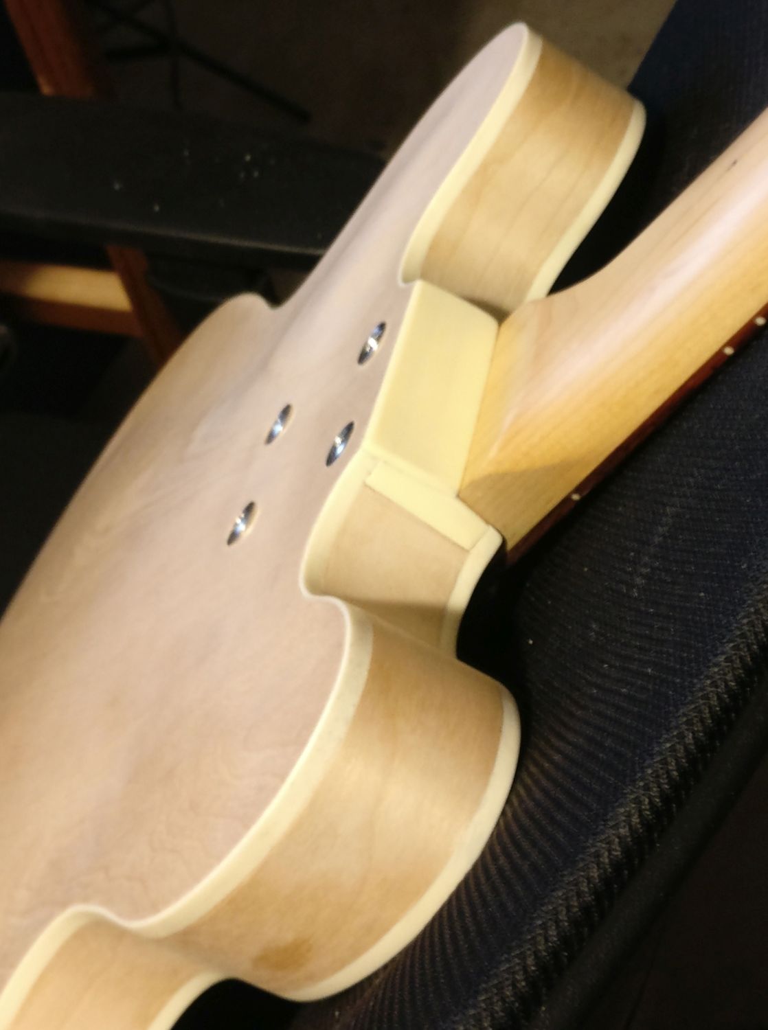

    Made a bit of progress... The neck joint was functional, but not very attractive. This is not perfect, but much better I think. Used binding material on the side of the neck pocket, and to make a cap for the "heel." I am hoping it will allow me to finish the back and sides natural...but we'll see. Finishing is not my best thing.

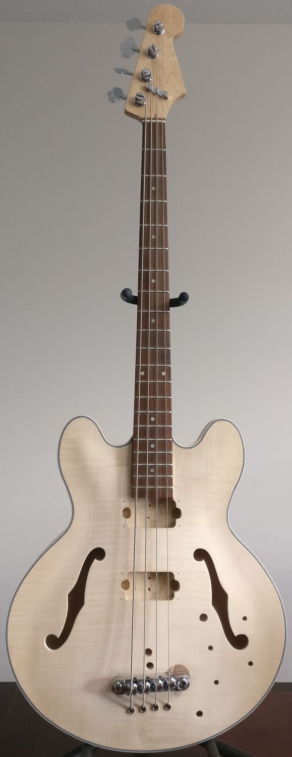

    Got the holes plugged. Got a shot of it next to it's sibling. My ESB-4 has similar patching under the paint...Click image for larger version.
