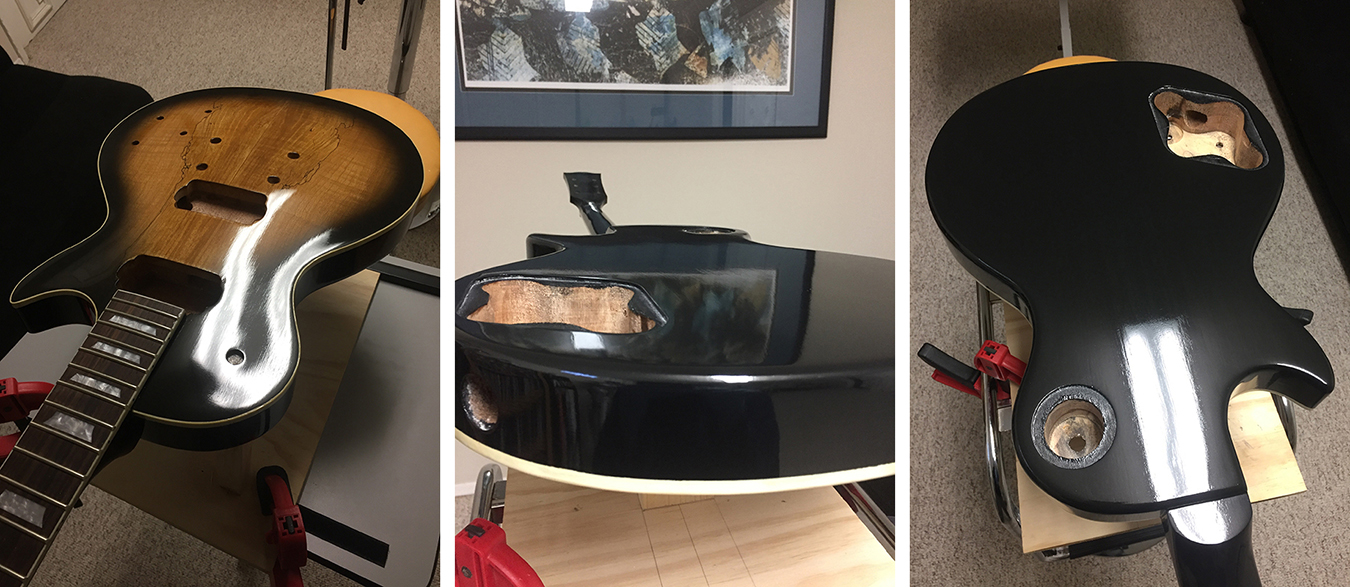

    DECEMBER 2017
    38 coats on the top/32 on the headstock/28 on the back and neck. Wet sanded with 6000 micro mesh
    42 coats on the top/36 on the headstock/32 on the back and neck. Wet sanded with 8000 micro mesh

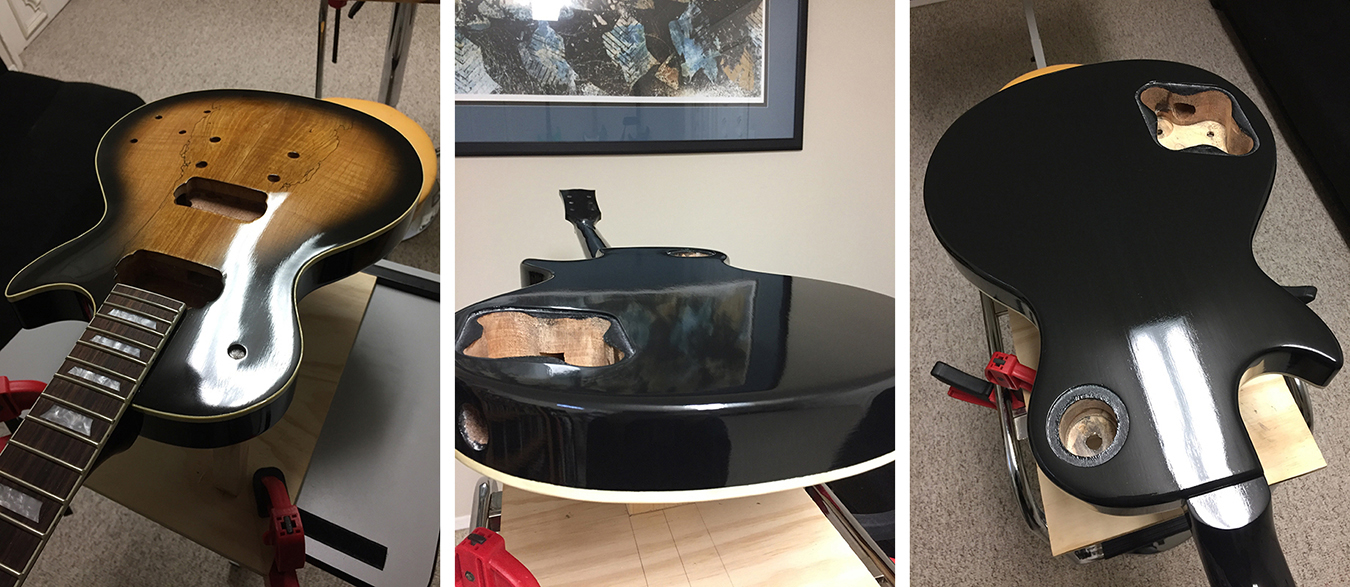

    JANUARY 2018
    44 coats on the top/38 on the headstock/44 on the back and neck. Wet sanded with 12000 micro mesh
    Throughout this process I would occasionally sand through and have to do minor touch-ups. My biggest fear was accidentally sanding too much on the top and hitting the sunburst, but fortunately that never happened

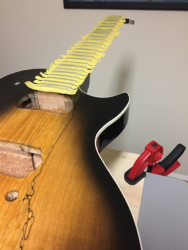

    FEBRUARY 2018
    Once I was happy with the finish I let it cure for four weeks. This eternity was a good opportunity to start learning about how wiring works. After the four weeks had elapsed I polished the guitar with Meguiar's Ultimate Compound.
    Then it was time to tackle levelling the frets, but first I had to remove the old nut. I carefully scored around the base of the nut with an X-Acto knife and gently tapped it off with a hammer. Apparently I scored it too lightly because when I knocked the nut off it took a tiny bit of the binding, some material at the end of the fretboard and some of the finish with it. Darn.
    I glued the small piece of binding back on, filled any divots, stained and applied a more Tru Oil to the affected areas.
    After I overcame that mishap I got back to the task at hand. I don't have a notched straight edge, so I found a dead-straight piece of hard wood and used a router to notch it

    Once the neck was straight I masked off the fretboard, taped some 320 grit sandpaper to the top of my homemade notched straight edge and used it to sand the frets level. Next I crowned the frets with a triangle file then sanded with 320 & 600 grit, and finally polished with 0000 steel wool
