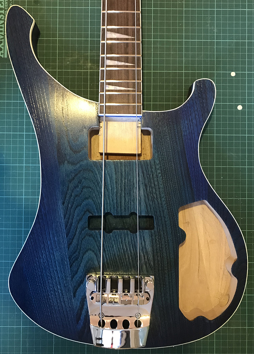

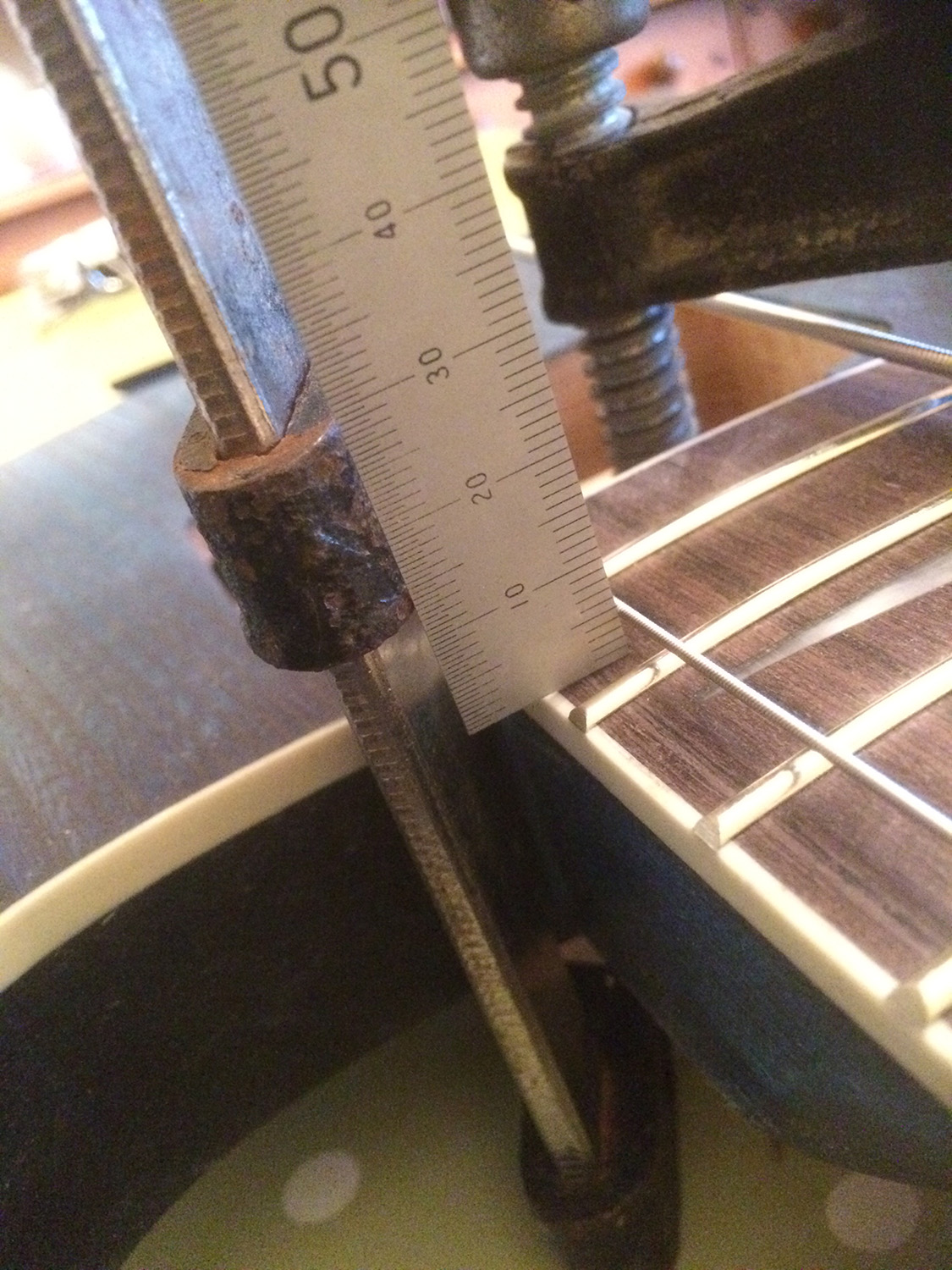

    With the bridge set to its lowest position, the neck clamped in place and strung with proper E and G strings the action seemed very high so I set about making a shim...
    First attempt was cut from a piece of mahogany on my bandsaw... I estimated that something around the 2mm mark at its thickest would be the place to start then sand it down to get the string action about right... the thinnest I managed to cut without breaking was about 4mm at the thick end so it time for a re-think (and I really didn't want to spend too much time on it as I wasn't really sure if it was necessary). So rather than try to reduce something to the correct size I decided to step laminate three pieces of cherry veneer I happened to have, alternating the grain like plywood. I sanded the stepped side smooth and ended up with a shim 1.75mm at the thick end tapering to a wafer-thin 0.25mm. I trimmed it to size leaving the thin end 2-3mm short of the joint line so that it won't be seen and also so that the shim effectively tapers to nothing.

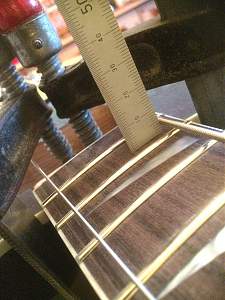

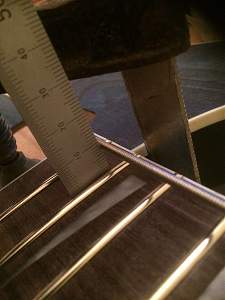

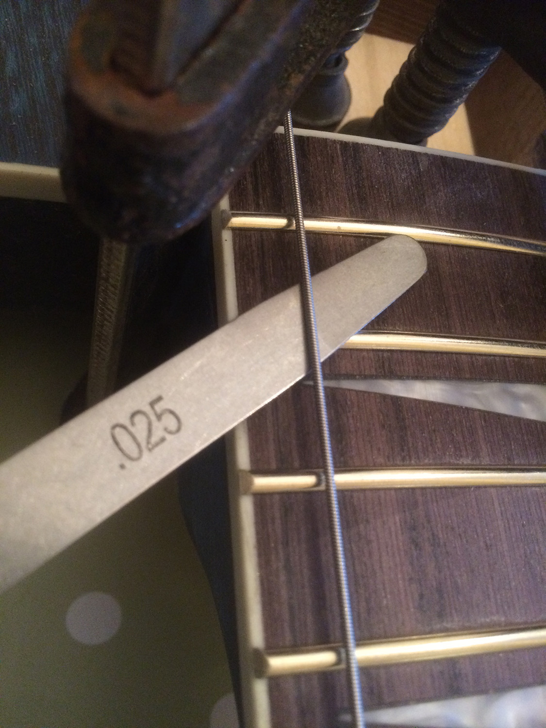

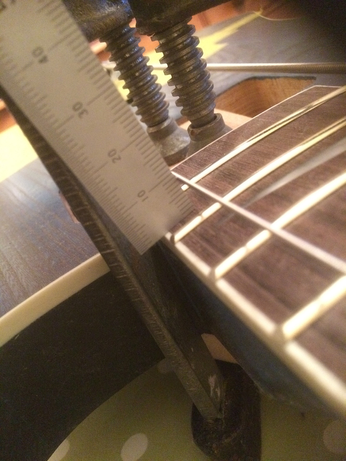

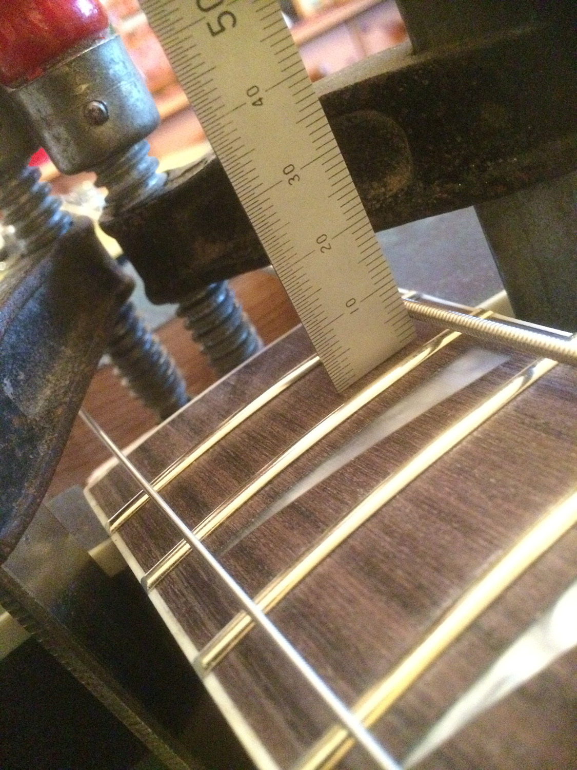

    With the neck and shim clamped in place, I adjusted the bridge so that the bridge could still be lowered a bit then measured the distances at the penultimate fret at the body end (I couldn’t get access to the last fret as my F clamps were in the way). I took measurements with open strings (the nut seems quite high at the moment) and also with a capo strapped accross the twelfth fret:
    Without shim (open 12th)
    E 7mm* 3mm**
    G 7mm* 3mm**
    With shim (open 12th)
    E 1.5mm* 0.635mm (0.025")**
    G 1.5mm* 0.635mm (0.025")**
    * measured approximately with a ruler from the fretboard to the underside of the string
    ** measured with feeler gauges (plus the thickness of the rule when unfretted without shim)

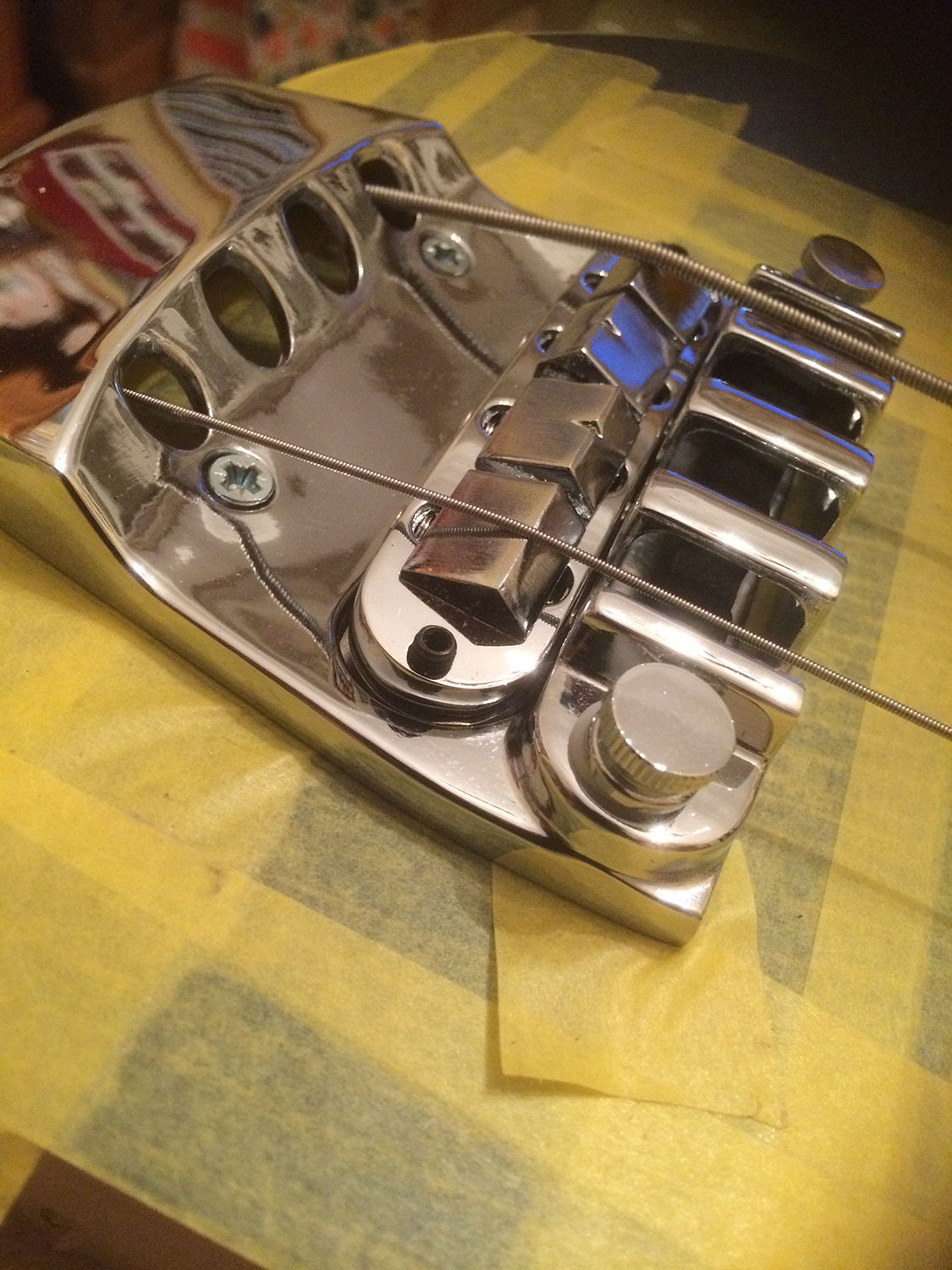

    the bridge...
    I like a low action – as low as possible without rattling the frets unless I really dig in. Using the shim, the string height seems great to me, especially when fretting higher up the neck. There seems plenty of bridge adjustment to raise or lower the strings and I’ll either remove the nut to sand off the bottom or file down the slots at a later stage… but before I get the glue out DOES ANYONE HAVE ANY COMMENTS? as I’d hate to do something foolish here…

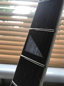

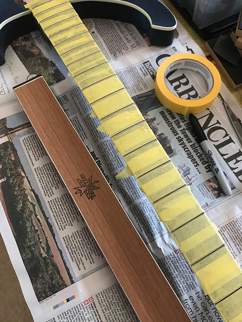

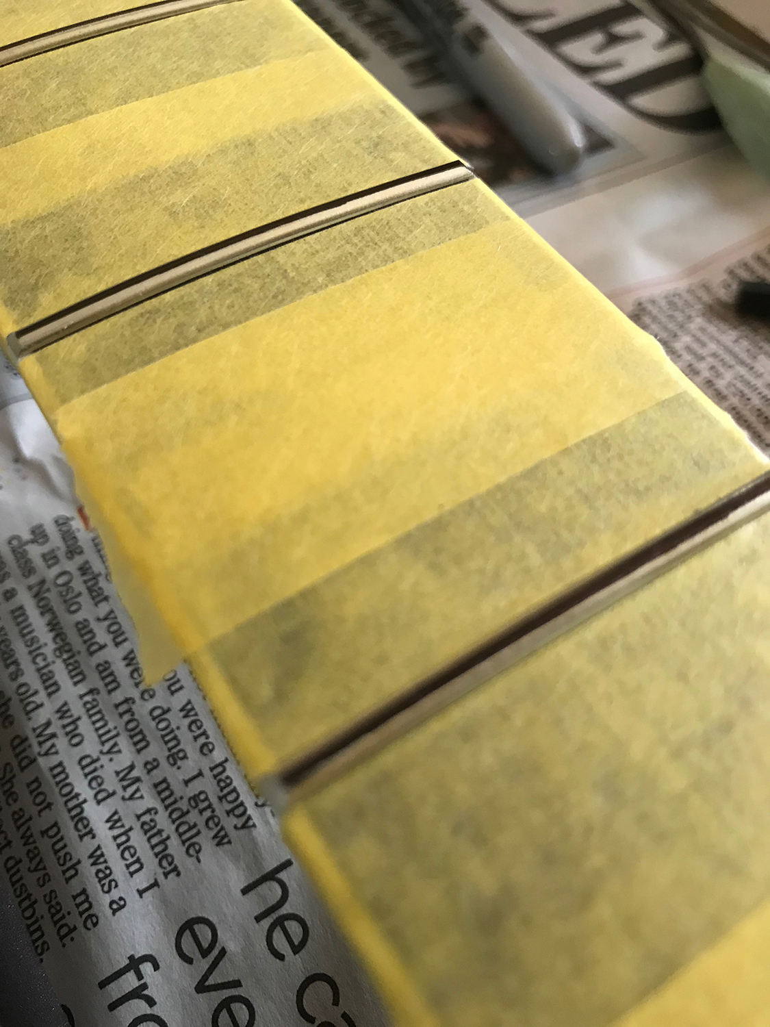

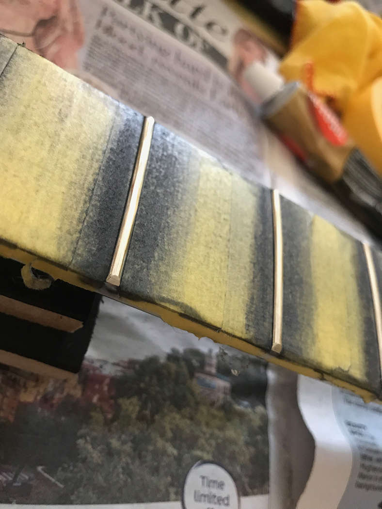

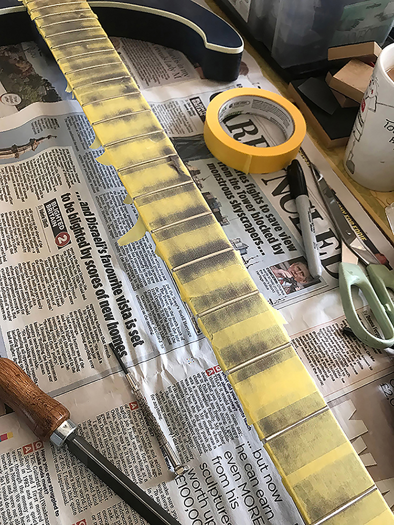

    Next I decided to level and dress the frets before put it all together (I'd later strip it down for another coat or two of oil and then finish off with some renaissance wax).
    Time to tape up and get the sharpie out...
    and level...

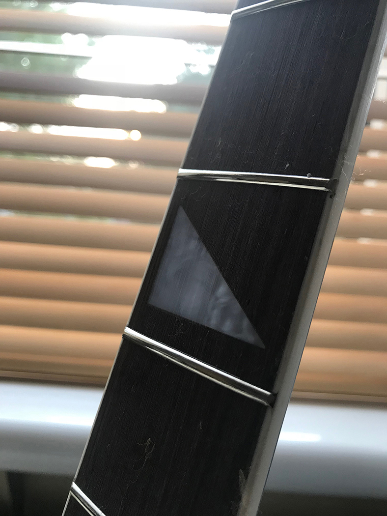

    The neck was pretty good to start with and all frets were nicely levelled after only a few passes of the fret levelling beam. Time to round over and polish...
    quite therapeutic!
ID:	28710   Click image for larger version.
ID:	28711   Click image for larger version.

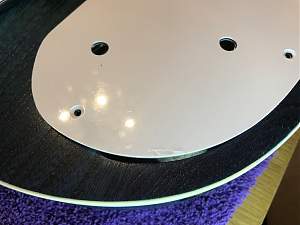

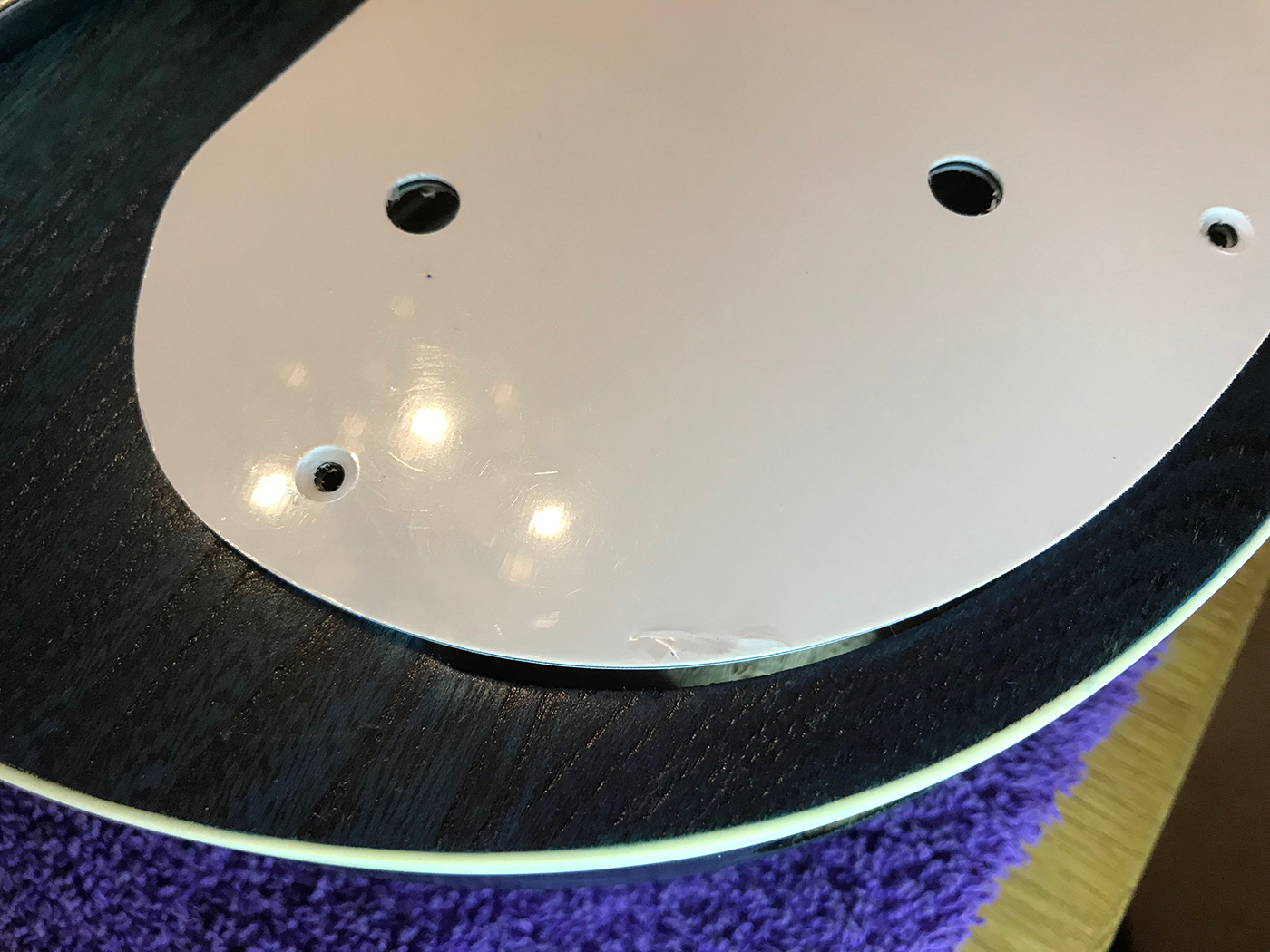

    So time to assemble the rest. I put the scrathplate on and realise it doesn't fit!!

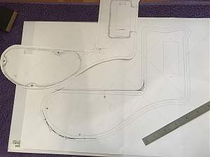

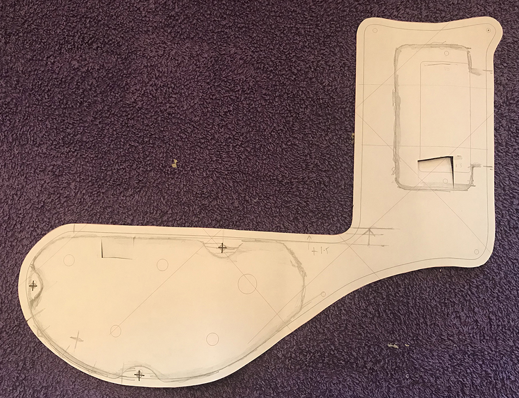

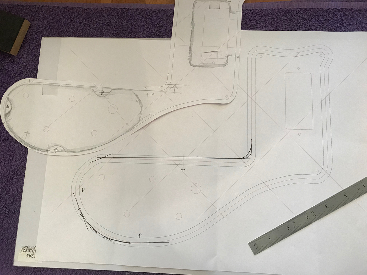

    It would have fitted perfectly if the neck was fully inserted into the pocket. BEWARE! So off to order some scrathplate material and start drawing...

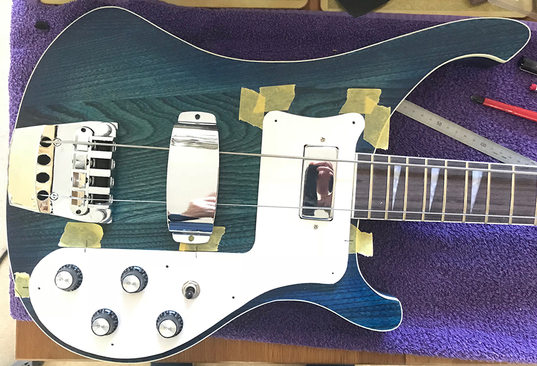

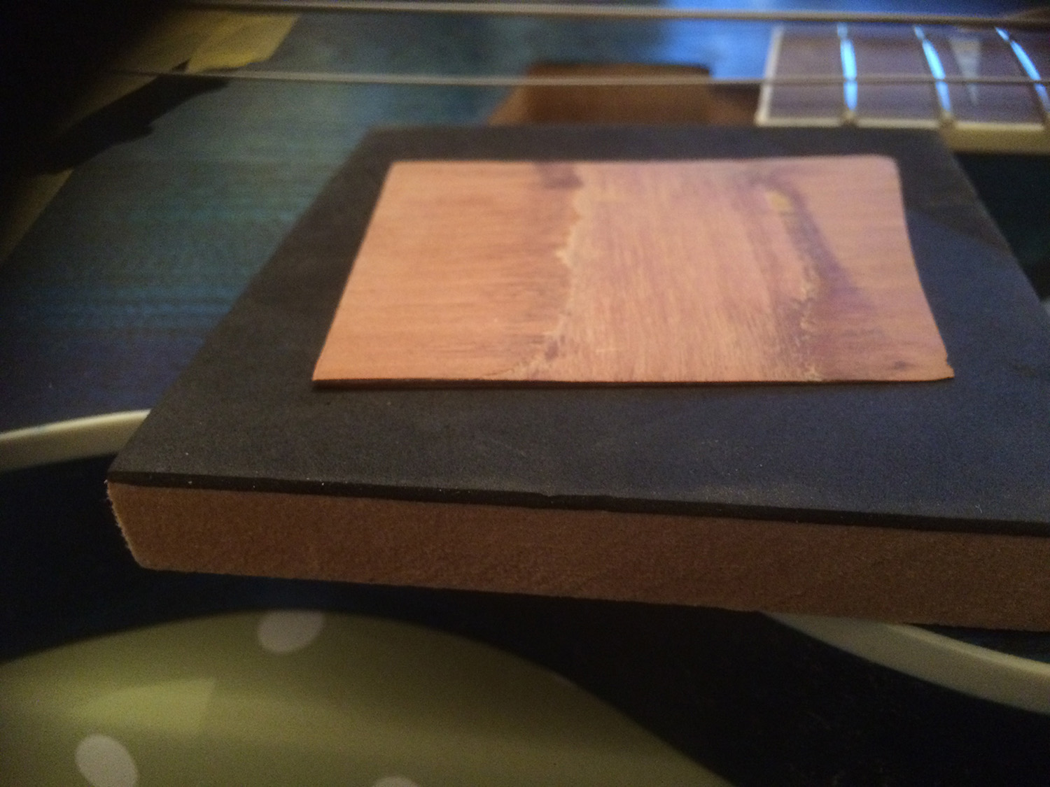

    I took the opportunity to make the bottom edge of the scratch plate parallel to the edge of the guitar. Even genuine Rics don't and this bothers me...! I also adjusted the long horizontal edge to align better with the strings. I cut a dummy from foamex and loaded the controls...
    I may reconsider the pot layout as this is the original pit bull layout differs from a Rics layout... I will ponder this when cutting the scratch plate...
