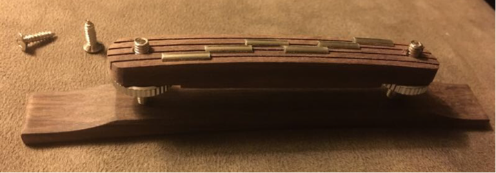

    Bridge assembly.
    Hi folks, I’ve unsuccessful searched how to assemble a floating bridge. Is this correct? Metal threads (hex key side up) screwed down into the wooden base with the string saddle(?) sitting on top of the height adjustment held down by string tension? Regards, Mark.

    Yup, that looks about right mate. Interesting looking bridge.
    With the curved profile on the ES you may want to scope out where it is going to sit, the lay some sand paper there and use it to gently sand the base to get it to sit flush across the body curve.

    Mentor DarkMark's Avatar
    Sep 2017
    1,578
    Thanks FrankenWashie. The bottom of the bridge is already curved at what appears to be an appropriate shape. Good sanding tip, I’ll use it if required.
