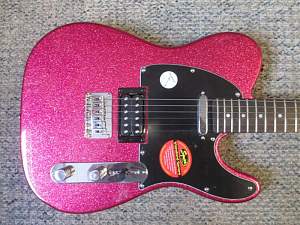

  5. #55
    I would donate for the paint to see that happen! Hot pink telestrat!
  6. #56
    Jun 2016
    Mount Gambier Australia
    1,171
    Thanks NB, you are right of course. Hot pink it is then.
    i could live with that...

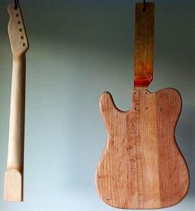

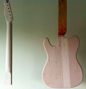

    Hi Andy, You will need lots & lots of tea to get any colour showing up as stain on a maple neck.
    I used very strong concentration of Tea that was left to brew for a week on the Swampcaster (Build #5) and thank goodness I had the rust solution for it to react with because on its own there was not much happening. Coffee seems to work better on its own.
    As always, testing on scrap timber is recommended, and please remember to gamble responsibly!
    Cheers, Waz

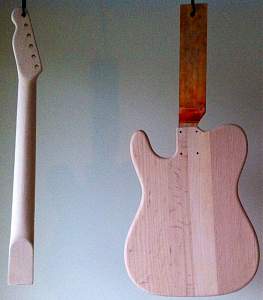

    Hi Andy, I have dug up some before & after shots before adding the rust stain solution that hopefully give you some idea of how much stain effect Tea might have.....
    Name:  Back - before Tea.jpg
    This was before...
    Name:  Back - after (wet).jpg
    After whilst still wet....
    Name:  Dry Tea shots - 24 hrs later.jpg
    24 hours later once fully dried.
    Hope this helps in some way.
    Cheers, Waz
